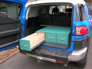

I made this out of 1/2" baltic birch plywood. The full extension drawer guides make it completely usefull. There is a open eye hook in the center, and its held down in the back ( to prevent tipping forward when opened) by a ratchet ty-down.
And true to our "Yankee Inginuity" I used a mix of my and the neighbors old porch paint to finish it. Ugly greenish/blue/grey. Maybe when i paint my porch, I will re-do it.

you guys are making my talents look bad:D

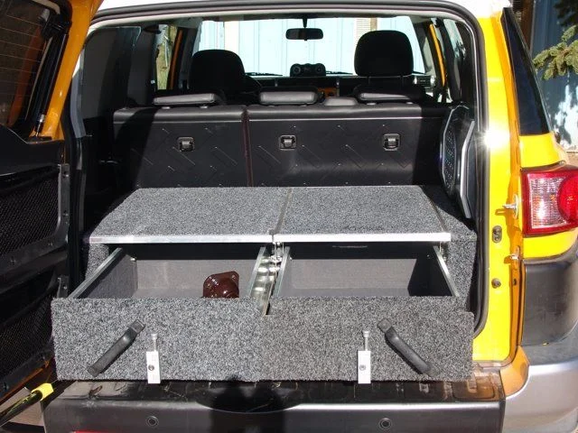

Here is a African Outback drawer from Sleeoffroad-
Just an FYI on this drawer system. I went into Sleeoffroad and talked to them about this drawer. Most all of us know that is was custom made for the Ultimate FJ and they don't currently sell a model for the FJC. Slee told me that is was a Land Rover model (I think) they just cut down to fit the FJ. They would also provide pictures of how they did it. Some metal,wood, an plastic to cut. The only 2 possible bad issues are drilling though the floor to bolt it down and cutting the inside plastic fender below the sub for a support brace to fit. The price was around $1,100 .
The Slee box is nice.
As popular as the FJ is now, I would like to see the box produced.
