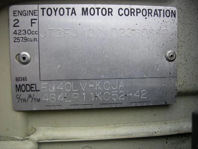

Data plate on the pax side firewall says:
BJ42LV-KOJK
464LP11K082H42
I know the info is there, but I left my laptop at the office(NSA), so I am gonna be kinda slow at cipherin' and figgerin'.

K082
This is your axle code.
4.11 open diff.
DATA FROM HERE
More info on data plates here
Here is a pic of a data plate of a 12/82-40 that is currently at the shop:
