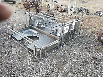

There is a tub for sale on eBay in New Mexico (not mine). Check it!
