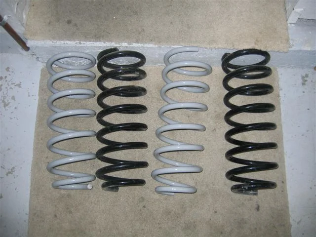

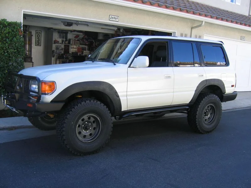

Just got the some of the new Frankie's Off Road springs installed and love the result. I am replacing OME heavies 850/863 with an additional 25 mm of packers in the front. I have an ARB with 9.5 Mile Marker winch in front, Hanna's and factory rear with reciever. No other significant weight on the truck. Measurements before and after came out to exactly 1 1/4" higher in the front both sides, and 3/8" on Passenger rear and 5/8" on Driver rear. The OME's were well broken in with some good trail miles on them over the last year. The after measurements are after a drive around town for the initial settling in but they have not been wheeled yet. Still have the OME shocks N73/N74e front and rear.
The ride is similar but slightly less harsh. They are firm and very controlled but lack the sharpness of the initial hit on a reasonable road bump or driveway. I am very pleased with the new stance as I can't stand the stinkbug look. I also did a quick load of stuff in the back to approx 200 lbs and only saw maybe a 1/16" of compression. Obviously I tried to duplicate as best as I could but measuring with the eyes is imperfect.
The upper end of all the springs is lacking the "flattened" style of the OME's but it does not seem to make a difference. Others more knowlegeable about springs feel free to correct or mock me. :D The diameter of the coil and length on the floor is about the same but the ride height and load carrying ability of the Frankie's is much better. Initial tests only of course.
The first pic is the fronts for comparison with the Drivers side of both on the right. The Frankie's USDS is a little longer.

Next is the before with OME heavies and 25mm front.
Second is Frankie's with no spacers front or rear.

interesting. so with less coils on the springs you are finding they are firmer? that is surprising to me.
In this case the increase in firmness is due to the increased pitch in the coil turns. Each revolution of the wire/rod is technically referred to as a turn. Firmness of a spring is affected by carbon content/material, wire gauge, heat tempering/stress relieving, and the pitch (angle) of each turn in the coil spring.
All else equal, if two coils are the same unloaded height and use the same gauge of wire but one has less turns, then the one with less turns will have less material used in its contruction. It will also have a higher pitch and will be firmer.
When pitch is increased to increase firmness it's important that other characteristics of the coil are changed as well in order to preserve longevity. Typically the two characteristics that are adjusted to accomodate the higher pitch are either wire gauge and/or carbon content. Don't know which has been addressed in the FOR product.

thanks moj, I had no idea pitch played a role. surely though there is at some point a diminishing benefit from increasing pitch and reducing the number of turns in terms of reliable consistent compression. i would have thought that having more coil turns meant that, assuming the same intended stiffness/overall compression from a given amount of force, this compression could could be achieved with less compression per turn which would yield a more controlled overall compression and would put less stress on the metals.
incidentily, don't lx450 springs have fewer turns? I would have thought they were made to be softer.
One thing to keep in mind is these springs are designed around a suspension that has less up travel than OME...in other words, less required spring compression. I can't say whether this factored into the design, but it is my understanding that if you reduce the required compression you can open up different coil designs.

Wow. I can really notice a height change.
Are those 315's?
Yes they are 315's, and I too love the new height.

They are actually about the same firness but the initial hit is slightly less harsh.

Also worth noting the progressive rate of the spring is readily visible once they are installed. The top 1/3 of the coil has less pitch than the bottom 2/3 of the coil front and rear. I tried to take a picture but with the angle needed to see the whole spring they were worthless.
