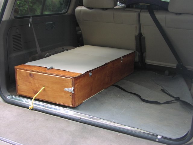

My goal was too create a light weight yet strong storage solution for the rear ½ of the LC. When I say strong I mean strong enough for general camping equipment / with a distributed weight range. (my cooler will sit on the floor next to the box) The primary objective was to build the box to be easily removable so it needed to be light in weight and easily bolted or strapped down. The box needed a hatch On top upfront so it can be accessed with the tail gate closed.
1. I wanted to still use one of the third row seats.
2. It needed to be light weight enough for easy remove and add back.
3. It must securely bolt / strap to the floor
4. It must not make a lot of noise when off road. (no rattling)
5. Second row seats must be able to fold forwards
Dimensions of Box: 20 inches wide by 41 inches length.
The Box height is 6 1/2 inches.
Wood: 8 foot 2 by 6 pine.
8 foot 2 X 4 pine (for draw sides)
2 Ply board ¾ 24 by 24 squares
2 Ply Board 3.4 24 by 4 feet
Other Misc.
2 rolls of rubber drawer liner
2 small hinges
1 bottle of wood glue
1 forgotten candle for wax
1 sheet sand paper
Tools:
  • circular saw
  • Drill
  • Screw driver
  • Brad Nail Gun
  • Staple Gun
Total Cost : less than 50 dollars
Total Hours to build : 9 hours +
Results of the build:

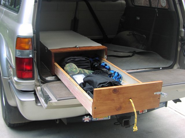

Well the choice to go light weight was good one but posed some problems. This box is not made to take several people standing in the middle on it, but it seems to have a good distributed weight range towards the edges. This will more than meet the need for carrying camping equipment and jumper cables, trailer hitch, lights, ropes, fire extinguisher, etc.. But by using thinner wood you have to take into consideration of where you can place screws and hardware. So I am staying away from any fancy hardware right now and going with rope pulls for handles. I think this will make it easier to meet the no raddled requirement. I am also going with a wax treatment for the slide of the drawer. The only thing I have done a little different than some of the other folks is that I placed two bottom slides on the top of the box to make getting things from the back easier when the tail gate is open. I don’t have to climb in there to get things. The draw can open towards the front from the rear area if the second row seats are folded forward. The biggest is that it is really easy to pick up and move. One major thing is to place the wood gain across the opening not with it for added strength. Also PINE is a light weight wood which needs some protection once built. I went with a shellac stain so I could see the wood gain. Also this box does not weigh enough to cause the truck to lean even when fully loaded.

Nice work! I like your choice of stain color and the poly'd finish. Looks liek it'll hold well and suite your needs.
I really like what you did. It looks very functional. Also looks like there is alot of room for versatility too. You could make a second one to go next to the first. You could make two more and stack 'em. And of course, if you had 4, you could remove any you did not need at a particular time, or to make room for a 3rd row seat. Nice work.
