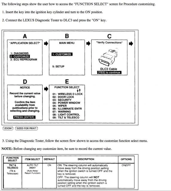

I had the dealer disable the auto feature. I think you need the lexus/toyota hand tool and software to do it.
Yes, Toyota/Lexus handtool needed. At first my dealer said it couldn't be done. I then handed them an instruction sheet on how to use the Toyota hand tool.

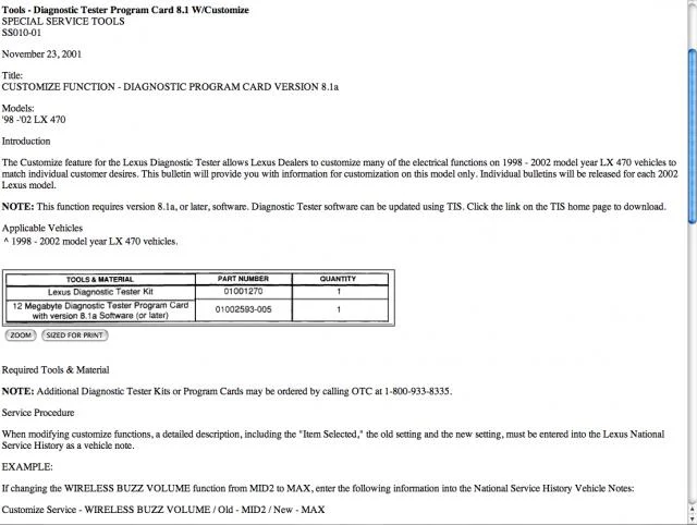

All those interested in the Toyota Scan Tools directions for customizing the '98-'02 LX470, see attachment. The '03+ models are probably done a different way (C-best).

A ha! I knew there would be a way! I'll be getting this done ASAP on my next visit to the friendly Lexus dealer. Thanks!
