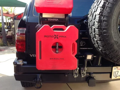

I've always been a little envious of the range of aftermarket products designed for the Jeep JK. So when I saw this table on Off Road Evolution's website, I thought it would be just the right size to mount on my Slee swing out. At $179 I figured it should be pretty stout. Install was easy using the supplied nutserts. Powder coated rough finish looks like it will hold up to the elements.

It does look to be a bit close to the tail gate when the arm is closed. If the bumper or the swingout flexes it might bump the tail gate. I have seen quite a bit of flex when you land the rear bumper hard on a shelf.
Just drilled into the ladder uprights and installed nutserts. The folded table has a little more than 1/2 inch clearance from the plastic emblem on the lift gate. I really don't think there's that much flex to be an issue. I've also mounted a 2 gallon RotoPax to the inside of the ladder and that has not been a problem either. I have to admit that the table is a little heavy at almost 30 lbs. It would really be nice if it was aluminum.
