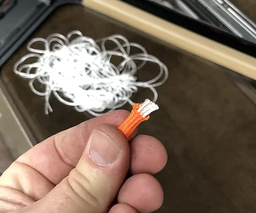

I pulled the filler from the paracord

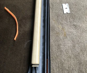

Remove the rubber rope and added paracord

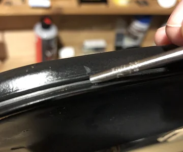

I cleaned out the seal with the smooth side of a 1/8" drill bit

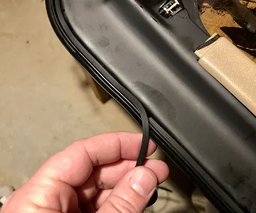

Jammed this .16 screen door rubber rope into the gasket groove

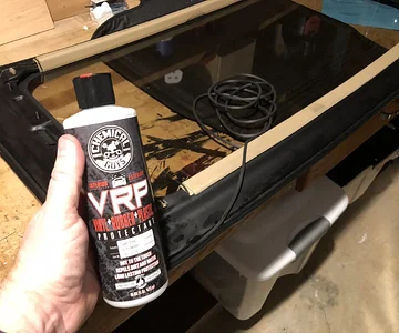

Cleaning the gasket with this stuff.

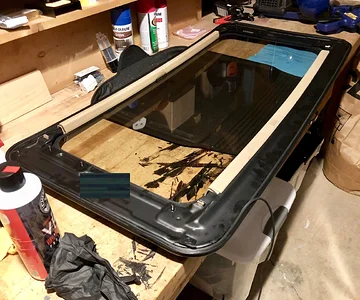

Sunroof out of the vehicle and resting on the workbench
