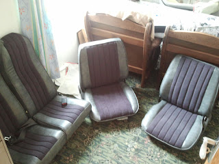

Also, I've updated the blog, I've now got the upholstery finished. The body work is well on too. :pCheck it out!:p

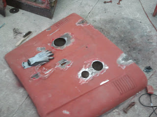

I see those round holes in the bonnet are the result of cutting out rust. And you're hoping that, being round, the distortion will be less when you weld in patches. (I'll be interested to see if this experiment shows that the round patches produce less distortion than rectangular ones.)
Very nice work on the seats, floor pans etc :clap:

thanks lm. yea I think the circular holes will minimise distortion but I'll not be welding until next weekend, so fingers crossed. ;)

Circle, square, rectangle, triangle, rhombus etc. etc. will all distort due to too much heat. If you take your time and use an air gun or at the very least a wet rag after tacs, heat distortion will not be an issue. Cutting out in that way may be a good idea, but it's really not gonna protect you from the metal shrinking or stretching due to incorrectly mig welding in patch panels.
