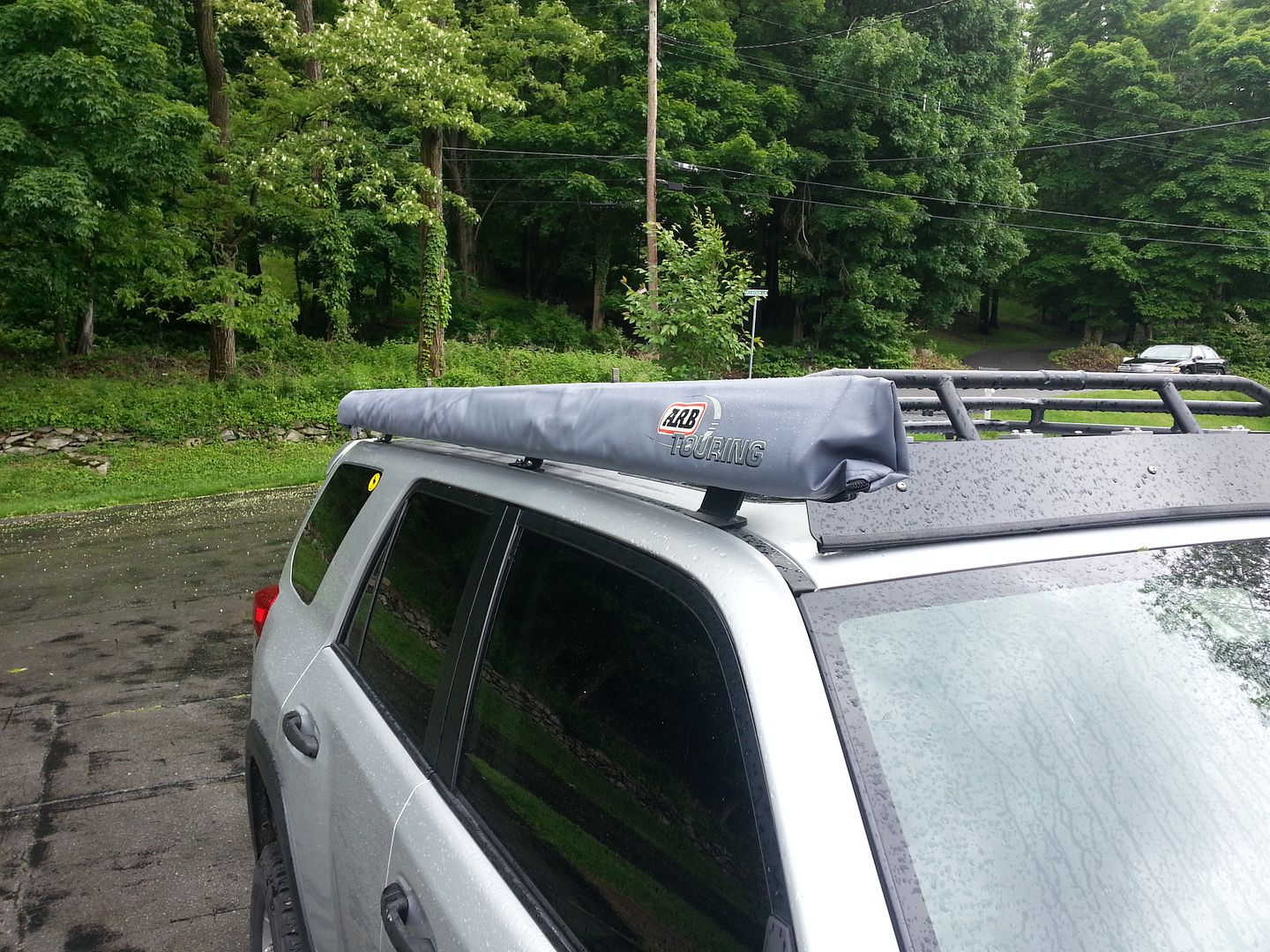

Hi all,
The purpose of this bracket was to carry the awning and Hi Lift together, but not always the same time. I may only use the HL a few times a year, and since this a DD, I need to keep it practical. I'm not sure if I'll keep the awning up all the time, but it doesn't really impact anything, so it's fine where it is I guess.
Of course...you can always buy a bracket, but why do that when you make make itself for twice as much and take three times the time to build it? :rolleyes:
I started with a pc. of 3.5" x 5" x .250 steel. I cut it on an angle, welded it together, welded on 1" shaft collars with wrench flats. As usual my welds sucked, but grinding improves daily...
I cut a pc. of 1/2" SS threaded rod, welded a nut to it, and welded that to the top of the bracket.
Here's the McMasterr Carr link http://www.mcmaster.com/#shaft-clamps/=n9jw1x
I didn't want to have a long pc. of threaded rod sticking up, so I welded up a threaded coupler with a stud, and then a 4 winded knob to tighten down the HiLift. It worked great, and tightened down nicely
Everything fit good...gave her a bestor-testor...and it was awning time
Awning was a piece of cake. When I test fit the brackets, I used a straight edge to lay out the holes, because the Gobi has a slight arc to accommodate the roof
line
and hell..if we have an awning, we probably should have a light under it to party, no? .....why HELL YEA!!
thanks for looking...again, I already know the welds suck...:beer:

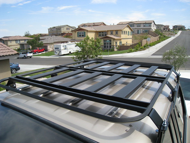

This is the actual rack, taken from their website:
Except my mounts attach to the crossbars, these are further apart. (Where the upright boxes are between the upper and lower bars)
