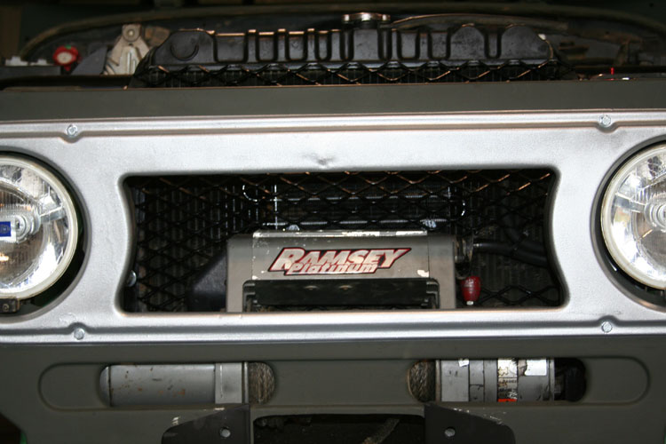

Modified and re-installed the expanded metal radiator guard thingie:

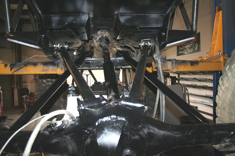

New Rear links built and installed (thanks Nuzzy for the help and for sharing your horrible gas!):

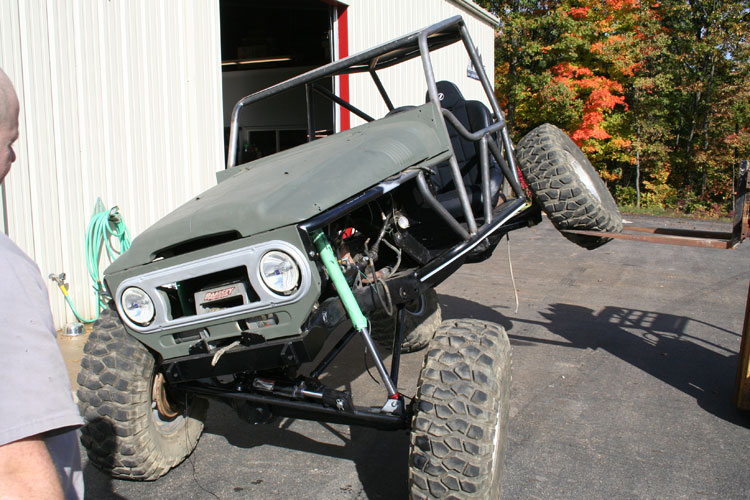

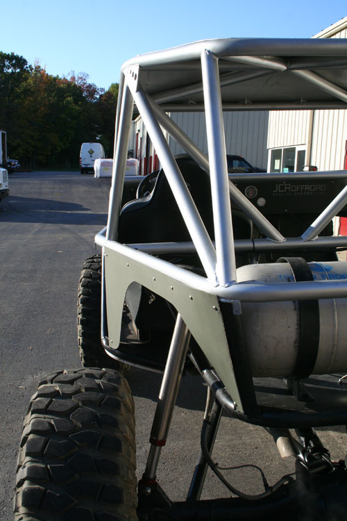

Alright...OUTSIDE PICS!

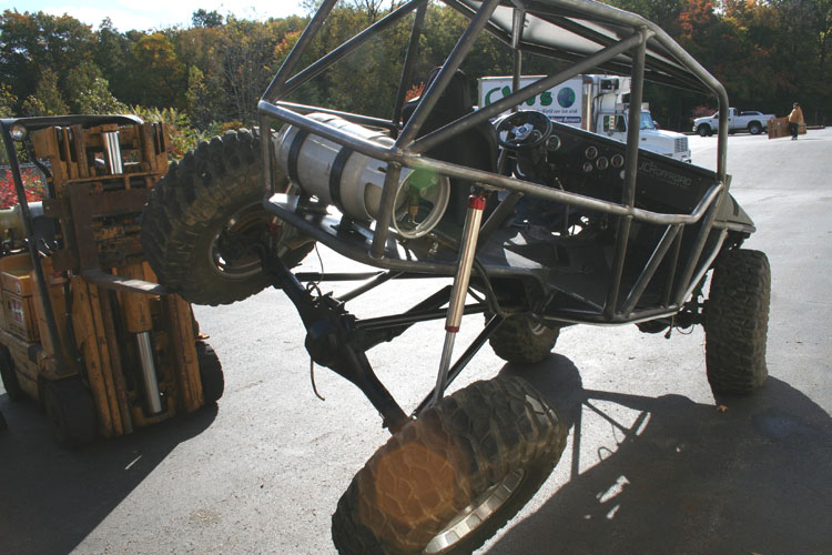

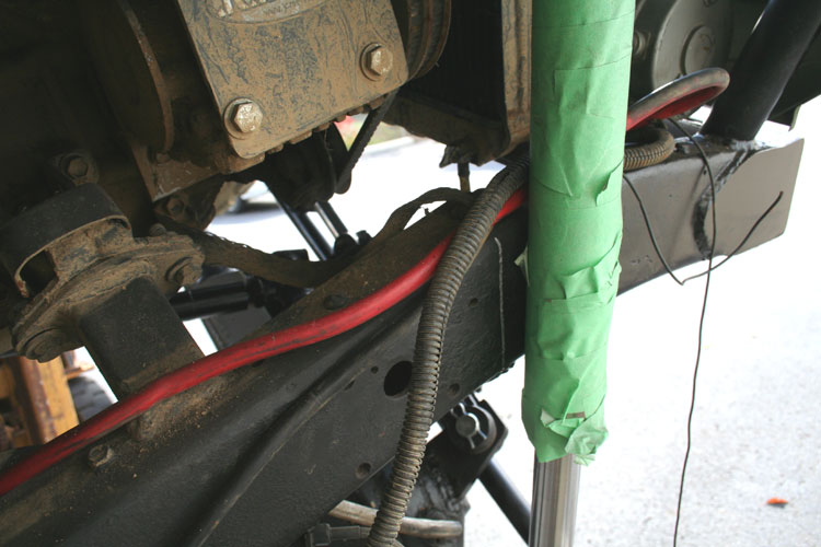

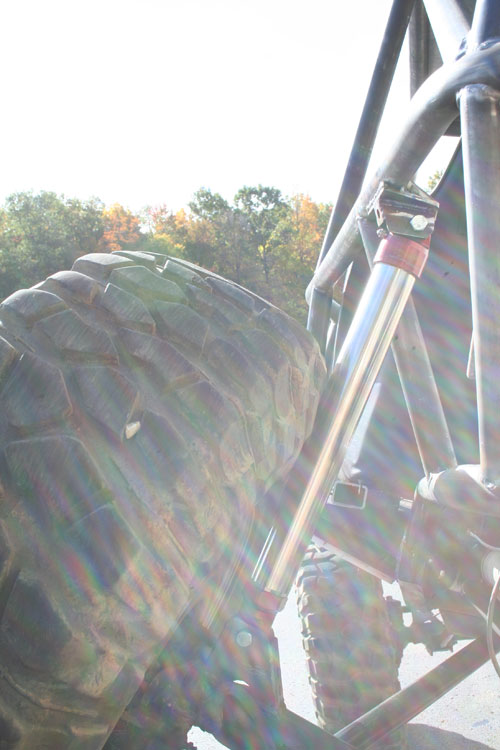

Flextest for suspension fit:
Lower Mounts have plenty of clearance:
Going to have to move these rears in a little:
Bib Hits, going to have to trim it:

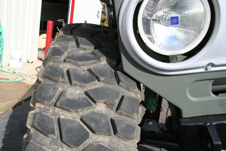

Front Flex:

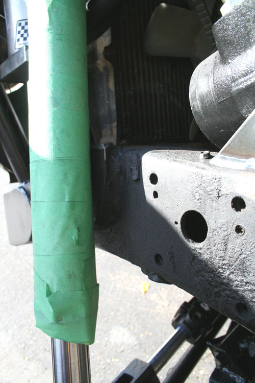

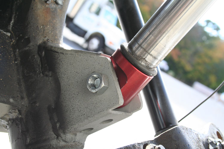

Front shocks hits the frame a little. Going to notch out a little of the frame:
Front Lower mounts have plenty of clearance:

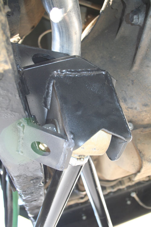

Someone Pm'ed me asking for Upper Link Mounts pics for the front:

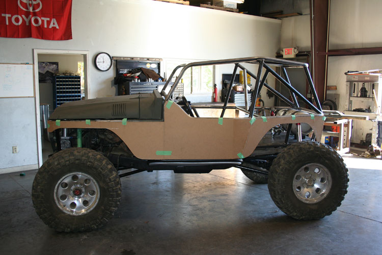

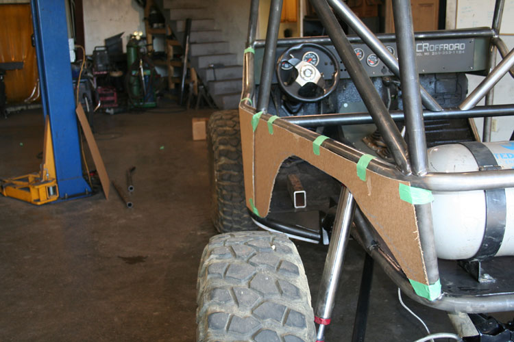

Here are the skin templates, what do you guys think?

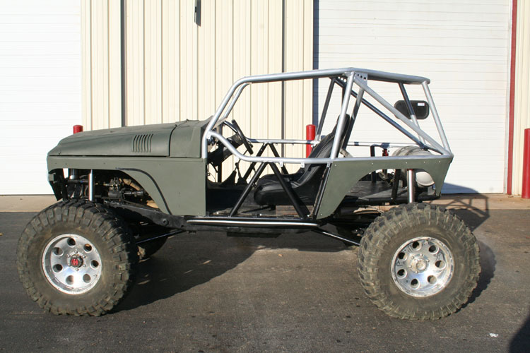

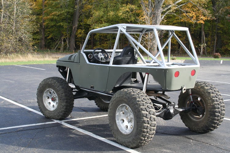

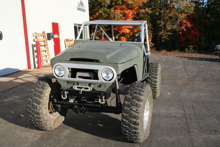

Here is what she looks like since the last update! It now drives, steerings and is probably about 1 more weekend of time from being 100% complete.
I did not like my front fender panels and could not put my finger on it. I finally figured it out last night and marked the fender for a new cut with some tape. It is also at it's final ride height.

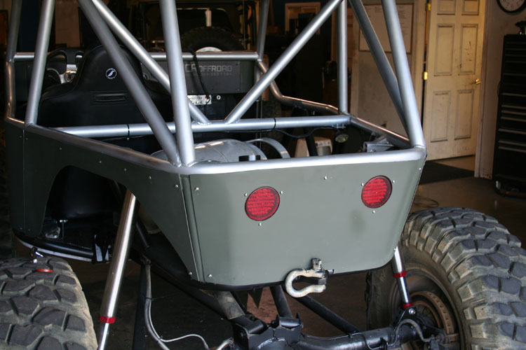

Driverside Panels done:

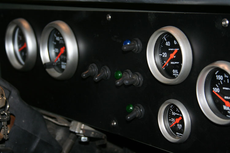

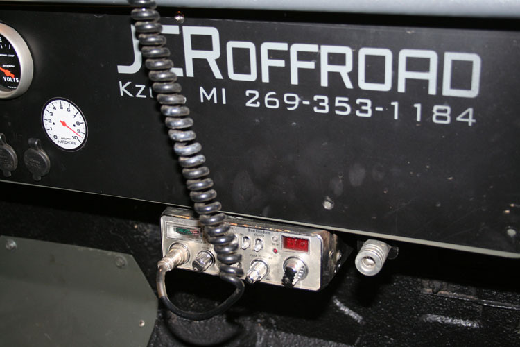

Cb and OBA chuck installed:
Finished the wiring on the toggles, so the dash is finally done!

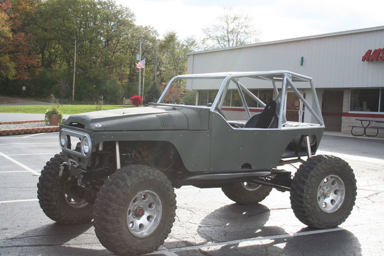

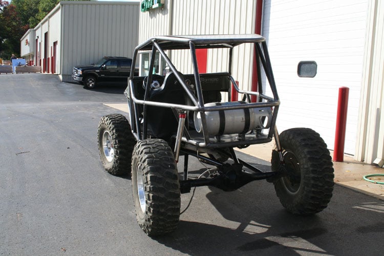

More outside pictures:
Did not get everything done, I added some stuff to my list, but it is all little stuff from here out!

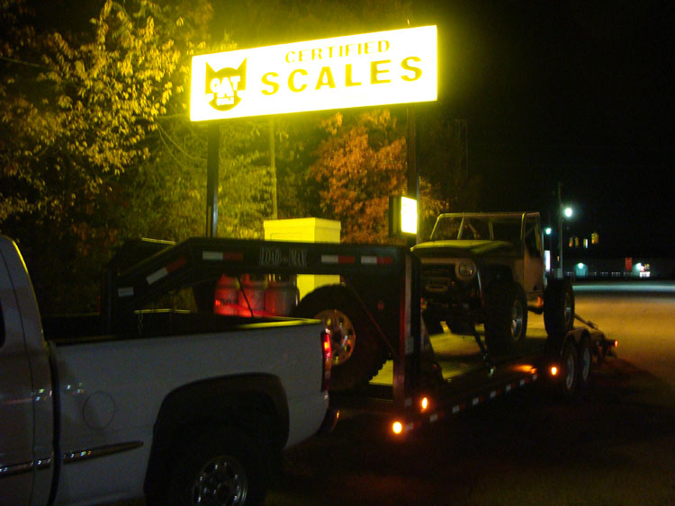

Well, I got everything done except installing the passenger seat on Sunday. The seat came today, but I did not have time to get it installed, so my wife helped out and finished it up!
I have it on the trailer, going to take it to the CAT Scales at the local truck stop to get it weighed tonight. I am going to install a grab handle fo the passenger, then it will be 100% done.
I will also get some daylight finished pictures tomorrow. Still need to flex test it one more time and make sure everything is good, then off to Windrock at the end of the week!

Took it to the scales last night.
Pretty happy with this:
