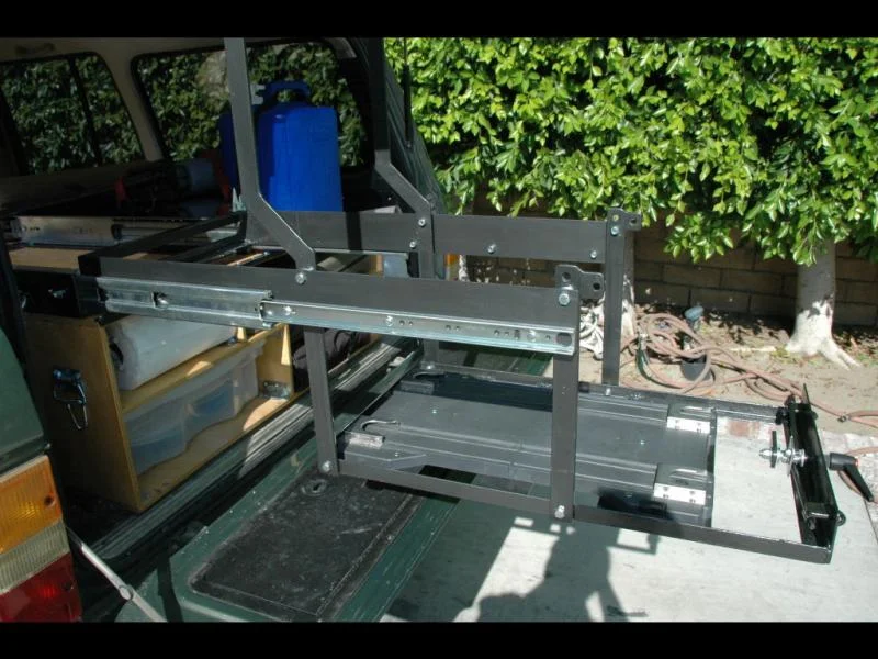

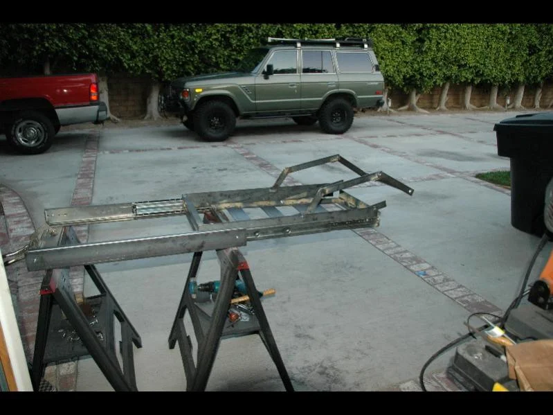

My story:
About a year ago, flipping through an Australian 4x4 magazine, I found near the back a small ad showing a revolutionary slide system. The ad showed a drop down Fridge Slide .
Now, I love my fridge, but hate pulling it down from on top of my storage system when I need to get something out. And what I hate even more is hefting the fridge back up. As a matter of fact, it does not matter if it is a fridge or cooler; they are still heavy to deal with.
I contacted the company in Australia, but they were not interested in shipping to the States. Turns out shipping from Australia is very expensive. The cost of shipping alone was way more than the cost of the product. I’m sure the weighty of the slide had a lot to do with that.
I tried unsuccessfully to talk my wife into a trip down under for a shopping spree! So, that left me to figure out how to build my own “Drop Down Fridge Slide”. I found a few pictures on the internet and there is a You Tube video showing how it operates.

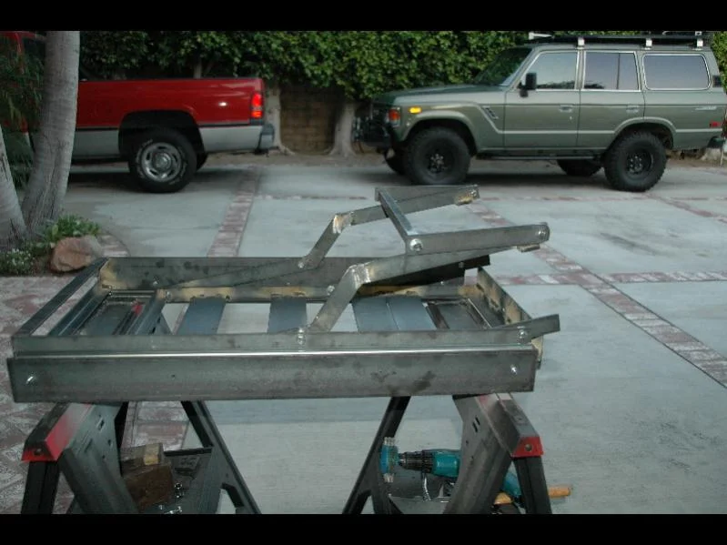

The build was not that difficult and involved a tape measure, square, chop saw and a mig welder and a lot of referencing of the pictures on the web.

Very nice. Useing the lever is it easy to lift the fridge?

There is plenty of leverage, but the original employs a gas cylinder to ease the weight of a loaded fridge. I have just completed the build and tested it with a couple of gallon jugs. My twelve year old son had no trouble operating the slide.

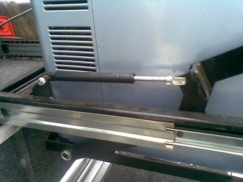

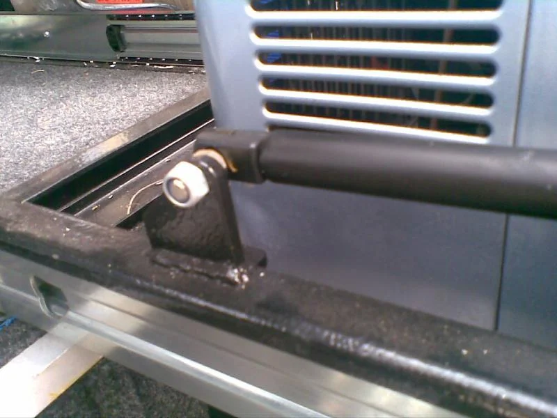

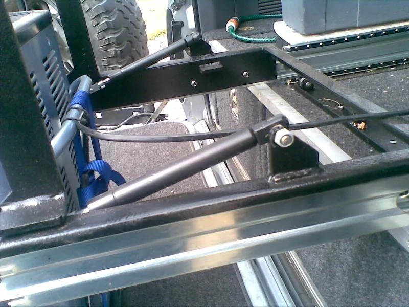

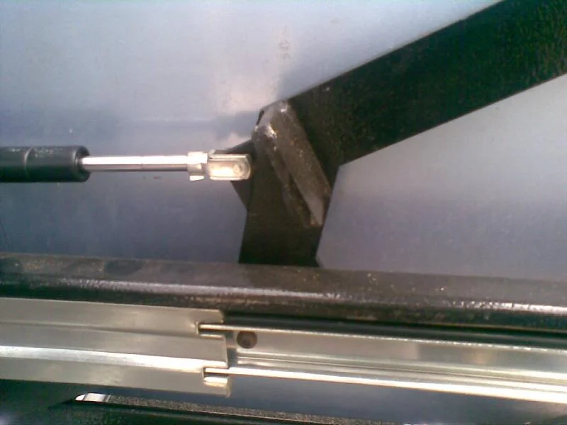

Since you have one, I have a question. I struggled with the gas lift struts and decided to not install any, but they would make the slide very wife/girl friendly to have them. How big and powerful are the struts? I tried using lift gate struts, but they were way too strong.

Will check the struts tomorrow to see if they have a part number. Wouldn't think they would have to too strong.
Thanks. I don't think so either. The slide works pretty easy without the struts. There is plenty of leverage.
I would love to see some close-up pictures of the slide. Can you post up a picture of both the strut assemble and the latching mechanism?

I really like it. If you ever do any dimensioned drawings for this let me know. I might be in Australia in a few months. I may have to look up these guys and take a look.

I was looking at making a slide like this one
it looks great
any chance you have a plan
or a material list
cheer

For those asking about plans and drawings. I don't have plans or drawings as I followed grainy internet pictures to build the slide.
Given a bit of time, I'll put something down on paper.

No Problem, when you get a chance is fine. I am most interested in the gas lift struts.

1967 TLC, I live just south of you in San Clemente. What would it cost to have one made if you had the time? There would be no rush in the build.
Nice looking, great work.
Chris

Boerboel313,
I will need to get back to you on the cost. My prototype slide was a bit expensive as I did not know how much metal or parts to buy. Of course I bought too much of everything!! I think I have enough bolts to do two more! It also took much longer to build as I was designing as I was building.
I need to do some measurments and drawings and cost out the project. Please keep in mind all this was done in my garage. I don't do this for a living, but if enough people are interested, I might just start a fridge slide cottage industry.
If you want to see the slide in person let me know or come to our SoCal Land Cruiser Club meeting Sept 13th. Click on the club link for more info: http://www.socallandcruisers.com

Some pics. Hope these help. If you need any more give me a call

One more pic

Aussie Cruiser,
That is one stout looking slide. Nice engineering. I used mine for the first time since I built it and what a pleasure to use. No more back breaking fridge lifting everytime you need get something out.
Thanks for the pictures, I understand better how the lift strut works.
