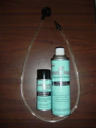

I went to the local Toyota dealer and asked about the BG Frigi-Clean... well the parts representative said that they stopped using BG products... and gave me an AC kit which comes with an Evaporator cleaner and refresher from "PETRO Checmical A/C Power Foam". This is what they use on Toyotas for A/C service according to the parts rep.
Anyways, total cost is $18.95 for the entire kit. Also, there is no hole to drill. Simply snugly fit the wedge adapter at the end of the dispensing apparatus into the evaporator drain tube and dispense it. 10-15 mins later, foam will liquify and drain out. Then follow with "ConditionAire 2005 Refresher" into the fresh air intake with blower on high...
Whole process took me 20-25 mins... and best of all, SMELLS GONE!
-hkimsoft

First, thanks Jim for helping out. I managed to find a local distributor for BG products. Seems like many have the same active ingredients on the can. I know the pics don't really add anything but we all like pics:
1996 LX450
The "kit" comes w/ the cleaner/foam, applicator tubing (bicycle nut), the Frigi-Fresh spray and then the small brass self taping fitting and a plug in case you wanted to remove the fitting when you're done.
Drilled a 1/4" pilot hole and screwed the fitting w/ a small wrench.
Connected it all up, ran the truck w/ max A/C and sprayed the foam. Blower squeeked a bit and had to pause as the directions state but got it all in < 30seconds. Ran it a bit (1 min) and shut it down.
On the sidewalk, I've gotta say was not the mud and grime I expected but my biggest problem was trying to kill the dog that lives in there. I did have two brownish stains from dirty fluid come out. (maybe a bit more impressive in person)
After sitting for 10-15 min, I ran it for 8 min and sprayed the Frigi-Clean in the cowl vents and ran for two more. Must say, smells much better so far.
Capped off and ready for next time.
Thanks again Jim. I paid right at $30 for the kit.
Bx
