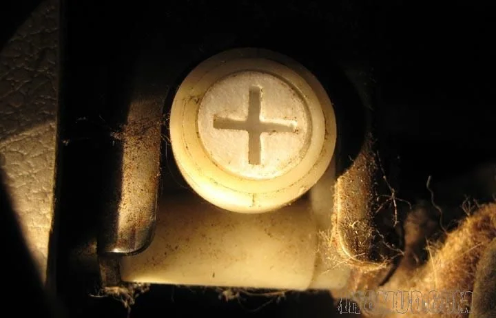

edit: and if you don't want to scroll back a page, here's another picture of the part:

Bump to top for a status update - I'm in for one.
On install, are the plugs just flush as shown in the pic or down a little into the threaded hole?

Guys, last round of prototypes appear to be spot on. thank you again for your patience here, but I am now ready to take your orders. Here is the "for sale" thread: http://forum.ih8mud.com/sale-parts/2...ml#post2999788
Brent, they actually recess into the surrounding hole a little bit, and you can bottom them out and the shaft inside will still turn. One idea that was tossed around with one of my test subjects here was once you put them in and decide you like them, take them out again and put a dab of super glue on the threads, to act as a little loc tite.

I thought about taking the old one - if I can find it - it fell out again while some work was being done on the truck and have yet to pull the seat to look for it, and dabbing a little epoxy on the threads. I can't really tell if the plug or threads in the housing are stripped a little. If your plug comes out I may resort to super glue, monster glue or epoxy to hold the sucker in.
Reason for the question is that when I cranked the plug in seemingly as far as it would go, the seat would not move, but when I retracted it a little it worked just fine.
For the price, I'll order one anyway. Thanks for all your work!

I have an official Nakman plug in my seat
Just a little parking lot testing and it worked perfectly. Funny that such a little thing can cause so many problems
Anyway, Tim popped my old one out and sure enough, the seat stopped working...Tim then put his Nakman original in and voila, the seat worked again
Kudos to Nakman

Coming up missing for the most part Rick. Mine has fallen out and I've tried putting it back in to no avail so far. For $6, I'm going to try a new plug. I don't know if the plug threads are shot or the hole threads. If Nak's plug doesn't stay in either a little epoxy after I get the plug set to the proper depth will be in order!

they fall out and cause your seat to not go one direction or the other. In my case, it goes forward, but binds up when I try to go backward. The caps are threaded in and hold the worm drive screw in place for some kind of linkage. The threads strip out and the screw gets messed up in there and it all goes to s#!t.
W/out the little caps, you have to either buy a new motor assembly to the tune of about $400 or possibly you can find a little housing for the assembly, if you can produce it for the parts guy. That thing costs around $80, IIRC w/out rereading it.
This little cap makes it so that, as long as it hasn't been messed up too long, and the little nylon nut isn't all stripped out from the worm screw being out of place, you can put it back in and, voila!! The seat works again.
Yeah, that's it, in a nutshell.

I was going to say, what a waste of good alcohol... but if it fixes this damn cap it's worth it...I know, not good alcolol, just the denatured type.

Isopropyl alcohol 91%, Super glue is moisture cured and the 70% stuff has too much water in it. You can get the stuff at any good pharmacy.
Denatured alcohol will get the same job done. I'm afraid that Monster Glue (which I have) will expand too much and crack the housing as it cures. I haven't had good old super glue around for years. Epoxy is probably too drastic.

I have a buddy that works at NASA, and he has the stuff they use to attach TEFLON to things!! He said they just scuff up the teflon and apply this stuff and it holds. If it'll do that, it'll hold anything!!

I'm not sure you guys want a permanent bond here. I'm sure the super glue would hold sufficient and you could still remove the plug if needed later.
Agreed - epoxy would be a last resort. I don't know why these damn things were designed to come out in the first place tho!

What about drilling a hole through the plug and housing and using a piece of wire to lock it in? I think someone already suggested it but I haven't heard any yay/nays.
