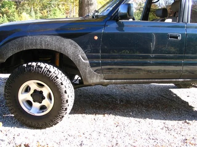

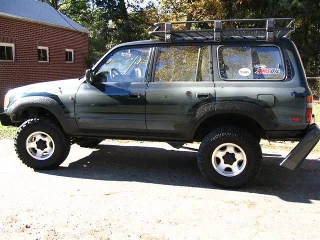

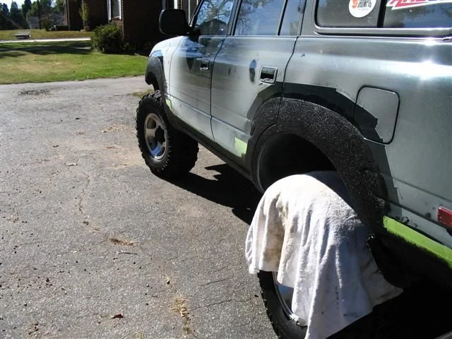

Finished. I thought it turned out excellent. I'm very pleased with the product and have a good bit left over. I'm going to line the sliders before i put them back on. Anyways, here are some pics.
DIY fender lining (Part 1): http://forum.ih8mud.com/80-series-tech/65877-diy-fender-lining-part-1-a.html

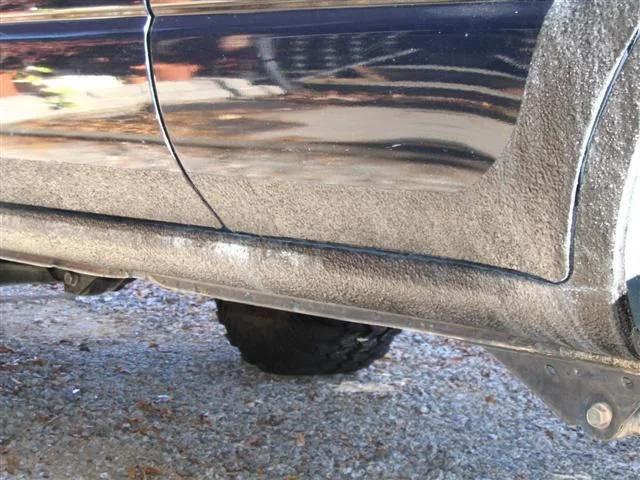

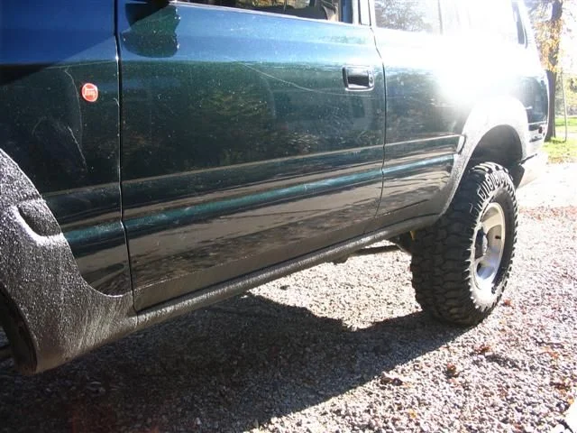

Some more. Now i need to allow it to finish drying and go wash all the dust off the rig for the full effect.

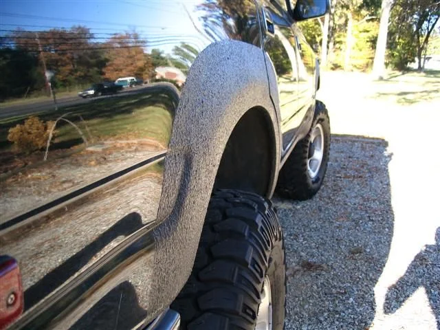

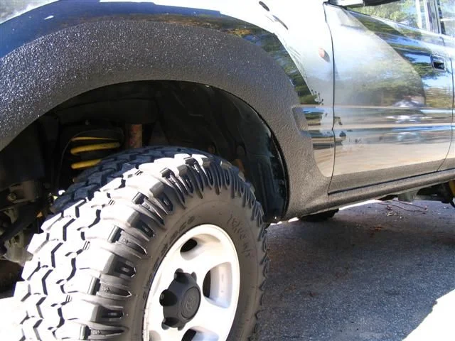

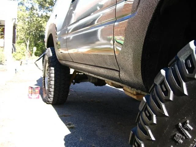

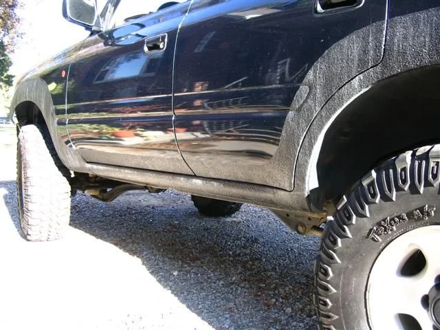

and more.

I like the continuation along the doors!
Very nice. Wonder if done on flares - leave the rubber trim piece?

very purdy, hope I can do as good a job on mine. How many coats did you put on all sides?

I put on two thick coats, and a third in some places to ensure it looked uniform.
I think lining the flares would be doable, i would take them off to do them though. This stuff is very messy, and the slightest screw up makes for a big mess. The hard part will be taking the flares off without breaking anything.
By the way, if anyone needs any of the gasket material for the flares i have some new in the box OEM gasket i'll sell.

That look great! I've been trying to decide if I wanted to go below the doors or all the way to the rub strip, but I really like the way it looks going in between. Thanks for the write-up.

looks awsome i like how high you went on the doors, just over the textured surface? also int he third picture it looks as if your frame and brackets are painted with a black paint, true? thinking about doing some kind of coat on my axles and contorl arms to protect from further rust i have collected driving in the dunes in the summers possibly even the wheel wells. anyway great job how hard was it to get the tape to stick to prevent leaking under the endge, was it easy to clean off where you didnt want it?
No paint on the frame and brackets, just armoral foam spray. That's the greatest stuff ever. especially before you go wheelin', hit the undercarriage with it and the dirt and mud falls off. Keeps everything looking new also.
The tape is 3M. I washed the truck so the tape stuck very well. I highly recommend 3M products.

I like it! Did you use wire tape for masking?
I just ordered some for my rig. Can't wait to do that job

One question: how are the wholes from the fender flares after the taping and applied the coats? Can you press on where the whole is and feel it give way? That's my only concern with your approach.

Jim, i couldn't really say. I haven't gone out there and started poking around. I won't feel comfortable pushing on the product until tomorrow, giving it a chance to fully dry. But preliminary would say i'm not sure i can even tell you where the tape is. THe finish is consistant and smooth, so there are no dimples anywhere.

Old 11-07-05, 01:16 PM   #21 (permalink)
Forum Lifer
concretejungle's Avatar
Join Date: Oct 2003
Location: North Cadillac
TLCA# 14646
Posts: 6,758
Sorry for the late pics. I've been in Fort Worth, TX and then had a cold when i got home.
Anyways, here are a couple of pics after i sprayed it off and then wipped it down with a towel. No major wash here, hence the dust run lines from the rinse in the lined part. I'm sure it will come off with a little more water/soap and some scrubbing.

Old 11-07-05, 01:17 PM   #22 (permalink)
Forum Lifer
Join Date: Oct 2003
TLCA# 14646
Posts: 6,758

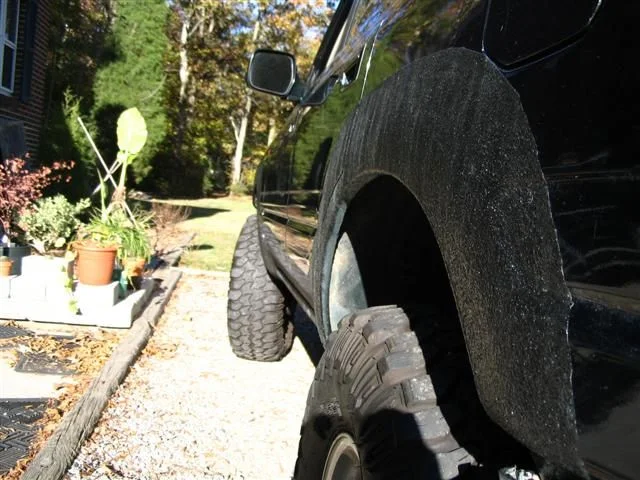

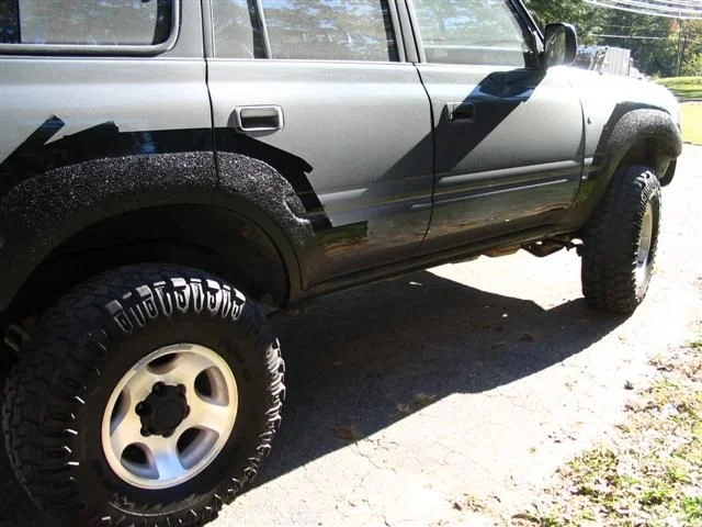

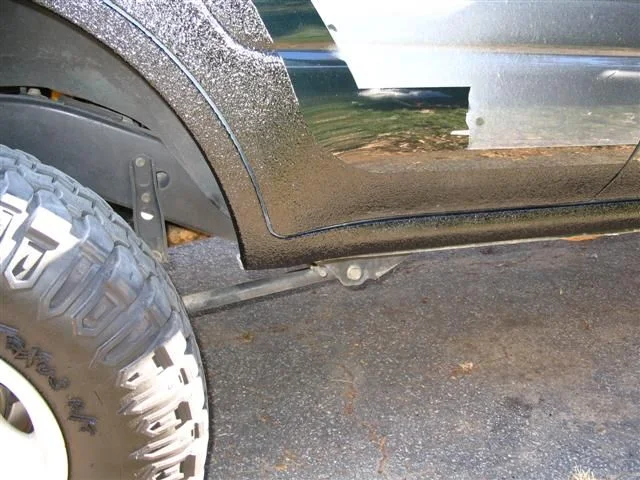

couple more.

Old 11-07-05, 01:28 PM   #23 (permalink)
250+ Club
Newps's Avatar
Join Date: May 2004
Location: Newport Beach, CA
TLCA# 15243
Posts: 812
Very nice, I like where you put the lining on the door & the rocker. I have been debating going higher up the door but I think your height is the ticket.

Old 11-07-05, 01:52 PM   #24 (permalink)
Forum Lifer
Join Date: Oct 2003
TLCA# 14646
Posts: 6,758
It was one tape-roll width on the doors.

Old 11-07-05, 04:19 PM   #25 (permalink)
Forum Lifer
Arya Ebrahimi's Avatar
Join Date: Dec 2003
Location: Rockville, MD
Posts: 2,738
Hard to tell through the comp screen. Any signs of the aluminum tape through the durabak now that it's dried?

Old 11-07-05, 04:46 PM   #26 (permalink)
Forum Lifer
Join Date: Oct 2003
TLCA# 14646
Posts: 6,758
Quote:
Not at all.
