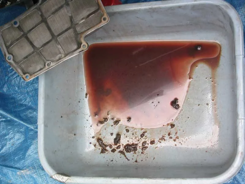

Transmission Filter Clean Results
I dropped the transmission pan on my 62 yesterday before doing a "Rodney flush", removed the filter, cleaned it, and ended up with a good amount of friction material (see pic below).
The fluid in the pan itself looked OK, but there were a couple of magnets stuck to the bottom of the pan that had a layer of fine shavings attached to them.
I also added the B&M trans cooler mentioned in other posts here.
I put it all back together, filled with Mobil 1 synthetic dexron III and everything seems to be working well... (i did under fill on my first test run which resulted in a couple of slips, but once everything was topped up, it is all good).
So, is this alot of crap in the filter or what could be expected if no one had ever gone in there before?

Looks about like mine did.

thats pretty clean

Tapage, I haven't seen dexron II on the shelves anywhere here is the US. I Believe that dexron III is an improved version that replaces II and IIE, so it is OK to use in our trannys.
Euclid, how long did yours run after your filter looked like this? Did you say ~2 years?

I did two cleans. The first time it looked like those pics. About 2 yrs later I did another clean and it was half that bad. A few months after that I was replacing the transmission.

Just an update... successfully made the 500+ mile roundtrip into the mountains this weekend with no tranny problems at all. Since I haven't gotten the trans temp gauge in yet, the old "hand on the side of the shifter base gauge" was used and never got too hot. Between the cooler install and cleaning the filter I think we've got a second wind.
