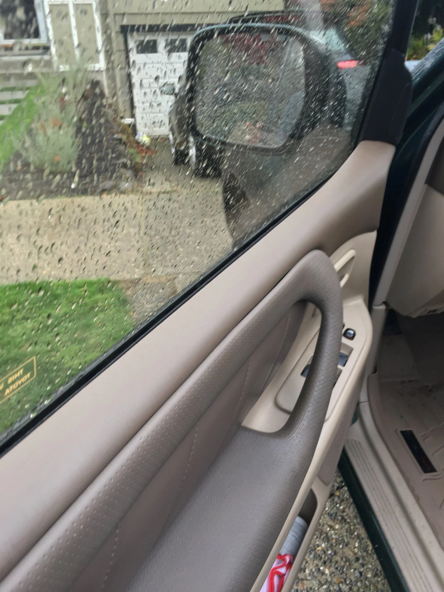

As the title asks. The top of my door card is worn through at the exact spot the previous owner rested his elbow (not surprisingly, mine rests in the exact same spot)
Is there any way to replace (or repair) just the top of the door card or is it a single piece, replace it all deal.

I picked up a drivers door panel from car-part.com last year to replace mine. The one that came from the parts yard was bad on the bottom but the upper was fine. the top and bottom sections of the door card are just stapled together on the back of the door card, so I separated the two sections and used their upper and my existing lower section. It is a bit tedious to remove the staples and reattach, but not too difficult. Shipping should not be to bad for a door card, so don't limit your search just to the local salvage yards.

So, I finally followed up at one of the local auto upholstery shops, Rich's here in Seattle. Apparently, there is a fix. It is a stain/dye that is applied to the effected area after it is prepped (cleaned, sanded). There is a slight loss of texturing but you have to be told and have a comparator to see the difference. The shop says it holds up very well; that the finish is comparable to OEM over time. Honestly if it lasts a bunch of years I'll be happy.
