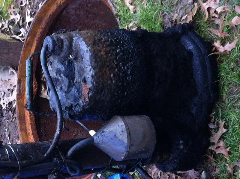

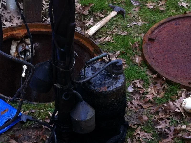

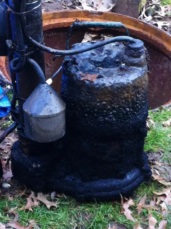

Got it apart , I dont feel the pump is long for the world as I went to grab it by the handle and it pulled off and the cord dosnt feel good under the jacket , (lumpy) . I really dont think it was set up right as the pump top half hangs out of the water it seems most of the time .
The float I removed had 2 , (min/max???) Both had water sloshing around in them . The one I put in is a single unit , better then nothing

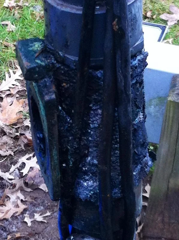

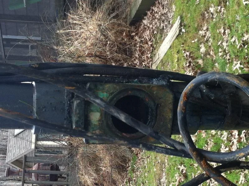

Heres some pixs of the fitting , once I figured out how it was set up its pretty easy to remove (has a long PVCpipe at the top with a T to left out the whole unit ) just heavy as hell
What kind of fitting is that ?
"UPDATE" Toyo FJ40 Has let me know its called a "pitless adapter" , thanks Kevin

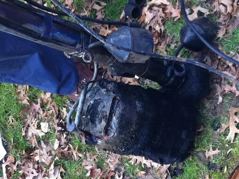

some more , cant figure out why I cant rotate the pixs as they show up right but when I post them they don't
This is what happens when you use a Iphone to take pixs (wife couldnt find the reg camera)
That looks like a Hydromatic ejector pump. They're a good pump but if you think there's a problem with the electric line Finkle's stock Hydromatics ( for @ $400)
Looks like it's been running warm by the amount of poo baked on.
