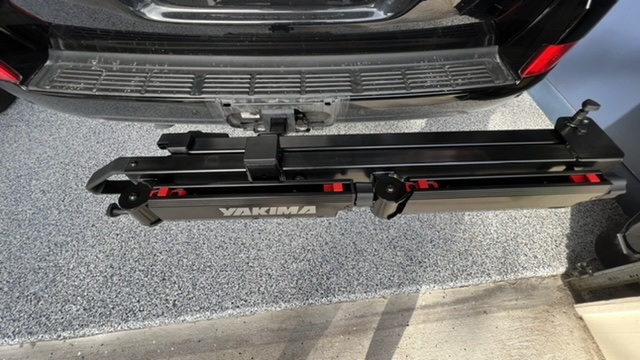

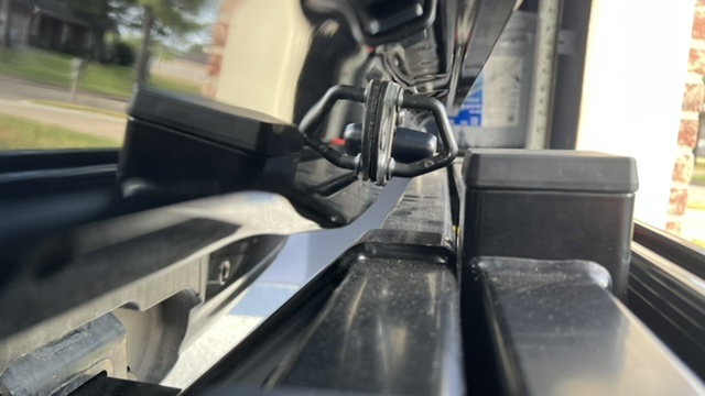

Yes indeed. I took the EXO plunge a couple weeks ago, then took a long road trip to test it out with two bikes.

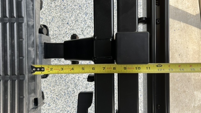

First, the Swingbase by itself is heavy, but I see it as heavy-duty. Once it is in place and the locking bolt is ~fully~ tightened, it’s rock solid. Tested this pretty thoroughly on the highway and a few “green and blue” trails in the Rockies, with bikes on.

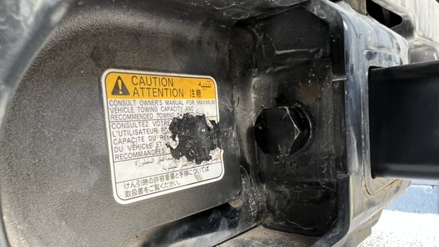

Second, as everyone here knows, Mr. T’s plastic bits around the receiver interfere with just about every pin, lock, and hitch product out there, including regular trailer hitches. I’m considering trimming part of this plastic out. It seems to fit better and is easier to torque down with the bolt entering from the driver’s side. (YMMV)
Third, the DoubleUp bike rack is easy to assemble, fasten, load, and operate. It’s weight is awkward but easily manageable. The locking ‘tongue and groove’ mechanism - for lack of a better name - that connects and secures the accessory racks to the Swingbase was new to me, but it is pretty slick - and it stayed securely in place for 2,200 miles and many uses. Maybe I’ll post more on this later.

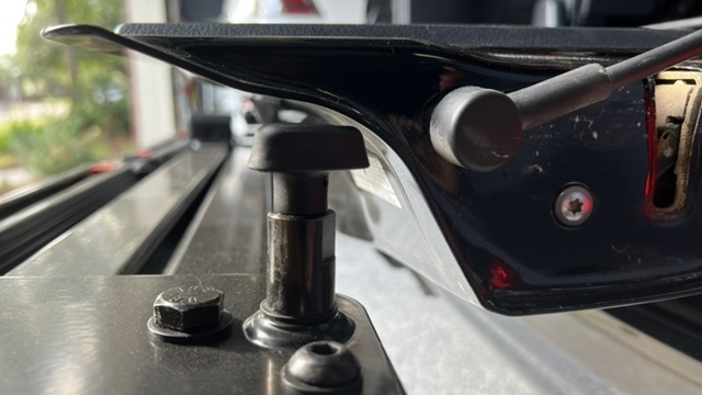

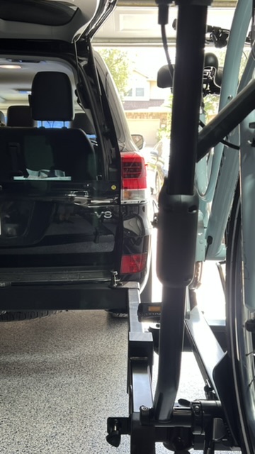

Saving the most important for last! Yes, the hatch and tailgate will both open with the Swingbase in place - in both folded and open positions. ** See caution below ** Hatch will open with DoubleUp installed, but not with bikes (duh). Neither will open without hitting bikes in the closed position, but no problems when it is swung out of the way. Easy to operate the swing and lock, locks open and closed. Closure has an extra hand-operated giant “wing nut” locking handle to tighten it all down.
** Caution: this locking handle MUST be turned “level” otherwise the tailgate will hit the end of it when turned vertically. I’ll post separately about a lesson learned. **
Now for a few pics of the Swingbase only (on a 2018 LC).
And a pic of the DoubleUp loaded with two bikes, in the open position.

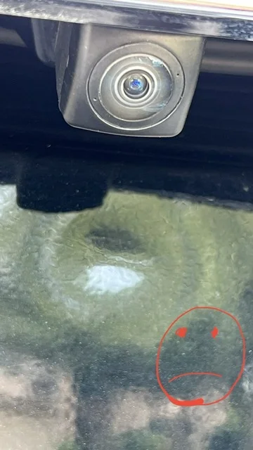

So here is the lesson learned:
Always tighten the handle and leave it level with the ground. Always.
I had opened the Swingbase, removed the racks, and then left the Swingbase locked, but that handle was not engaged and [Edit: able to spin freely]. I left it like that, forgot about it, made a quick trip a few blocks. Someone who shall remain nameless opened the tailgate and sat on it. The handle had apparently oriented itself into a vertical position during the ride. Result: I’m making a trip to have the dent pulled out soon. :-/

Looks well engineered! I appreciate the in-depth description and pictures! Thanks
Yep, sturdy. I should have added that it’s steady on the road too, the bikes were not bouncing around like other racks I’ve had. If I upgrade or add stuff, I’ll report back, but for now the wallet needs a breather.

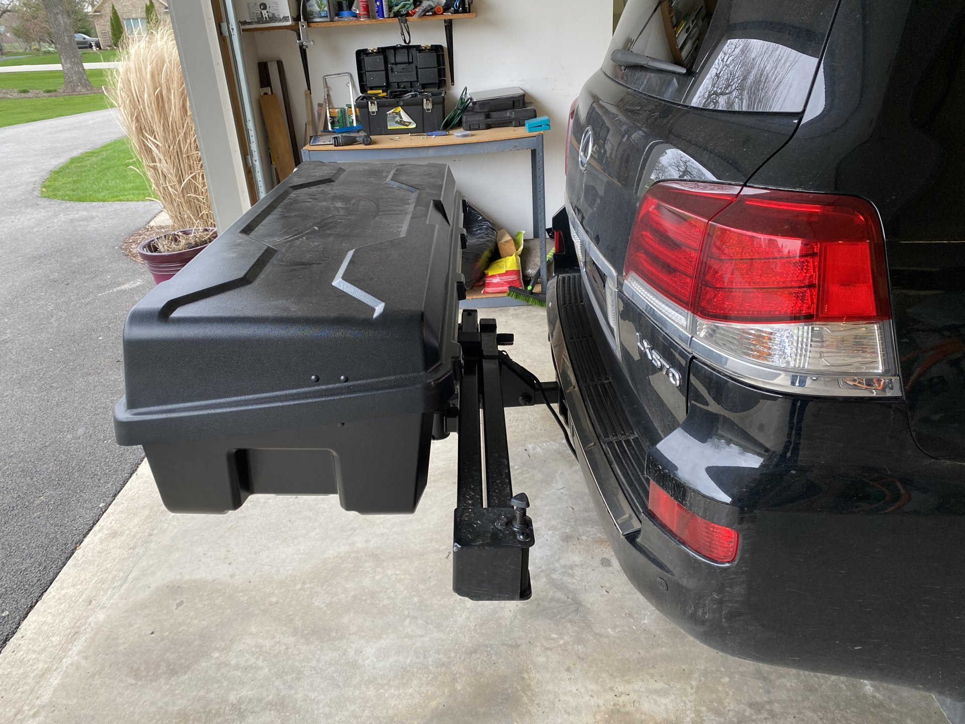

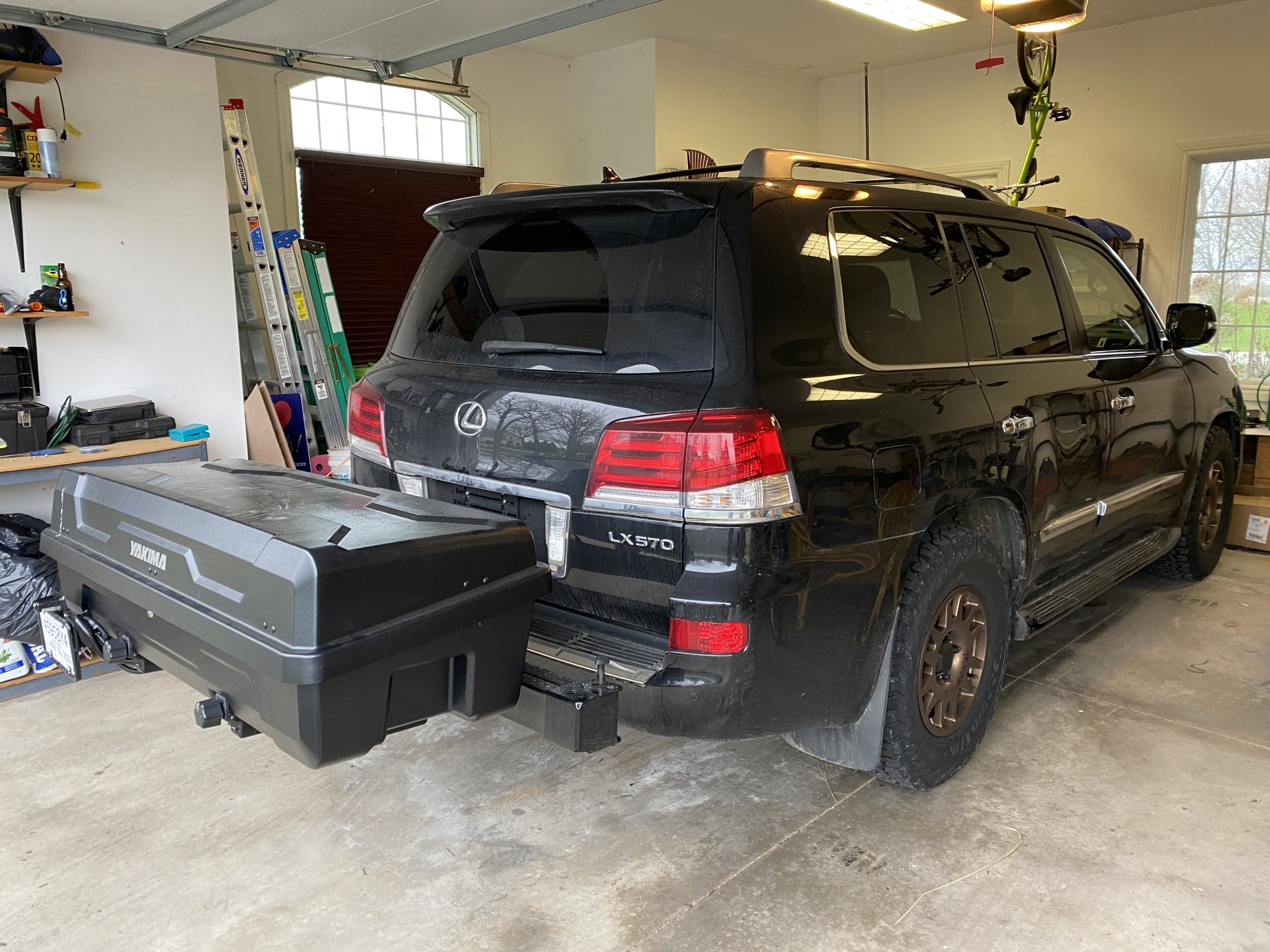

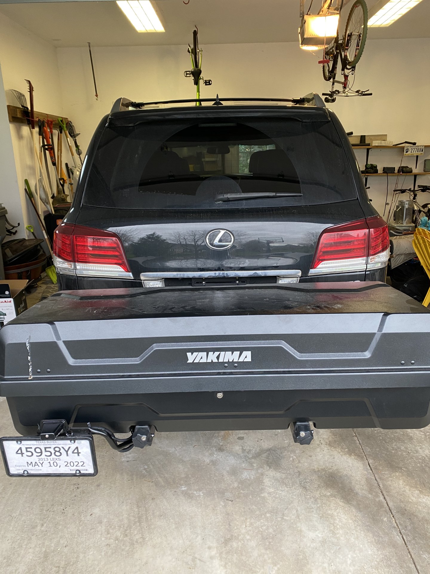

Nice! When and where did you buy the box? It’s been out of stock for a while now. Thanks for posting. That might be next on the list.
I purchased it in March of 22. It was hard to track down even then but I found one in store at an REI here in the Chicago area.
