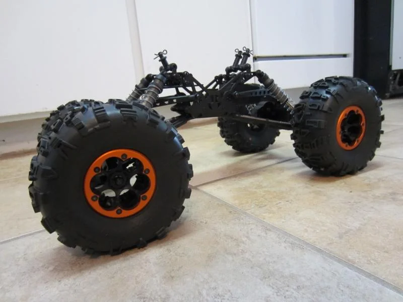

Well bit the bullet and started my xr10 build. :cool:
Been doing my research over at rccrawler.com, but 'mud's my home so figured I would post up here as well.
So far:
xr10 kit
pro-line chisel G8 tyres (we have a ok local rc shop, so like to give them business when I can and these seem fine for my use)
hitec hs-7950ht servo

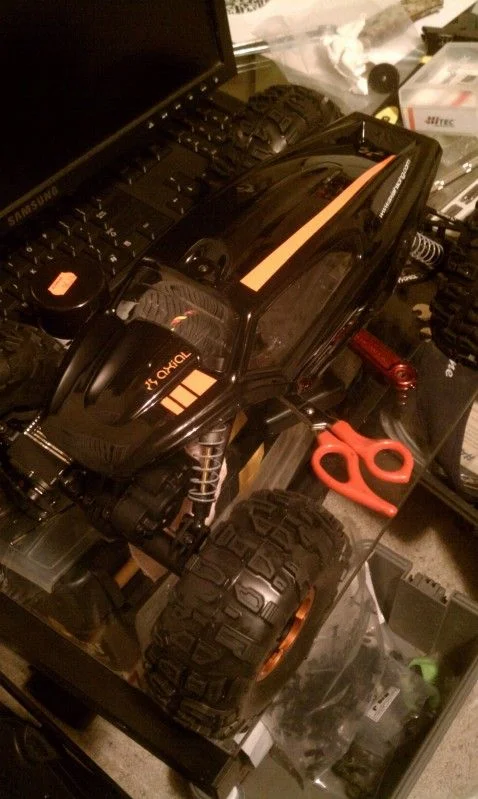

Thanks. Not much progess as of yet. My servo showed up (HitTech HS-7950HT) and got it sorta aligned and got the paint done. Nothing fancy, but tuned out pretty good for being my first time. Hopefully will be ordering the hacked GT3B tx and 3ch receiver tomorrow.

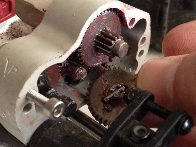

you should upgrade the motor plate, bearings to keep from eating gears. Or, do it once and upgrade the gears to the rc4wd gears along with the vanquish plates and cases.
Are you planning on running to ESCs? I would run castle sidewinder micros.
also get a robotronics steering arm.
Most guys are chewing up the stock gears pretty quick.

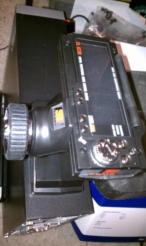

Thanks! Just ordered the hacked gt3b radio w/ and additional 3ch rx.

If i were in your shoes, get one ESC and a punk dig ($45). Get a cheaper dx3e and spend your money on rc4wd gears and vanquish motor plates. I had the vanquish motor plates, upgraded bearings and vanquish motor cases and still blew up a set of gears. I know you are doing your homework but i'm just trying to give you some ideas. I have heard of a lot of people chewing up their gears on small climbs or after the first 10 minutes. Go ahead and put some money there and forget about it.
get a couple of clothes pins. They will act like a second set of hands holding wires together while you solder them. You will get better at it, but just like needing to know how to weld when having a cruiser, you really need to be able to solder.

I totally understand the budget. That's why i say gears since that is the weakest link on the truck. Get those right and you won't have to worry about them again. Everything else is more of a tuning upgrade.

Coming along. Just got confirmation my "hacked" gt3b controller and rx shipped. :)

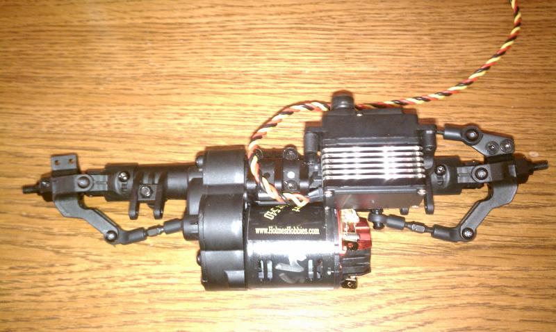

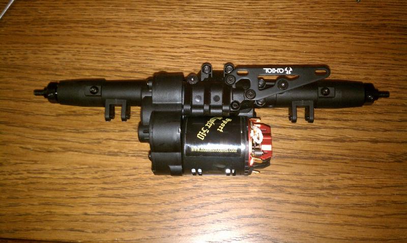

Motors installed :cool: Need to go grab some wires now to solder up.
looking good.

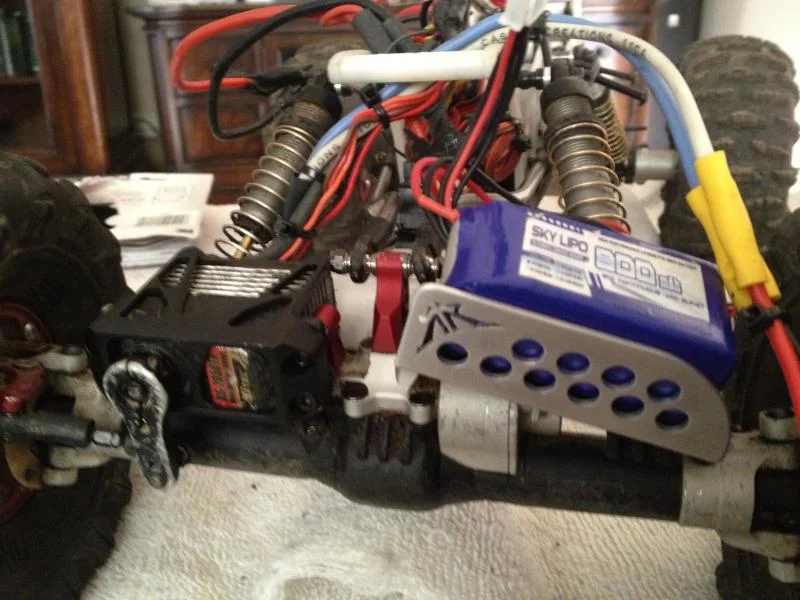

Check this out... saw on the crawler board about stuffing your BEC up under the steering servo! Also got a battery try and some servo armor.
:eek: Ya, stuffed is right. Think I want to run a tray like yours as well.
