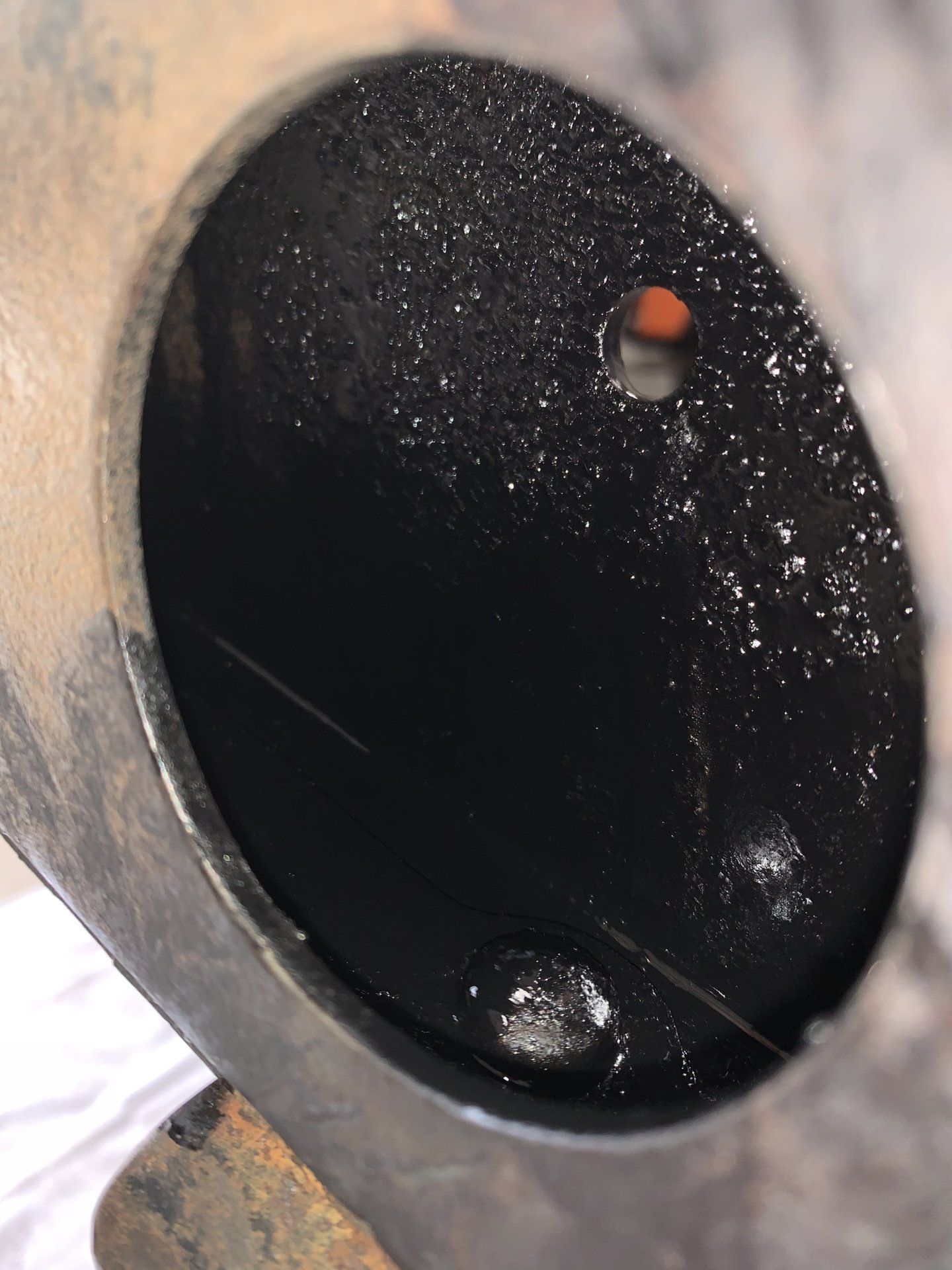

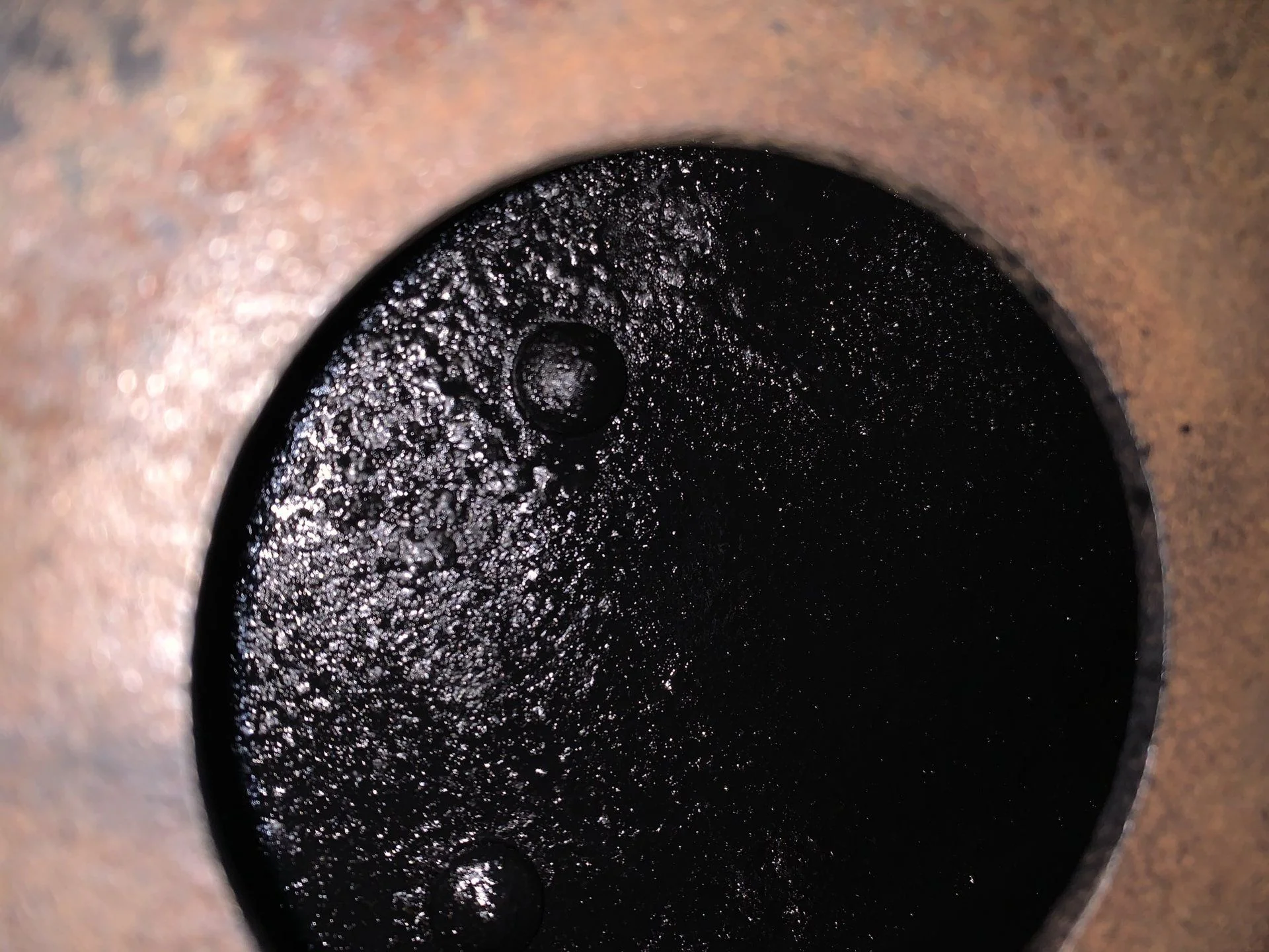

Ive been working on my fj40 frame. I put several pieces of wire into my drill to clean off the inside of the frame as best I could. Then used the Eastwood internal coating. Took a short video. I think it worked ok, better than doing nothing.
some pics of the internal frame coating:
