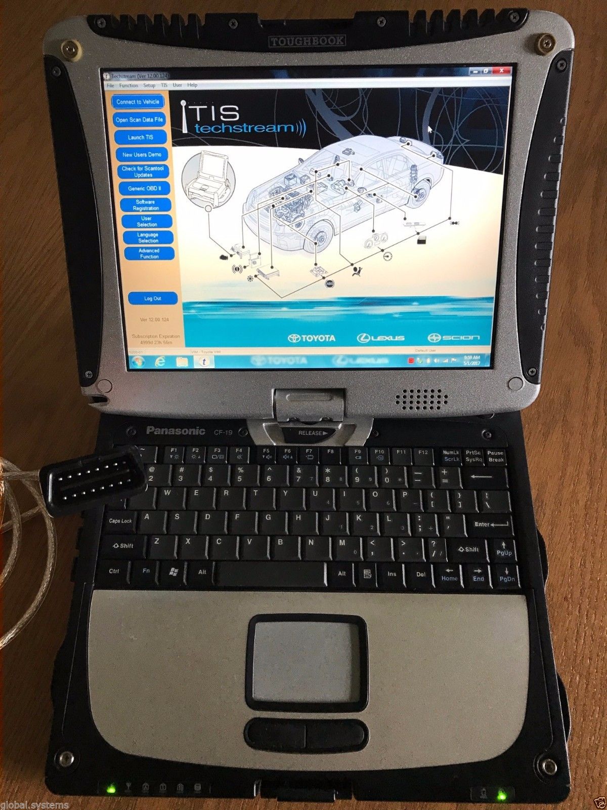

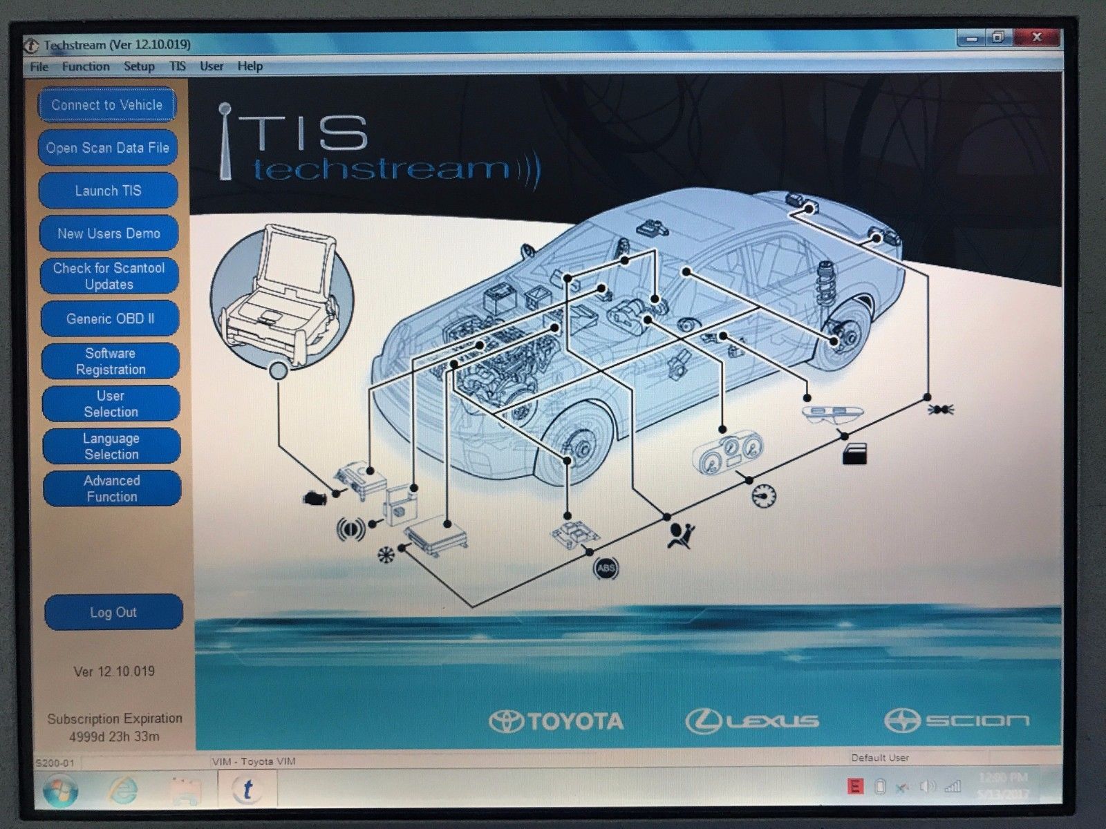

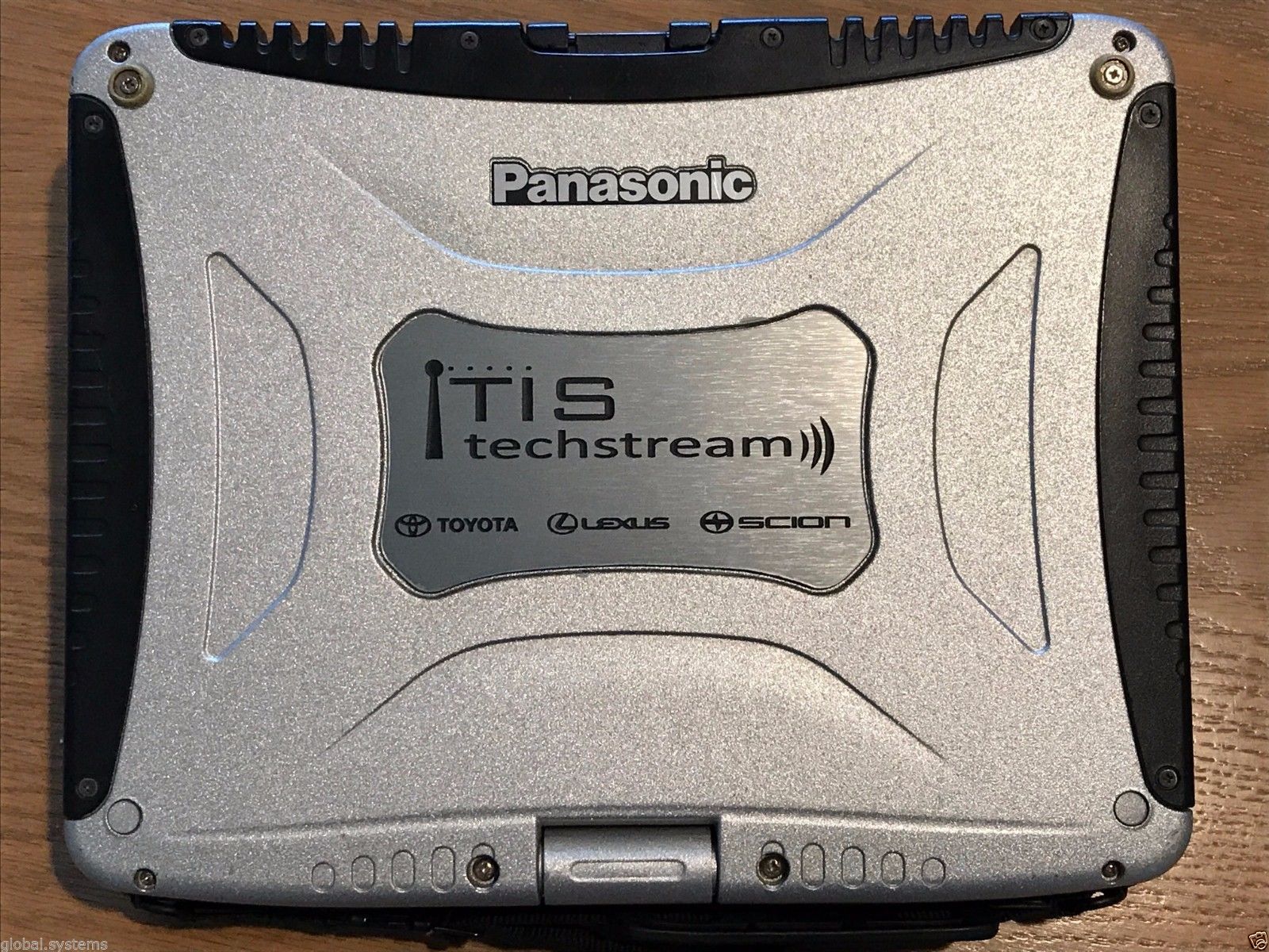

Is the Knockoff TS as good as the OEM? I found a hacked tough book with what is claimed the latest software. $40 vs $400 - is it worth it?
Toyota, Lexus and Scion Techstream Diagnostics/Programming Tool
THE LATEST VERSION OF TECHSTREAM 12.10.019 (5/2017)
DIAGNOSTICS and PROGRAMMING 1992 - 2018
Includes Calibration Flash Files
ALL REGION ACTIVATED
Good condition Toughbook (no touchscreen) with charger and OBDII cable
PLUG AND PLAY, READY TO USE

View attachment 1501206 View attachment 1501207 View attachment 1501208
$15-30 vs $400.
Without the specs of the laptop, the CF-19 could be anything from an antique C2D to a more modern i5. I really don't see the benefit of buying what could be a really old laptop and paying a premium because of the decals on the outside, and the software that is preloaded.
I have a number of spare laptops floating around, and had no issues loading the software. My current TechStream device is an older Dell Venue Tablet. Then again, fiddling around with a computer is very much within my comfort zone.
