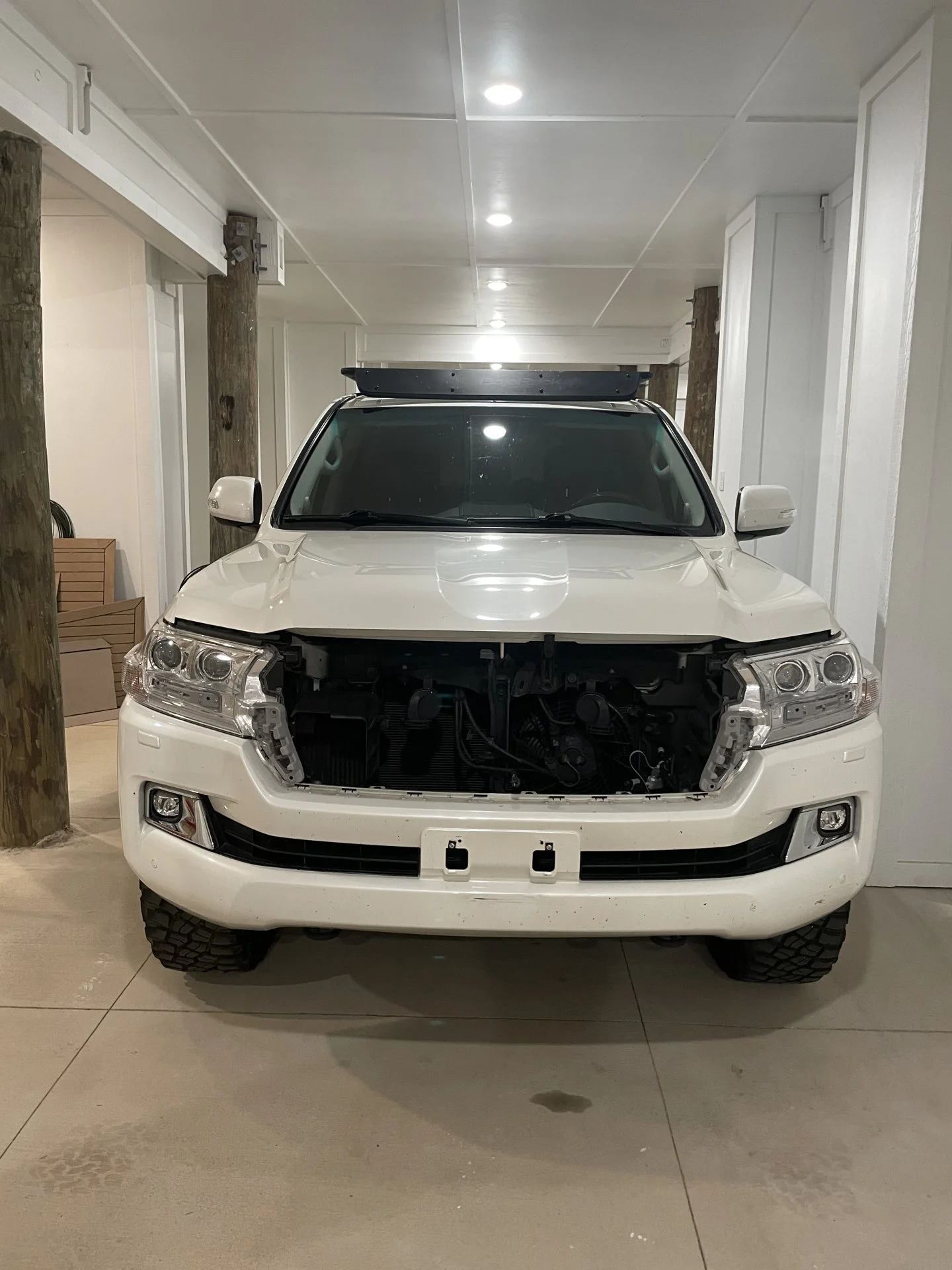

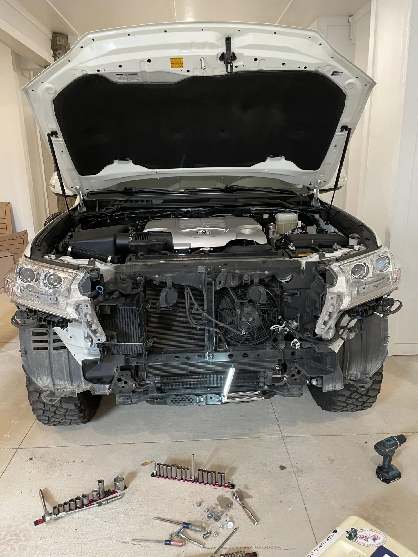

Some pics to start. Got everything organized and hardware sorted and bagged. I’ve installed winch bumpers on my previous 2020 Defender, an LR3, and now here we go for my first Toyota. Will do my best to get the rest of the front end off and cradle in place by tomorrow.

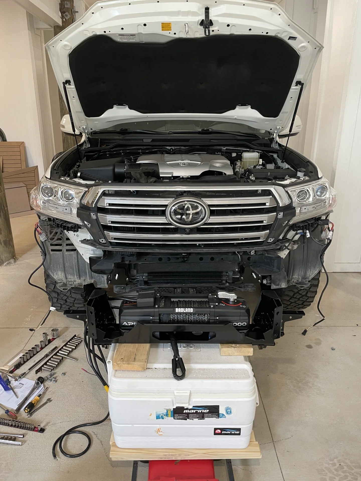

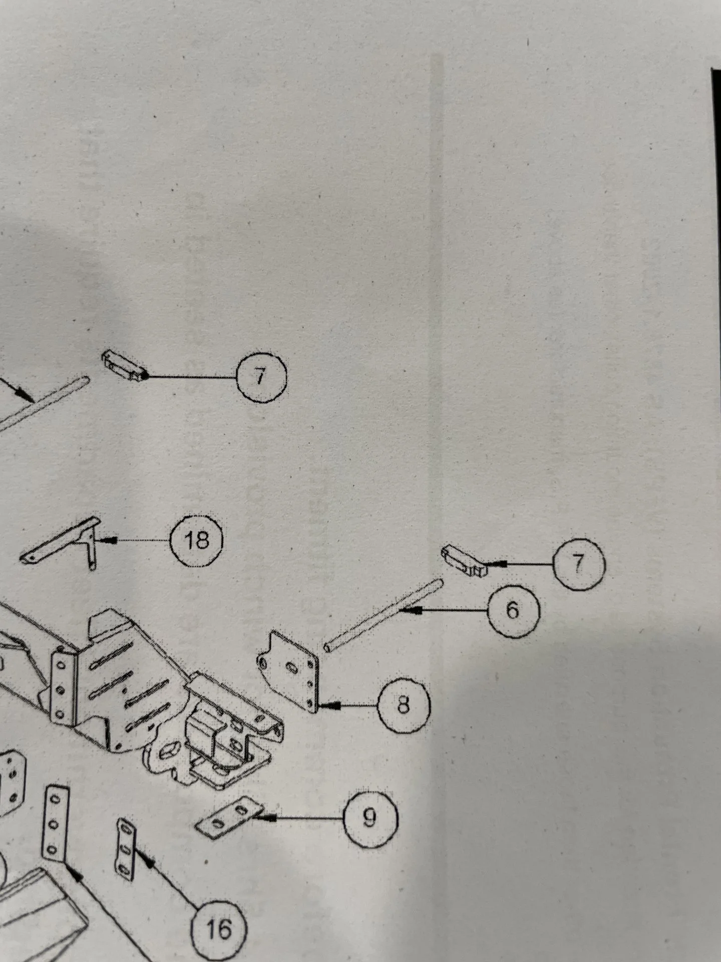

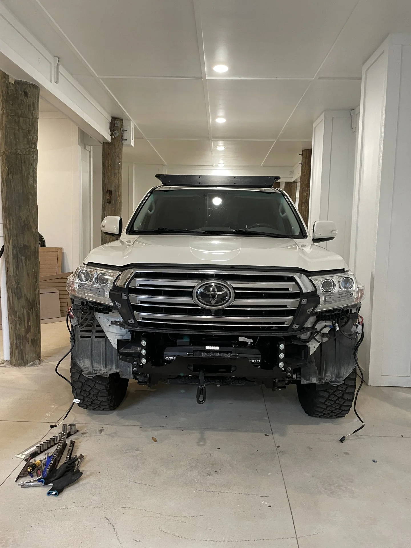

Made some progress today - at least to where I wanted to be with the winch and cradle mounted. One of the complaints I read about this installation on older 200s was the chassis rail mount bar (part no. 7) not fitting without grinding it down. They slid in just fine on mine so they must have changed the design some.
I at first thought the drivers side would be tricky, but it slid in just fine from the other side of the chassis (Engine bay out).
All in all, so far everything fits. Much better than any install I’ve done on Rovers that need a lot of customizing.

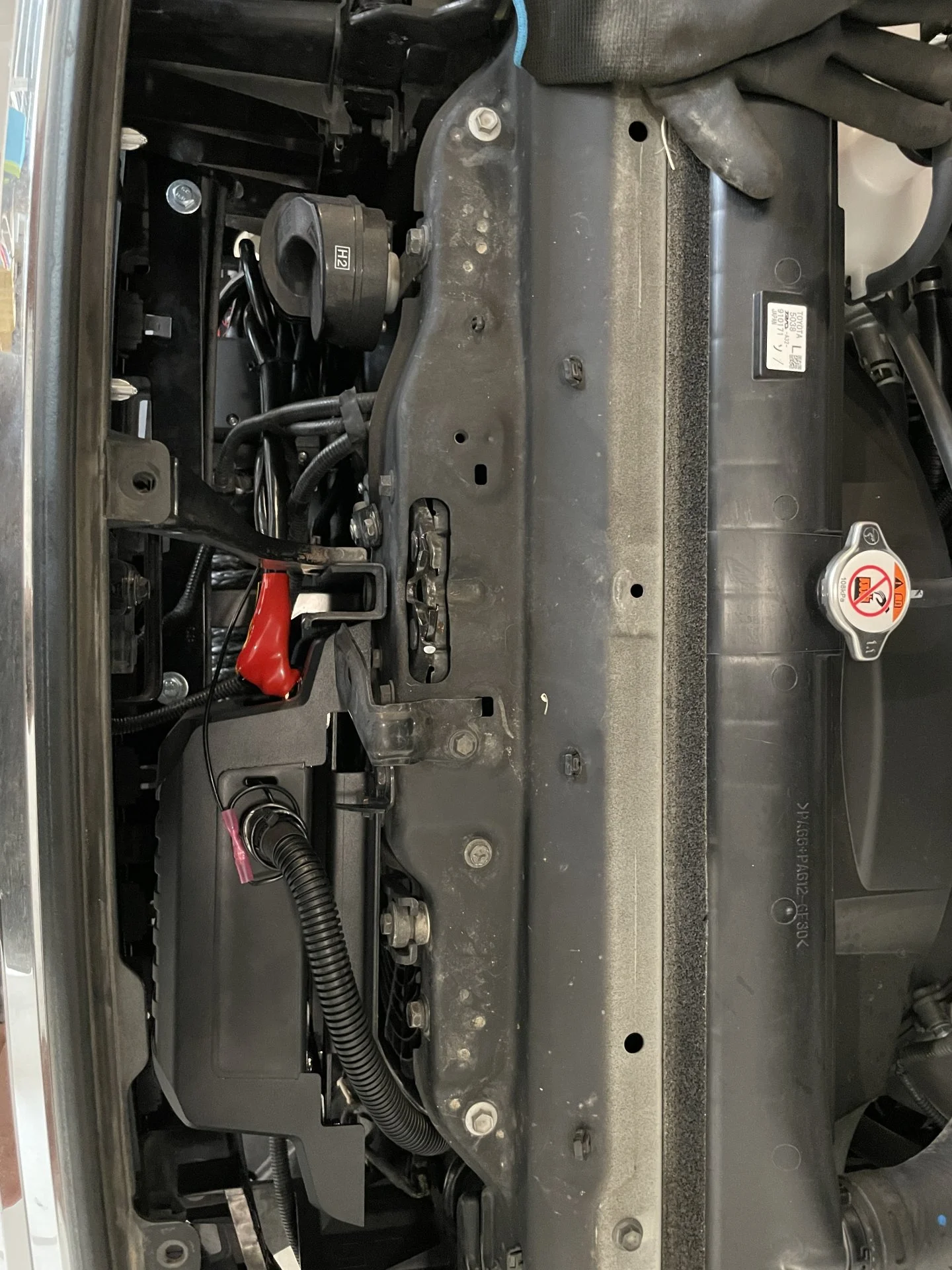

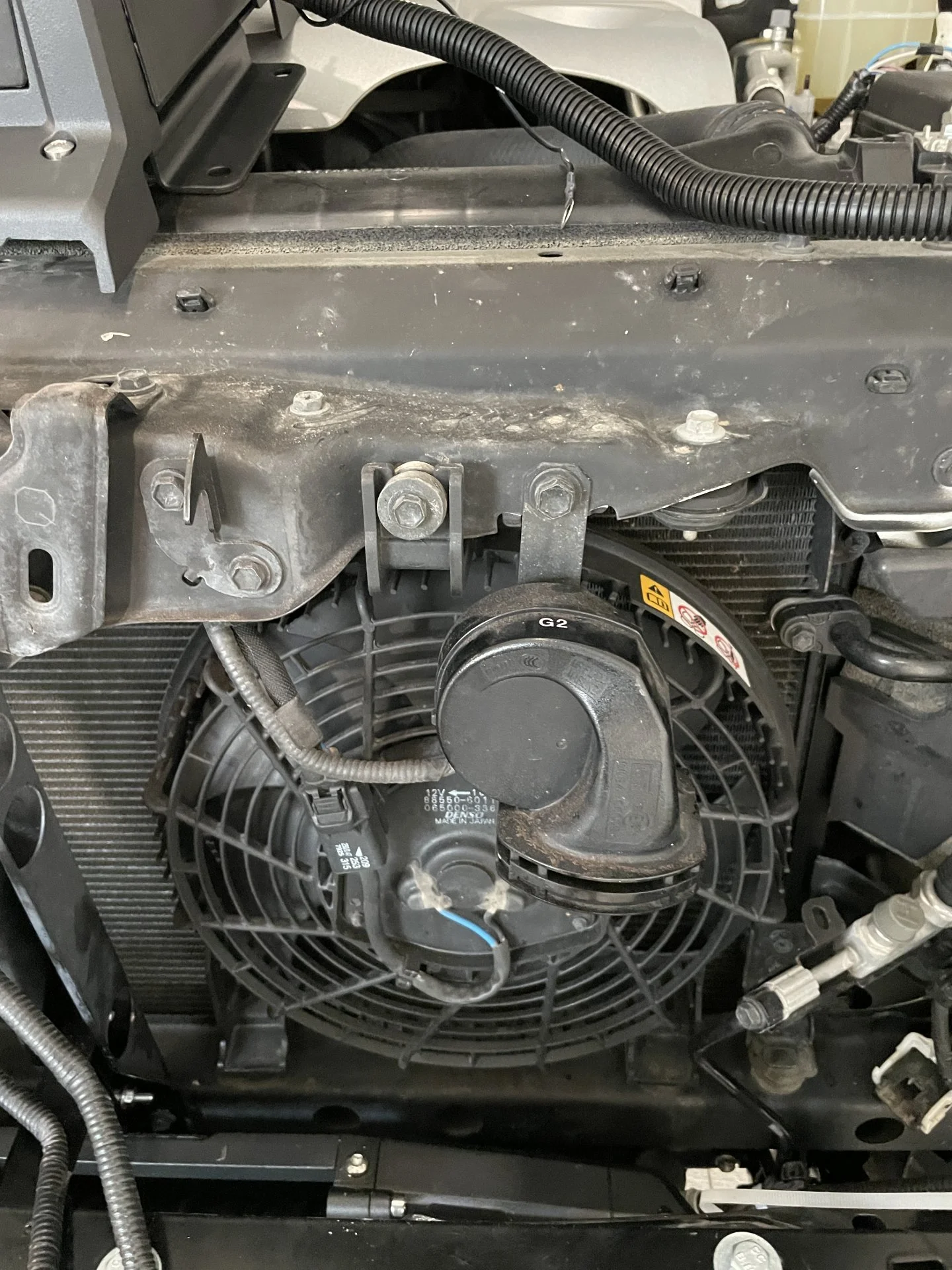

There is a lot of room behind the grille for mounting the winch electrics. I moved the drivers side horn to next to the passenger one. I can reach the switch and plug through the grille which is nice. These pics are before cleaning up the wiring so dont judge too hard. Eventually, once I finish mounting everything, I will figure out some brackets to further secure the controller, but if she does manage to come free, it’ll rest on the grille support nicely.

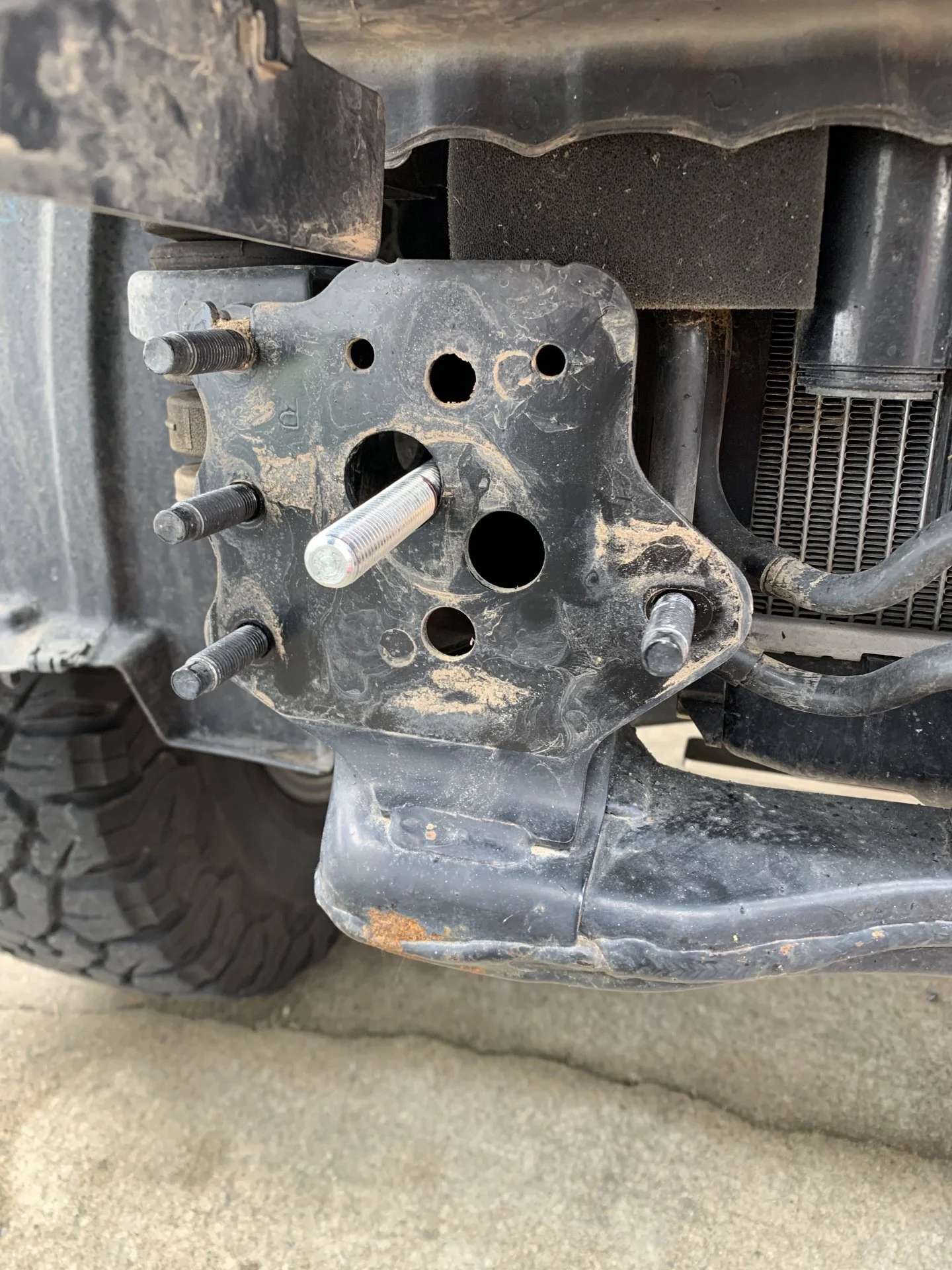

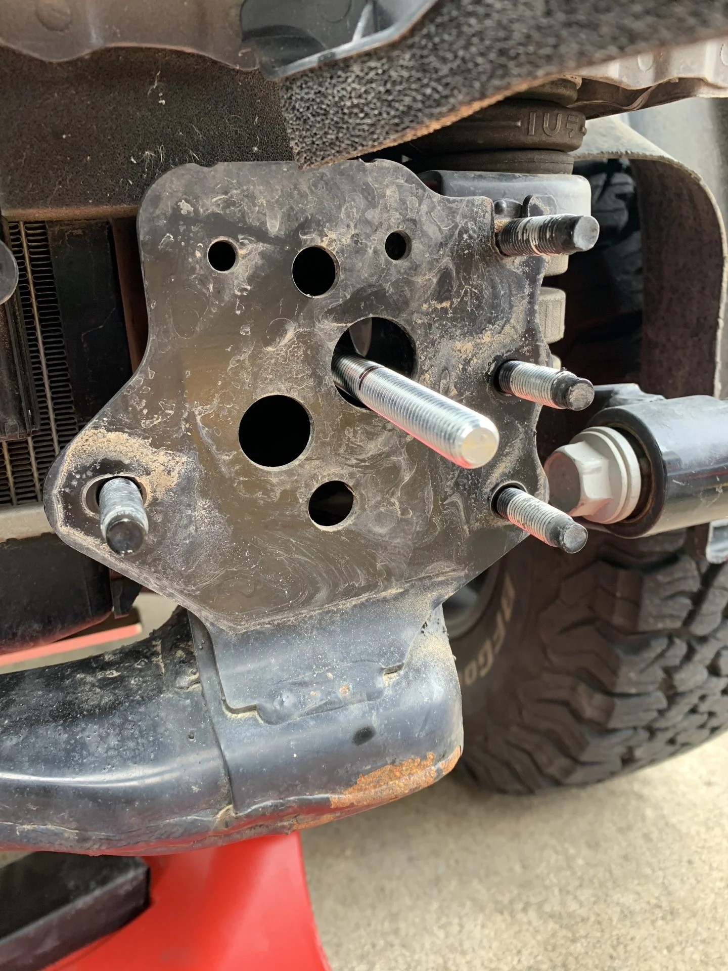

Looks like great progress - can you get a few more pics of the mounting setup from the sides of the front frame horns? Curious to see where and how it mounts to the frame beyond the aluminum crush bar's 6 protruding studs.

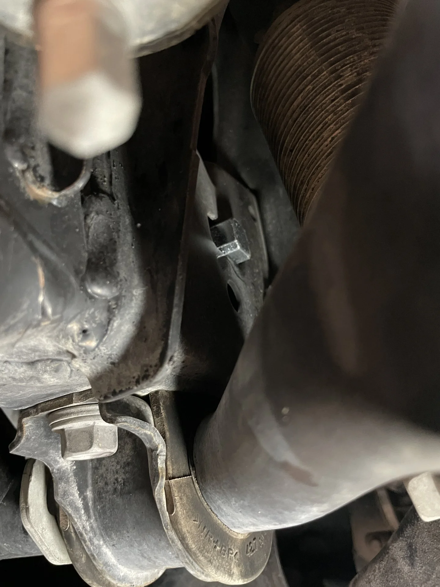

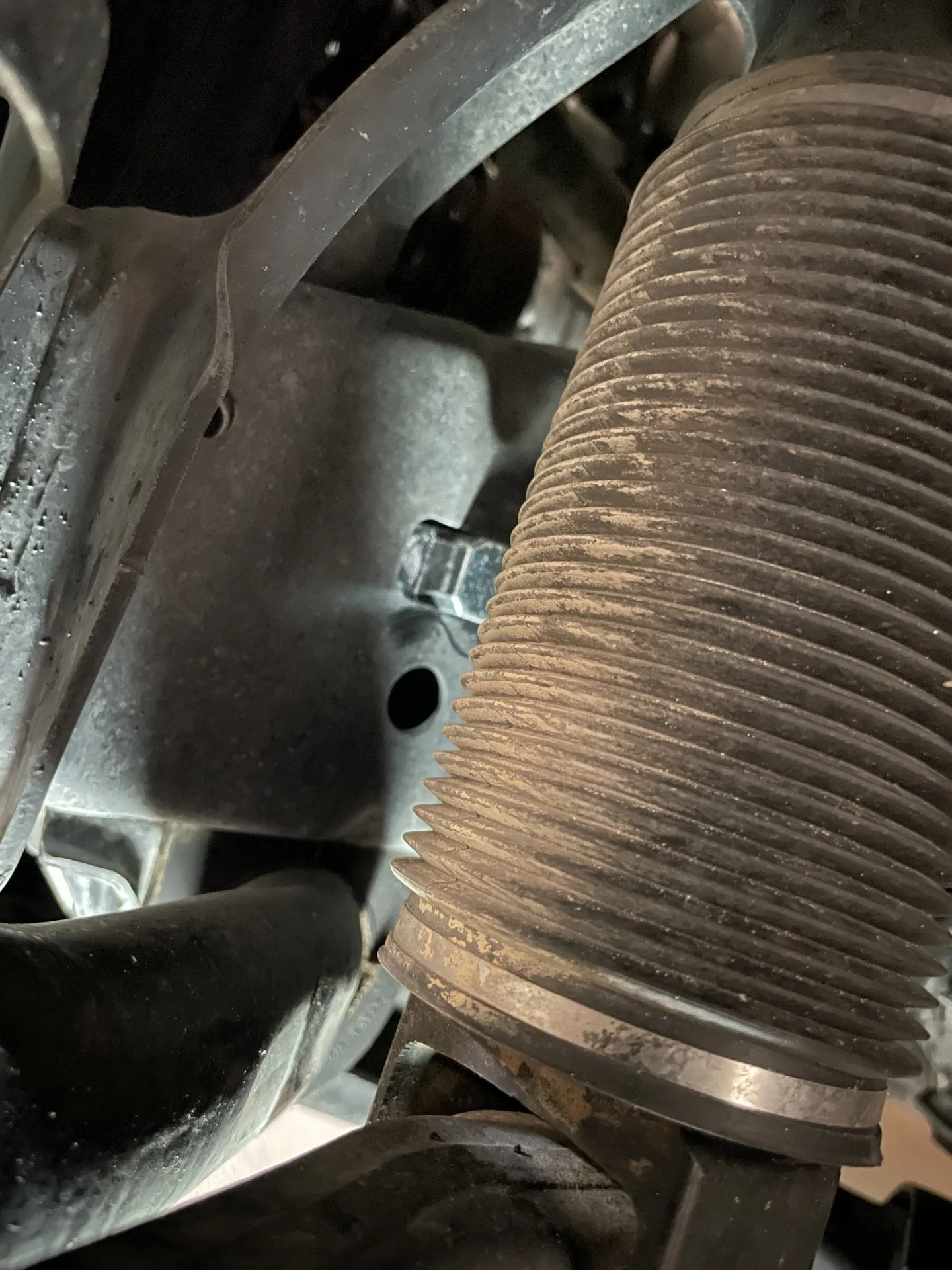

I hope gulfcoast does not mind if I post a couple of pictures from when I did my install. Here are the two frame horns that the winch cradle mounts on. Sorry I don't have a picture that shows them both at the same time.
Thanks for sharing. I’ll get some this morning if how it looks with the cradle installed.

As I recall from when I did my T13, it used the frame horn studs and the captive fasteners where the factory tow hooks/tiedowns used to mount (they are removed and not reinstalled).
On each side, four frame horn studs, the two tow hook fasteners underneath, and then the threaded rod in the chassis rail mount bar that spans the width of the frame.
