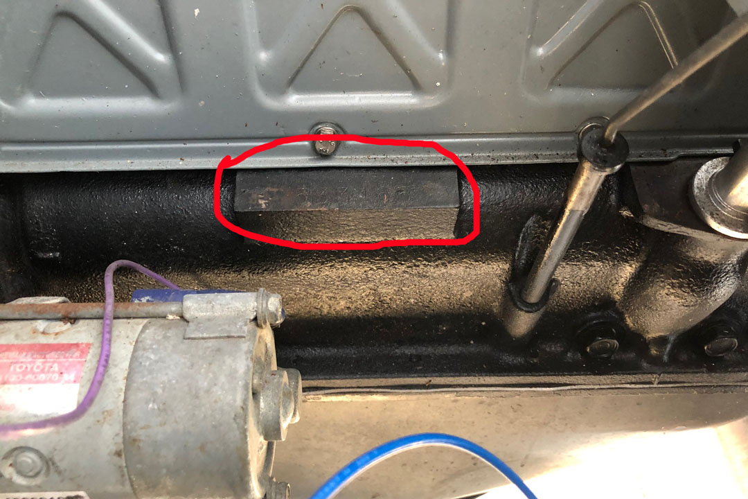

To identify your engine:
Locate, clean up, and read the engine stamp. F engines start with "F" and the 2Fs start with "2F".
The F.5 Pighead mentioned starts with "F". It's technically an F, but most every one calls it the F.5 and like he said it is distinguished by oil filter location.
I have the F.5 in my May 74 rig. Oil filter is on the passenger side and the original valve cover is steel.
I also found this sticker. It's clearly an F.
It's clearly an F
Yes. It's an F. But it could also be the F that is often refered to as the F.5. Which side of the engine is the oil filter on?
Drivers side F. Passenger side F.5
