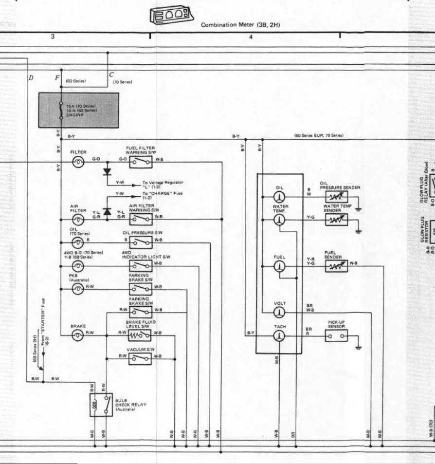

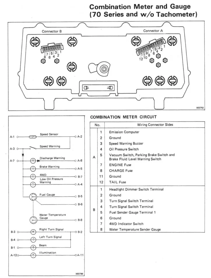

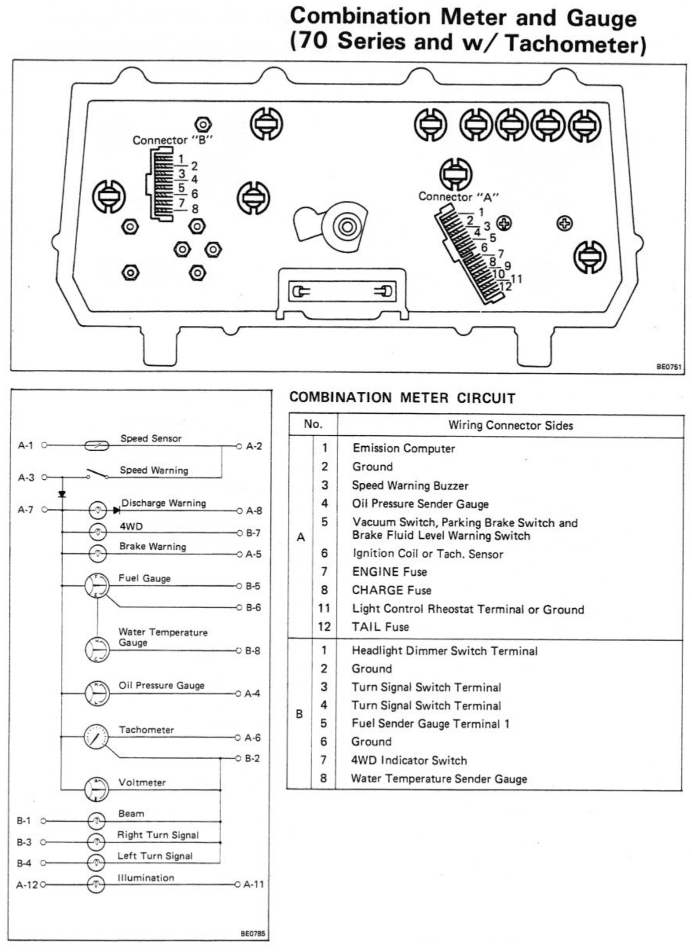

need an wiring siagram for bj73 for the instrument panel/ gauge cluster
need all the color and numbers of the wires

Do you mean the entire vehicle? Or just a section...
What year and variant are you specifically wanting?
Hi Thanks for the reply.
I'm merging a HDJ79 2006 1HD FTE in to a 1985 BJ73 3.4L NA, I need to combine the loom together.
