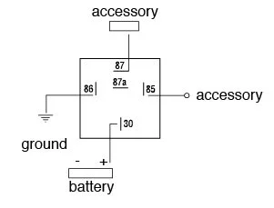

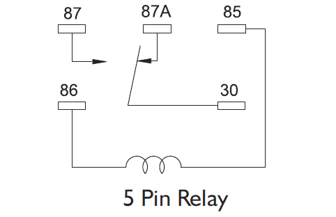

Which brings me to the question. Pretty much every relay wiring diagram you find shows the battery on pin 30 and the load on pin 87 (Normally Open). Example:
This leaves pin 87a (Normally Closed) hot when the load is not in use. I typically just de-pin the 87a wire from the pigtail so it can't flop around and short out. But that's not so easy with this unit.
I could just tape up the end of course, but electrical tape doesn't last forever. So I was thinking, why not wire it "backwards" and put pin 30 on the load side and pin 87 on the battery side. That way 87a is never hot.
Electrically, it should be fine of course. I just wonder if there's something in the mechanical design of the relay that will make this prone to earlier failure or such.
that will be fine it doesn’t matter.

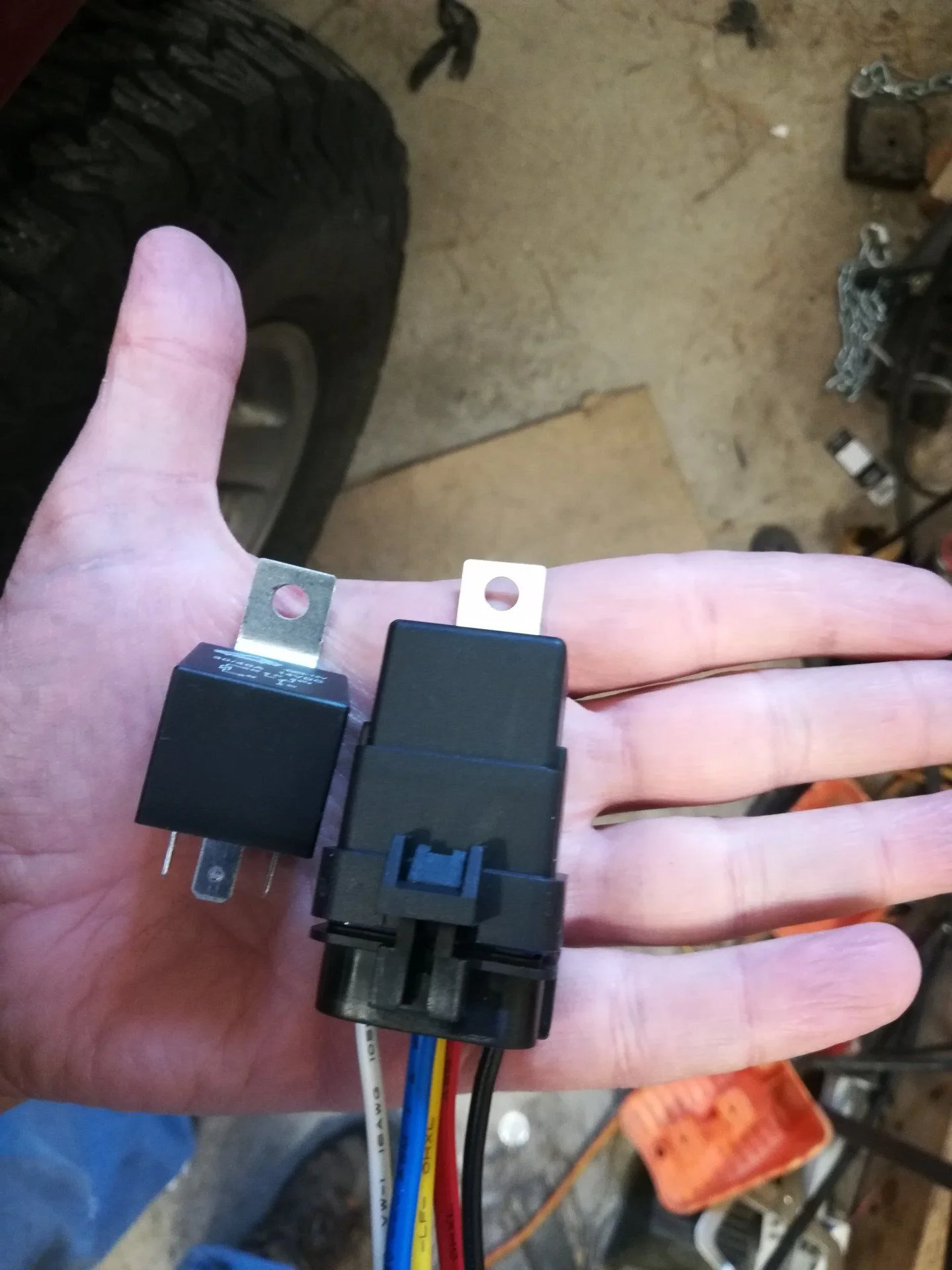

Post up a pic of what relay you chose I am interested to see what it looks like
Here you go - that's a typical 30/40 relay on the left. The 60/80 definitely has more weight to it as well. The pinout is identical - if it weren't for the shroud, the pigtail from other relay would plug in fine. So I don't have to carry anything special as a spare.

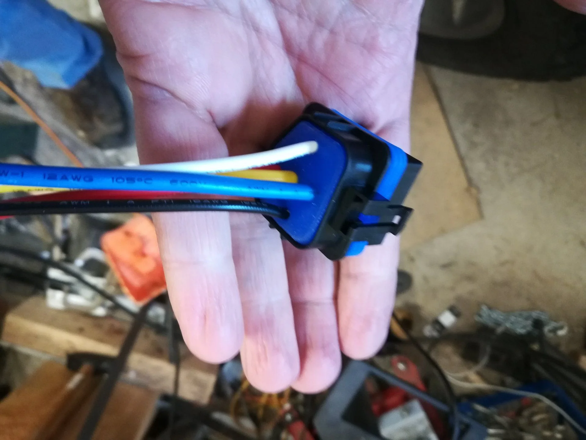

Here's the pigtail - the wires are kind of potted in that blue plastic.
