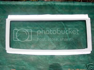

Hey Rosco,
I dont know about the build quality of the windscreen frame. Its in gelcoat. hope its a good fit.
This is it:
