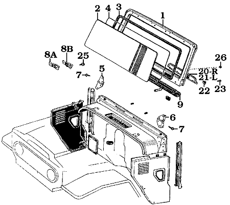

Is the frame size the same or different between '66 and '69-73? Is the glass the same or different? I'm in need of glass and weatherstripping and having difficulty trying to get answers from glass shop in my area. I did a search and apparently the shops aren't worth a grain of salt since most don't have a clue what a fj40/landcruiser is or that they were made back then or some other short bus answer they gave me....

SOR list 65-12/74 glass and W/S as the same, they sell a template for $14.95 or you could pick up whole windshield from Me to use as a template of coerce :D
The frame made changes after 67 such as wiper motors, rear view mirror, windshield hold down brackets & dash pads

I'm not sure when Toyota quit putting the "crank open vent" on the bottom of the windshield frame (directly below the windshield glass) but my 1966 had the vent, consequently a shorter windshield glass. I did have my local glass shop cut a tinted windshield for less than the cost of a new Toyota glass.
66 with the vent is smaller 69 to 73 use the same size.it might be easier to buy the correct toyota gasket and any good glass shop can cut one for you .my shop charges me around 100.00 each but have done at least 20 for me good luck

AFAIK, the vent on the bottom of the windshield frame stopped in mid '65 production year with the corrugated tops. Many '66s were '65 productions titled in '66.

If you do not have the vent, your glass will be the same, 66-74.

like Mark said based on production dates only, 66 - 1974 are the same Windshield frames
