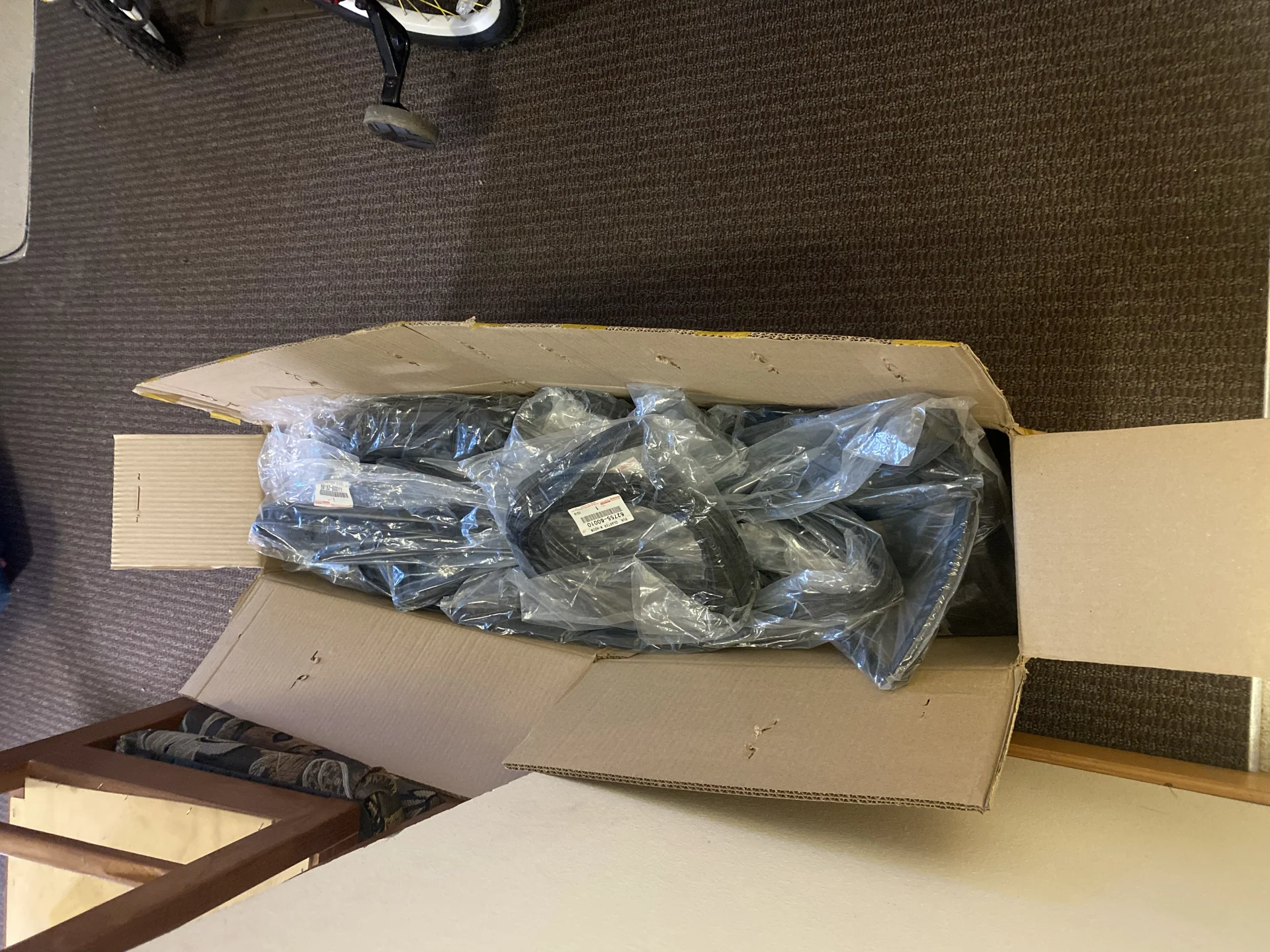

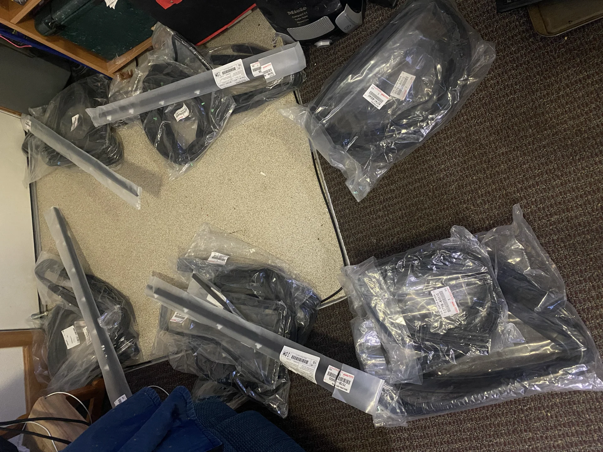

That is exactly where I was talking about. Not in the channels or anything like that. Maybe a little soapy water to help it get in there but that’s it. Not sure if you saw the picture above, but I have all the parts already lol. Everything is getting replaced. Even the small window seal on the back doors.
