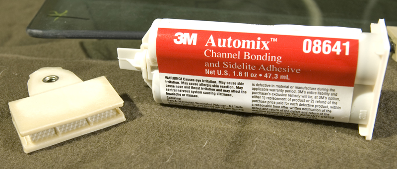

Well, access wasn't granted to the rapid prototype machine today, so I just made a new one out of aluminum. I'll post up the results once I get this new clip installed. Hopefully they are good.

That's a pretty fancy piece of aluminum work! Looks really good.
From another site - http://www.ricksfreeautorepairadvice.com - GM Sash Guides
The issue is how to remove the old clips and what adhesive to use with the new ones. Keep in mind that the side window glass is tempered but NOT laminated (like the windshield). So if you scratch the glass in any way while removing the old clips, the glass will immediately shatter into a zillion pieces. I've used a sharpened chisel and small hammer to chip away the old plastic clip. Plus, I've left a bit of the old adhesive in place for the epoxy to bond to.
3M Automix Channel Bonding and Sidelite Adhesive, 2 oz Black, flexible and durable adhesive is the one to use. It's made for for bonding moveable and stationary glass into place. Has a 4 to 5 minute worklife and drive-away time of one hour. Dispense with 3M 2 ounce Automix Applicatior Gun, part number 8191, and 3M Automix Mixing Nozzels, part number 08197.

If you or anyone else (@willflow @viclava) can confirm they went with the Napa part 665-2154 (which is Dorman #38480 from here: Dorman Products - 38480) for *both* of the clips (the forward one looks different than above pics and both of mine are broken) then yes I agree better to do once. But I am skeptical of the right dimensions/function with these other clips, and I am leery of going through the hassle to get the clips and several applicator bits mentioned above, take it all apart, somehow remove all the goop without shattering my window, apply new, put it all back together, and then find it doesn't track up and down right.

Hopefully some of the other guys will chime in, but if they don't your best bet might just be to remove the old one and compare it to the others dimension wise. Distance from the bottom of the glass to the mounting hole is really the only thing you need to make sure stays the same.
As for taking care of the glass when you swap them out: just make sure the glass is well supported and you don't put any un-needed stress on the glass, and you shouldn't have any issues as long as you don't scratch it. When I've done this type of job before (not on a LC), I carefully used a set of razor blades and an exacto knife to remove it. Didn't experience any problems.
