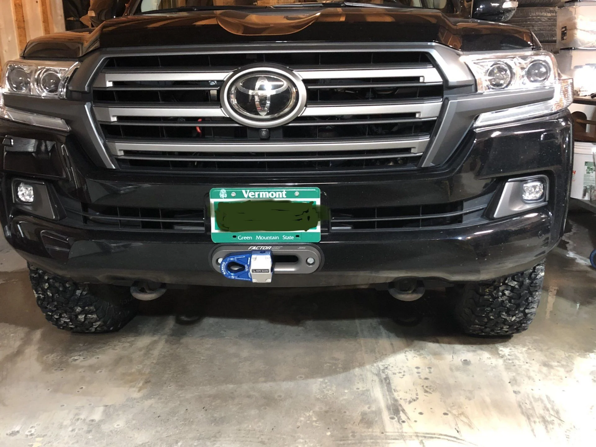

My biggest concern with attaching directly to the thimble is that it could potentially damage the relatively thin metal or get knocked loose during winching if it became sideloaded or isn’t being pulled perfectly straight. The Factor 55 flatlink protects the thimble and rope end from getting damaged, and it makes for an easy point to grab onto and pull winch cable. It also of course disallows the thimble to get pulled through the fairlead onto the spool when winching in which is important, but most of all it gives you a solid point to set up rigging where you know it’s not going anywhere. It may seem expensive, but I think the piece of mind is worth it. It’s super easy to install too, and I did a quick video of an install plus comparison of the flatlink vs the stock Warn VR12S hook here:
I don't know how much of a gimmick/marketing it is, but the whole closed systems makes a lot of sense to me. If it is just marketing, it worked on me.
You could have the best of both worlds with the Factor 55 Ultrahook. It has both a closed attachment point and a gated hook with a locking pin.
I have the Flatlink E, but haven't really tested it, so can't say whether it is good/bad or otherwise.
One reason I wouldn't leave any of these ones that attach with the pin detached is the internal circlip that retains the titanium pin. I wouldn't want to fuss around with the circlip pliers and that tiny little circlip all the time at the trailhead or trail side. I definitely wouldn't want to deal with that after something goes pear shaped.
