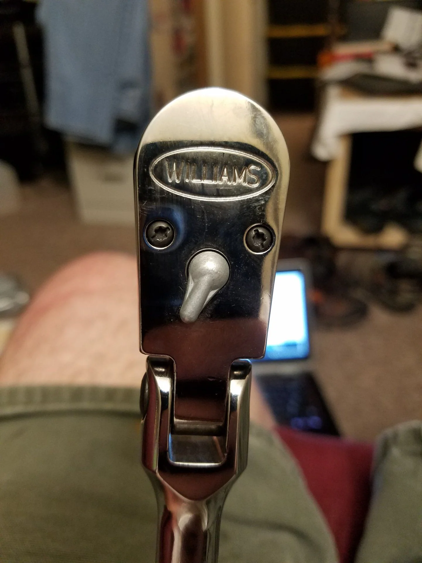

anyone know what these type of fastenors (screw-head) are called? See what appears to be a torx like fitting with a slot.
I've not seen these before and I'm wondering what they are called. This a 3/8 Williams flex head ratchet.

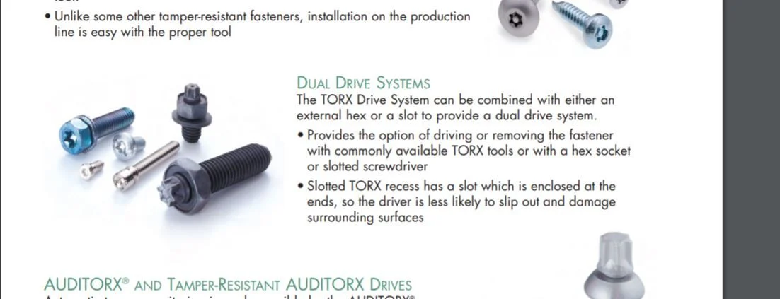

Torx dual drive. Gives you the option of either tool. Torx I guess if the farsener is stuck.
well yeah...I saw right off the bat that it appeared you could use either a torx or flat-tip screwdriver, but I was not clear that there might be some new fastener floating around, the magic words "dual drive" were not known to me. I did search for "slotted torx" as a guess but never came across any great info or the web site above.

External Torx is another name for the style fastener I see in Prairie Swamp's picture, heavily used on BMW products. I only see a Williams ratchet in the OP, which is a high quality piece just as good as Snap On.
I think the small silver torx screw in the 2nd picture is similar to what is in the Williams ratchet, on the left hand side of the pic. I have more than a few $$ in Williams stuff, I just never paid attention to the fastener until the other day when I damaged the detent ball and needed to look at the details a little closer in case I need to take things apart. I like the ratchets, wrenches, sockets and a few other things I have from Williams.
T-8 torx works on this, see above picture.
