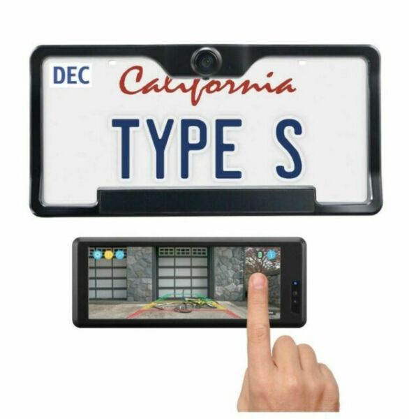

I know not at all the same, but I recently picked up one of these from Costco and am blown away how much better the quality is compared to my 2008 camera.
My issue (apart from the quality) was my dual swing bumper blocks all but a narrow lil center view. Quite a few guys on here pulled the hatch apart and moved the backup camera to the swing arm. Personally that looked like a lot of work to still have the same old 08 quality. This bluetooth option, had a lot going for it.
The Pro's:
• 720p (sounds low by todays standards, but light years ahead of the factory resolution)
• 5 minute setup (actually took 5 minutes)
• the camera has solar so zero wiring or charging
• Completely reversible if I ever want to take out could do in 5 minutes
• Nothing tapped into any of the factory electronics
The cons:
• Because it's not at all wired to the system, doesn't automatically activate when you switch to reverse. easy enough though, you just wave your hand in front of the screen to turn the monitor on
• Monitor needs 12v power, so I had to neatly tuck a cable from the dash/monitor to the cig outlet
Otherwise, pretty nifty solution for under $200. I think i got the idea from @Markuson several years ago but just never moved on it. Then my neighbor was bragging about the Costco deal and the solar power so I took the plunge.
Again, I'm aware this is not in the same ballpark of a tesla style screen and new camera, but under $200 and easy to undo. Win win for me

Yeah on or off whenever i want is a handy feature, something I didn't even think of before.
I tried dash and windshield mounts, and everywhere i placed it annoyed me and blocked vision and had a sloppy looking power cord. I was ready to return to Costco, when I found that magical perfect "passenger A-pillar" location, which is super easy to hide almost all of the power cord behind trim pieces going down under the glovebox and coming up where the passenger left knee pad is. Doesn't block any visibility and looks neat and clean. 1 other thing i may try in the future is with my particular model you can pair 2 cameras to it, so that'd open up the option for us with earlier models to be able to add a front camera as well for wheeling.

Mine is just a license plate frame that has integrated camera and solar, zero wires.
