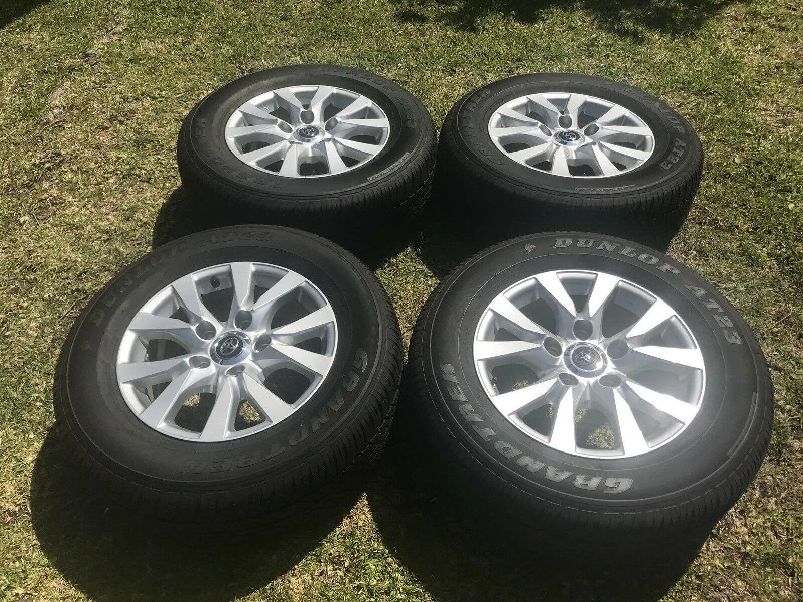

Will 18" 2018 Landcruiser wheels fit my 2003 LX 470? Thanks

Bolt pattern is the same 5x150mm and 14mm studs. I believe there was a difference in the hub diameter between 100 series and 200 series. You can search for it.

The only variance I can find online is the offset: LX470 is 60mm, the LC is 55mm, but I think the only issue would be the center cap and the plastic tabs could be shaved ot fit....I'm just trying to confimr that is true... thanks.

they will fit. the center caps will not up front. Like @SDNATIVE18 stated the hubs are different style.
with the way the center cap is on the 16+ LCs, I believe you need to run spacers for the front from what I have seen or need to shave the center of the rims off the 18. The hub is different on your 100, it will be similar to whatever you need to do to fit RWs. So might be worth checking that in the 100 section.
I brought my 2019 Landcruiser wheels to a local Toyota dealer to have them installed on my 2003 LX470 and....the Toyota mechanic said I need 1 inch wheel spacers no doubt, now I'm wondering what type os the best for the vehicle. Any thoughts?

IMO the best place for accurate spacer info for your vehicle would be the 100-series section. Your different hub might pose different requirements than we are used to on our 200s.

That thread should answer the question for you if you haven't seen it yet
