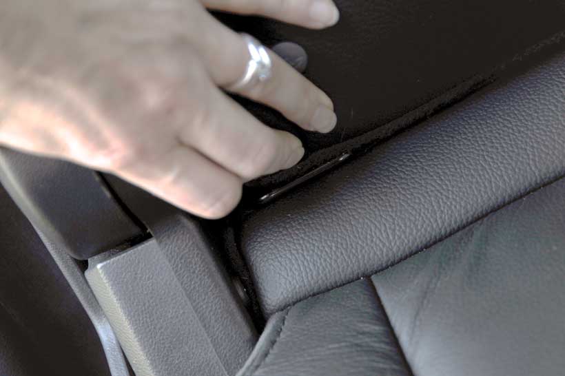

When we moved up to forward facing seats I found that the Evenflow Tribute car seats used metal hooks that are intended to connect to the latch system. I was able to use those metal hooks to connect the evenflow seats to the 80. On the inner side of the kid seat I used the hook around the loop on the short end of the seatbelt. The female end of the seatbelt has the webbing looped and stitched over the socket/receptacle for the seatbelt and you can use the metal hook from the car seat to connect to the webbing loop on the inside edge of the kid seat, which is very secure. On the outer edge of the seat I would mount the metal hook over the bottom hinge plate. The third, top strap goes under the headrest and down to the floor anchor in the rear cargo area behind the 2nd row seat.
I should point out that with the evenflow seat metal hooks you have to put the metal hook in the correct place on the 80's seat hinge plate so that it doesn't slip off. You also need to orient the strap in the correct direction so that you can pull the tensioner and get the seat really tightly mounted. I would use my body weight to push the kid seat down into the cushion of the car/80 seat while I pulled the slack out of the lower retaining strap. Once the lower strap was tight I would add the third strap over the seat back, to the floor, and just snug it up but not make the 3rd strap too tight. From there you wiggle/shake the seat around and see if it loosens up, then repeat until it stays secure even with pulling/pushing on the seat. If you pull too tightly on the 3rd strap then you tilt the seat back and push your kids feet forward. This doesn't matter as much when they are small but is more relevant when they are taller.

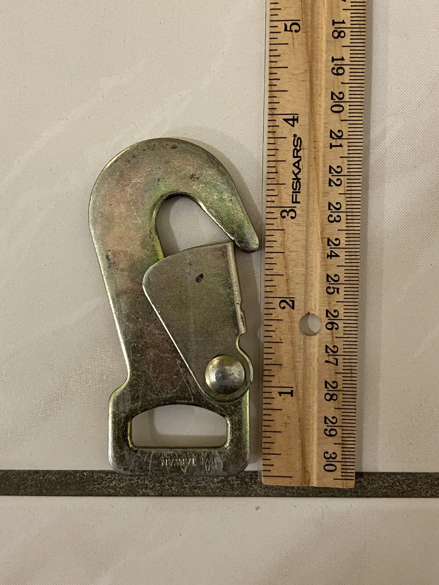

My kids came home on their first ride in the 97 LX450. I researched LATCH solutions and ended ordering the tether anchor adaptor that was sold by Canadian Honda. It was just a cargo hook that hooks into the seat latch post in the floor to form a tether point. I used this in conjunction with the Might Tite to mount the forward facing seats.
If your wife insist on the official tether part, I still have this tether hook that I pay some serious $$$ and shipped in from Canada. Drop my your mailing address and I'll send it to you.
