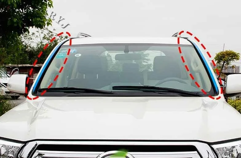

Dealer / installer messed up the clips that hold the brack tirm in place. Remove it and order OEM parts or try to glue them down? They tend to pop up at highway speeds.
I’d try getting the disposable plastic clips first. If they messed up the attachment rail on the black metal/plastic side trim it is somewhat malleable and can be bent back into shape, then the new clips will hold them down well.
The one extra part that might need addressing is a metal clip that gets epoxied to the body of the vehicle at the top where the side trim levels out and runs along the roof in the channel.. if those are torn up or have been pulled off, they may need replacing (not expensive) and to do it right you need to find flexible epoxy to reattach. Some installers just use urethane under them but it doesn’t bond nearly as well.
Note that the disposable plastic clips are very difficult to get off the rivets into the body.. I had to cut mine off the rivets to make room for the new parts.
Installer did that on mine as well. The trim stuck up and was visibly not touching the windshield. They asked if I cared... I said yes. They ordered and replaced the clips.
