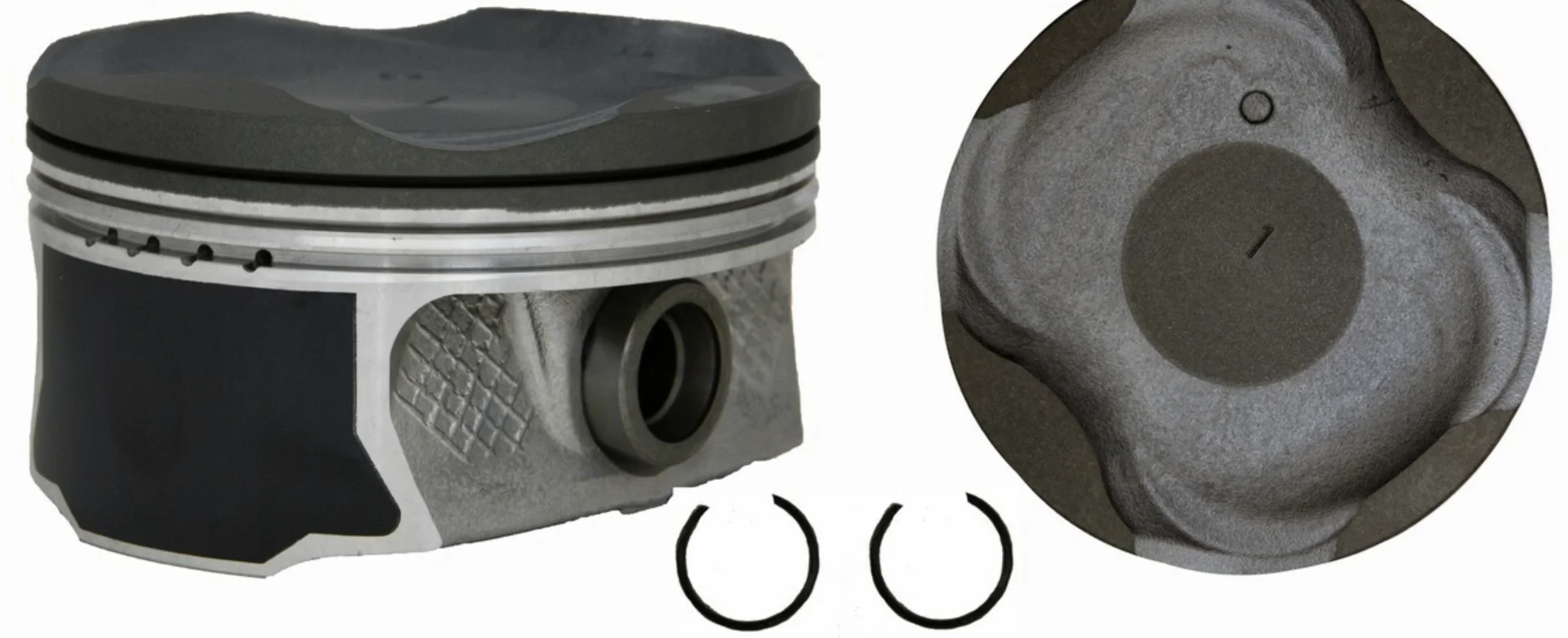

Nice video leading to a clear explanation why changing oil timely/frequently is good. Challenges 10k intervals depending on use (lots of shorter trips like probably many of us do, towing etc) and conditions (low outside temperatures). I can see our 3UR-FE does not have these low drag piston rings given the era it was designed in (and the MPG it gets...), nevertheless the oil ring needs to move and comply.
Added a link to a nice explanation of various piston rings involved.
And picture of a 3UR-FE piston. Note oil return ports.
P.S. AMD is a Toyota Master Technician. He seems to have good knowledge, certainly experience and I like the way he explains things providing some confidence. He has a good one on the Land Cruiser 200 itself, as posted in another thread on this forum. By the way I have had Toyota change my oil at 5k and 10k to date. Will stay the course with 5k changes and look forward getting past 36k miles warranty to start changing myself.

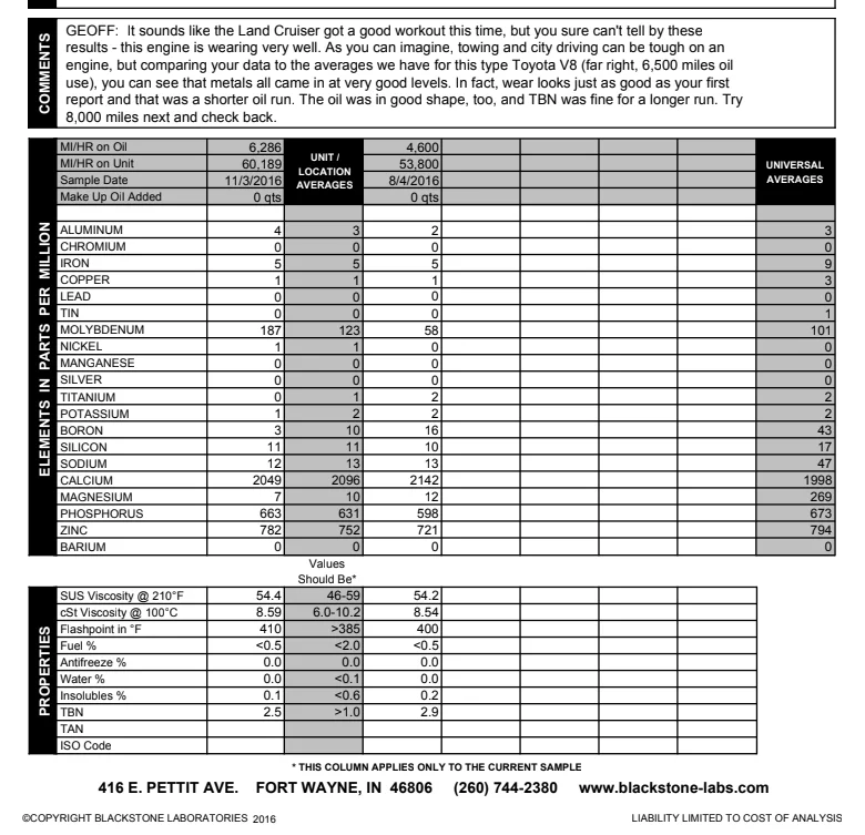

I've sent in oil samples to Blackstone where I've towed in 4th gear for 4000 miles and then spent the remaining 2000 miles in heavy city traffic on my lifted and armored truck and they said "oil looks great, plenty of TBM left, run it to 8k next time and send us a new sample". By rights the above should've been a 5k oil change but I did it a bit over 6k because I was on a trip, yet they said it could've gone 8k. For normal suburban and highway driving 10k is fine, and you can likely stretch further without any harm.

I had Blackstone do a TBN analysis of my oil. I drove 6300 miles in the oil change. About 20% of those miles were pure city driving around Chicago (first 1k miles), where you have a stop sign every block (and it's 8 blocks per mile). 60% of it was on the highway doing 75 in 4th gear (revving 3000-3500 RPMs constantly) while towing a 6000# trailer, going from Chicago to the Badlands, Devil's Tower, Yellowstone and Grand Teton and back (about 4k miles). The remaining 20% was driving around the national parks once we got there. I'd call this pretty heavy usage which Toyota would say do to an oil change every 5k miles, but the TBN analysis shows the oil had quite a bit of life left in it, and Blackstone said "try 8k miles next time".

Thanks for posting. This makes me feel better about my approach. I usually do every 5k, but am not religious about it. To my way of thinking, oil changes are cheap and if I ever have to do an unplanned road trip, I know my oil is up to the task versus being due an oil change at 10k and also needing to hit the road to drive a few thousand miles. Drive across the country and back towing a trailer - oil change before and after. Otherwise I have gone longer, but don't wring my hands about it if I find it's been 6 or 7k.
