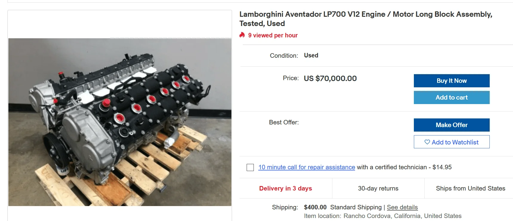

I did find this funny...very reasonable...

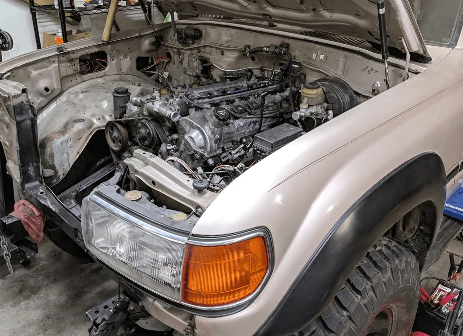

A friend of mine is swapping the v12 from the Toyota limo, or what the Japanese Yakuza use as a limo into his early 80 series.
Definitely fits. Bellhousing bolts directly to A343F. Had to relieve the firewall a little bit & chop the air handler.
Expect a real build thread in about a year when I have something significant to show. Going to cook up some real weird stuff.
Jus
o_O Just..... Damn. When I started this thread, it was kinda a joke... can't wait.
