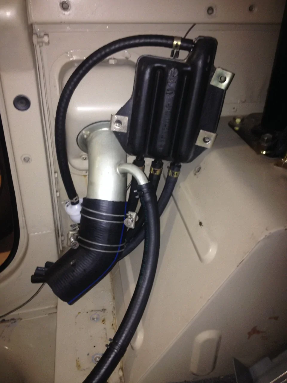

Should a properly vented factory 77 tank make a whoosh sound when you remove the gas cap?
Also getting a buzzing noise inside cab coming from the area above tank where all of the vent tubes run. Will buzz about 10 seconds then quit. Happens randomly while driving. Any ideas?

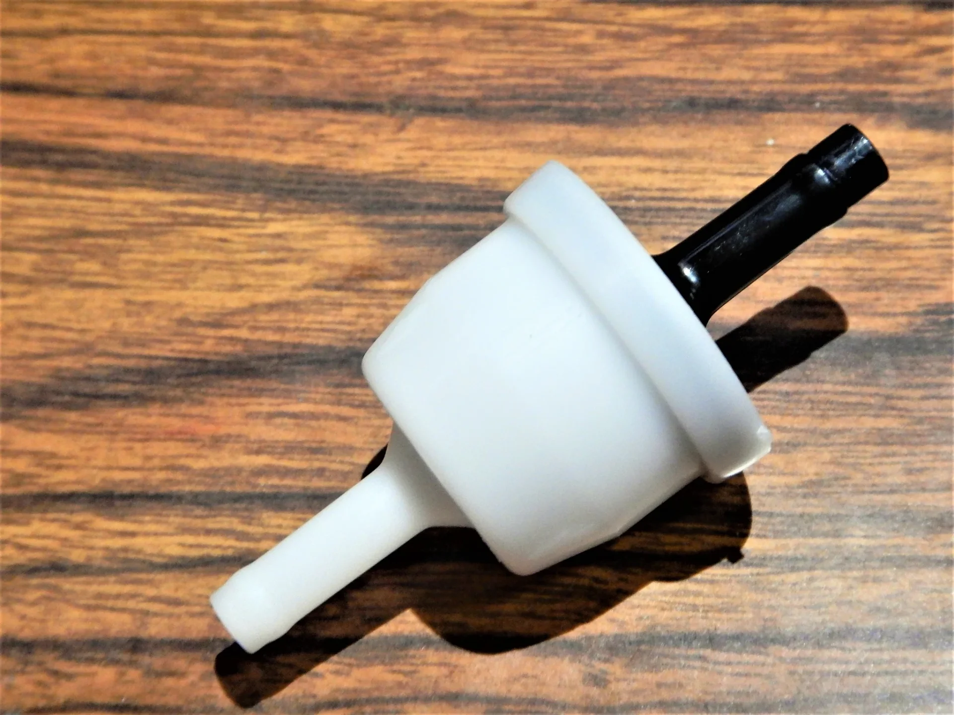

I had a skidoo snowmobile with 1 way valves for the gas tank venting and one was bad and made that identical noise.

No In tank pump. I’ll replace the one way valve and see if that’s the culprit.
this one way valve ?
- you never mention what direction the " WHOOSH is going or coming from ?

Yes that one Matt. Woosh sound is when taking off gas cap. Guessing pressure built up inside?
