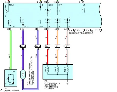

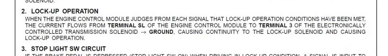

the green and white wire seems to be correct from the 1993 EWD ECT section:

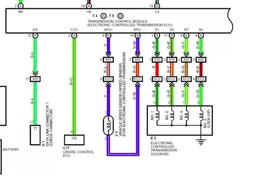

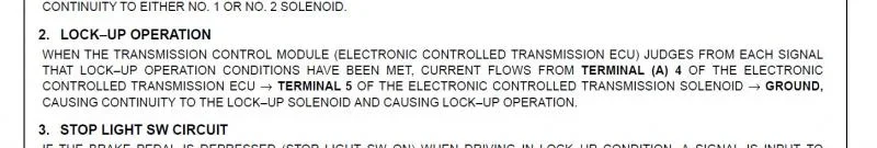

From what I can tell the a343 uses a different color. From the 1997 EWD:
Can you purchase the electrical connectors for the engine harness individually? If so it looks like you could build a jumper with the relay on the correct wire and snap it into the EC2 connector to avoid cutting a wire.
