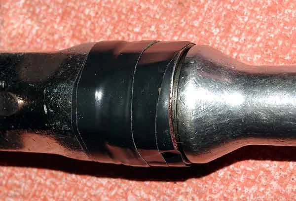

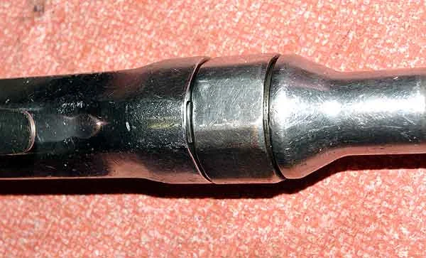

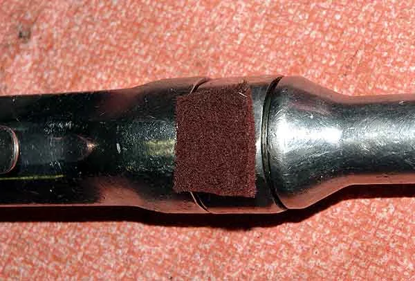

For old school design ratchets it's easy, the exhaust is in the center of the tool. Cut a piece of scotch-brite and tape/shrink wrap it leaving the far end open, makes a big difference. This one is an old blue point, no it wont help with the bloody knuckles!:D

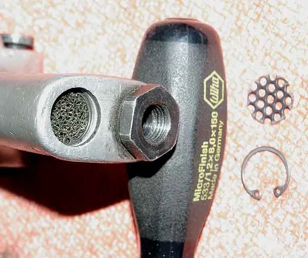

The IR-212 3/8" impacts are dead simple. Remove the snap-ring and exhaust screen, insert rolled scotch-brite or in this case open cell foam and reassemble.
Scotch-brite and open cell foam work well, cloth will pack down and reduce air flow/power. All of it eventually gets dirty/clogged and needs to be cleaned/replaced.
