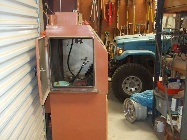

Here is what I have. I upgraded to the Stainless Steel Cabinet.
Here is there website.
http://www.adfsys.com/Product_Index/glovebox.html
Looks like a nice shop you have there sir. Got a better pic? Where did you pick up the enclosed parts washer? How much?

At first I thought you posted a pic of your blasting cabinet. I like that!
That looks like a blast cabinet to me ;)

I needed a parts washer that would comply to Ca laws. The standard Stoddard solvent or the mineral spirit tanks are fine for at home do it yourselfers but in business you cannot use them since they are not cost effective. Safety Clean charges $175.00 per month the maintain that type of parts washer. They don't care if it is a 20gallon or a 50 gallon.
I researched and found a few companies made what I needed. I settled on an ADF since they are build in Iowa. They use water and non foaming soap. What every you use in your dishwasher is just fine. They have an oil skimmer on the back to keep the water clean. They have a built in heater as well. I had the cabinet built in stainless steel since most of them I have seen were rusted out.
When I left the service area to fine tune a new department the next two service managers never used it. They though it was a sand blast cabinet.
I was able to buy it from the company through a scrap request 7 years after I initially bought it. Original price in 1995 $6,800. Scrap request price in 2002 $10.00.
