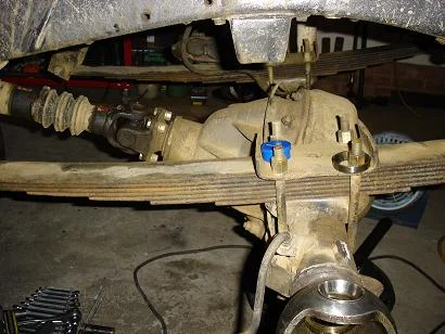

    Pictures to help. I got bored last night so i went ahead and cut mine.
    1: Point pinion at t-case
    2: cut knuckles
    3: rotate to 5* caster

    A picture says a thousand words. Now I understand. was the 5 degrees the original stock position? And what did you use to cut it with? And did you use heat to turn the knuckles? Did it mess up the bearing races.
