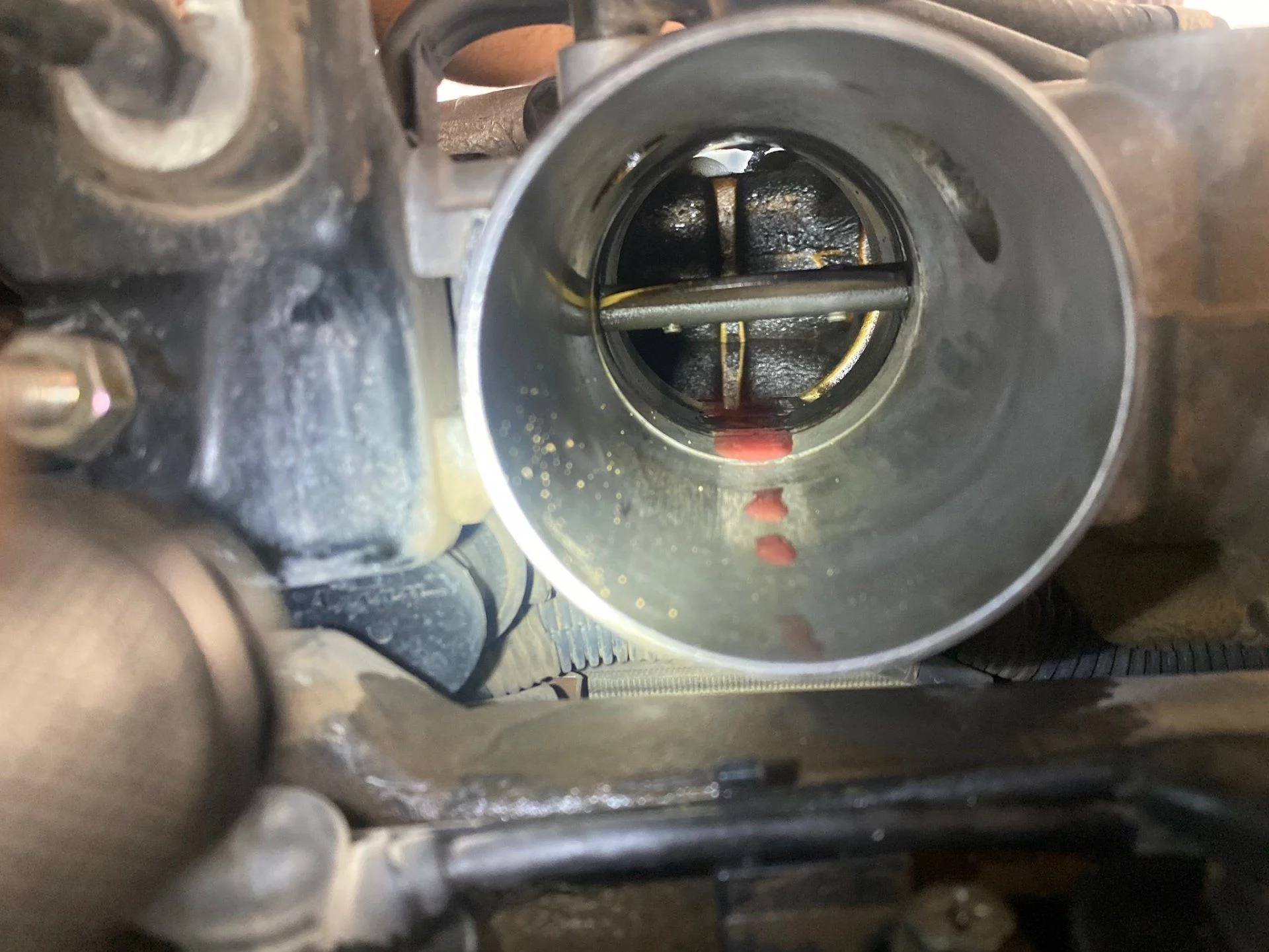

We have an 80 in our shop right now which failed on #1, filled the intake and exhaust with coolant and tried to hydrolock. It was pushing a LOT of coolant into various parts of the engine. So much that it left a pool in the intake manifold, visible when the throttle body was held open.
