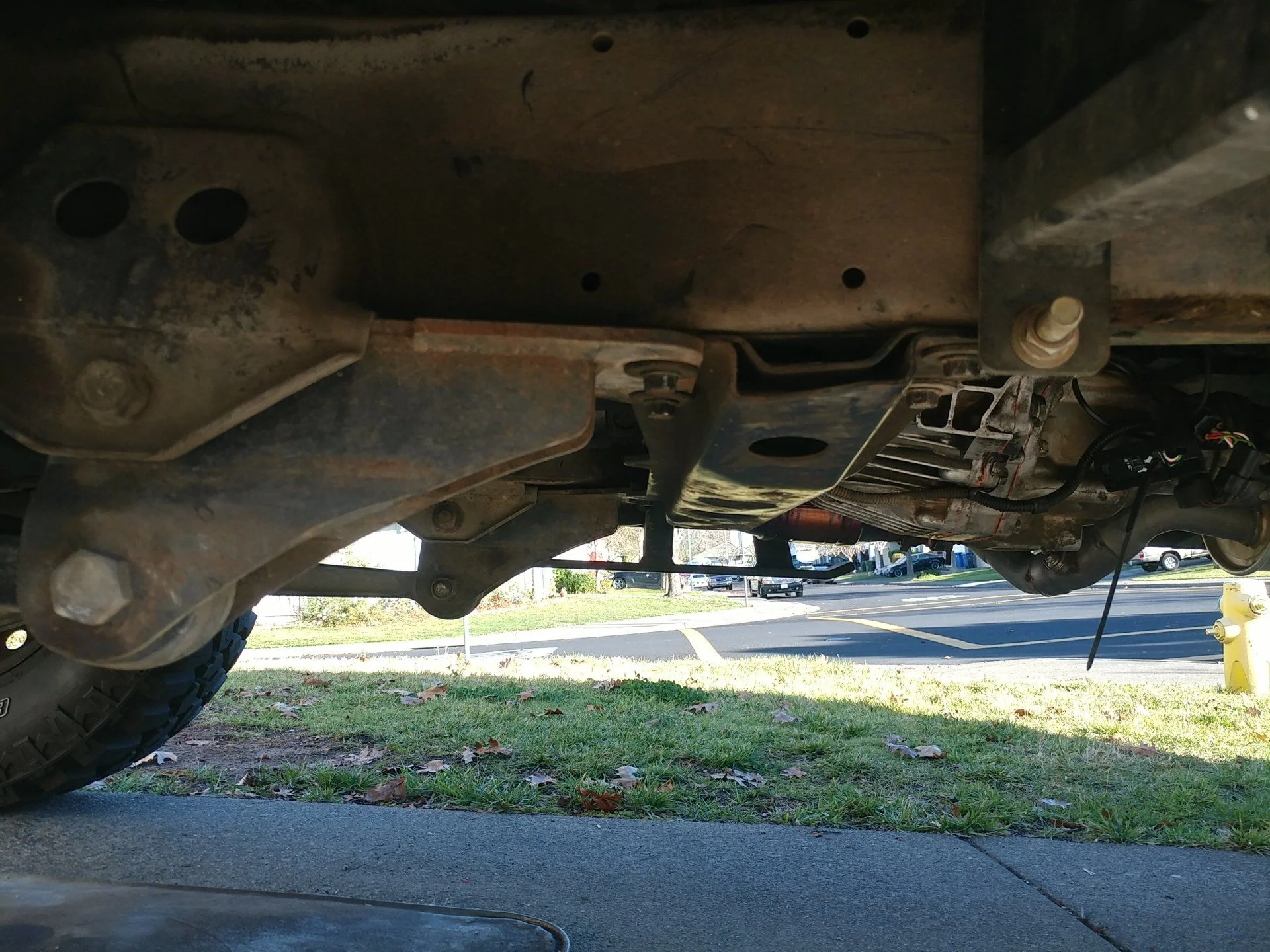

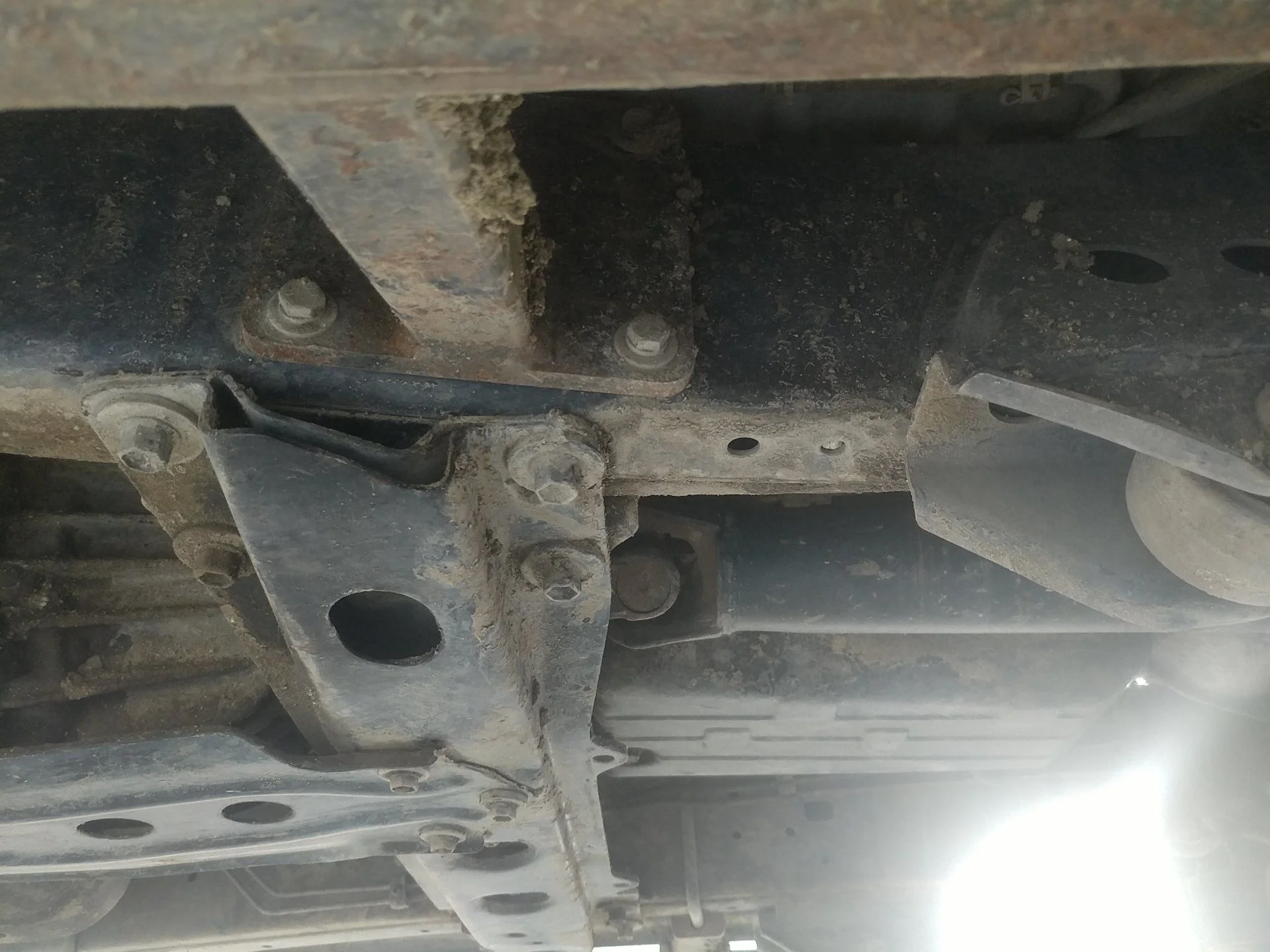

Hey Guys,

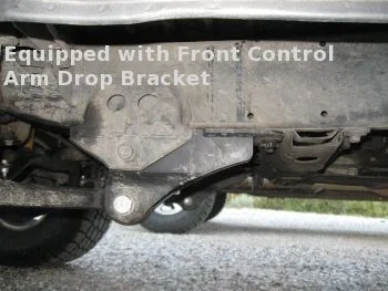

Does anyone have a photo of where the front of their WK Sliders mount on the frame? I can't find any pics online. Well, I found multiple pics of middle and rear mounts but not the front. I'd love to see both their With Radius Drop and Without. Post up either.
I'm currently planning/building a crossmember/skidplate combo for my H151, which sits about ~2.5" forward of the auto transmission and wanted to see how much conflict I would get into with my as-yet-unordered sliders.
Thanks!

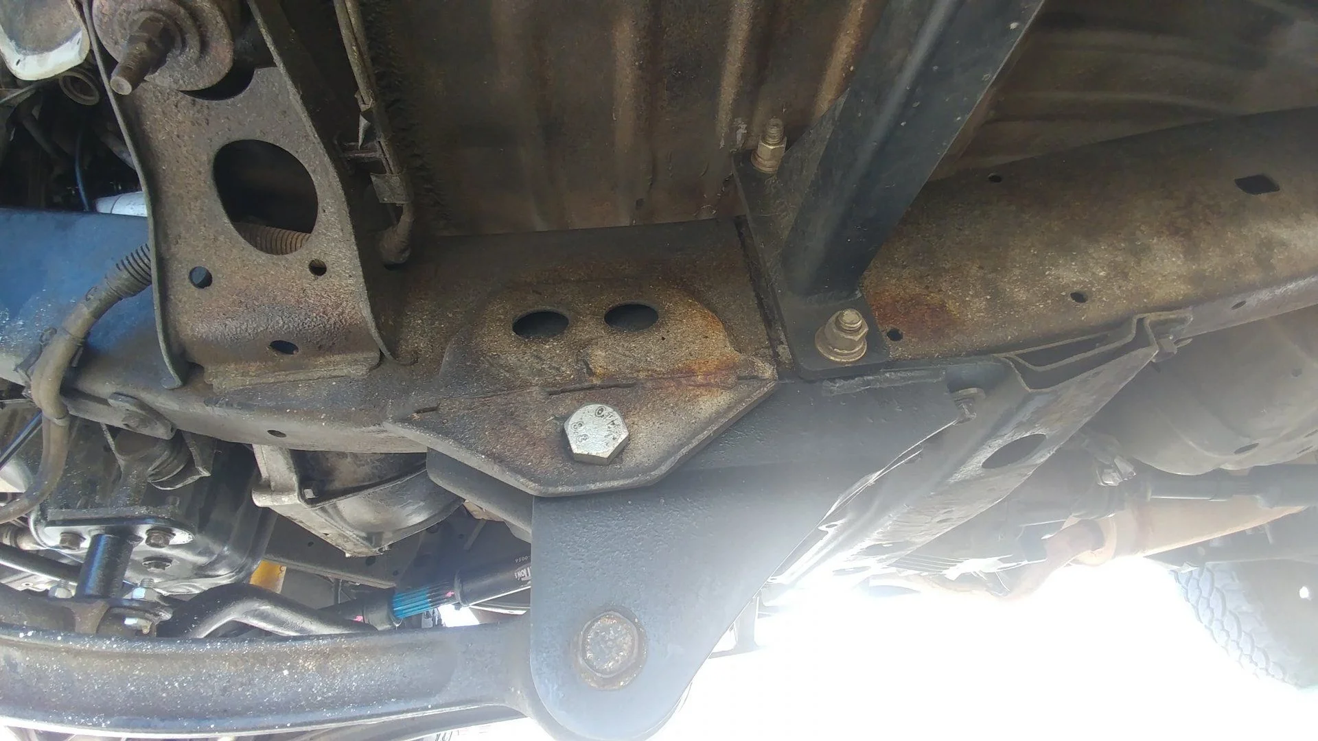

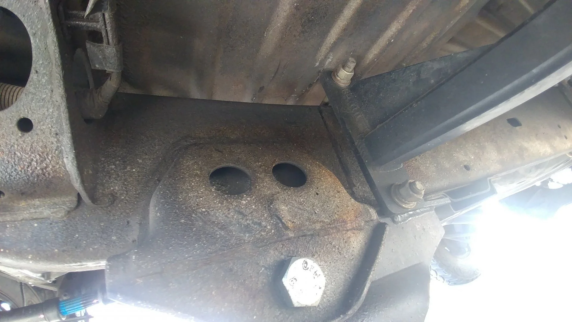

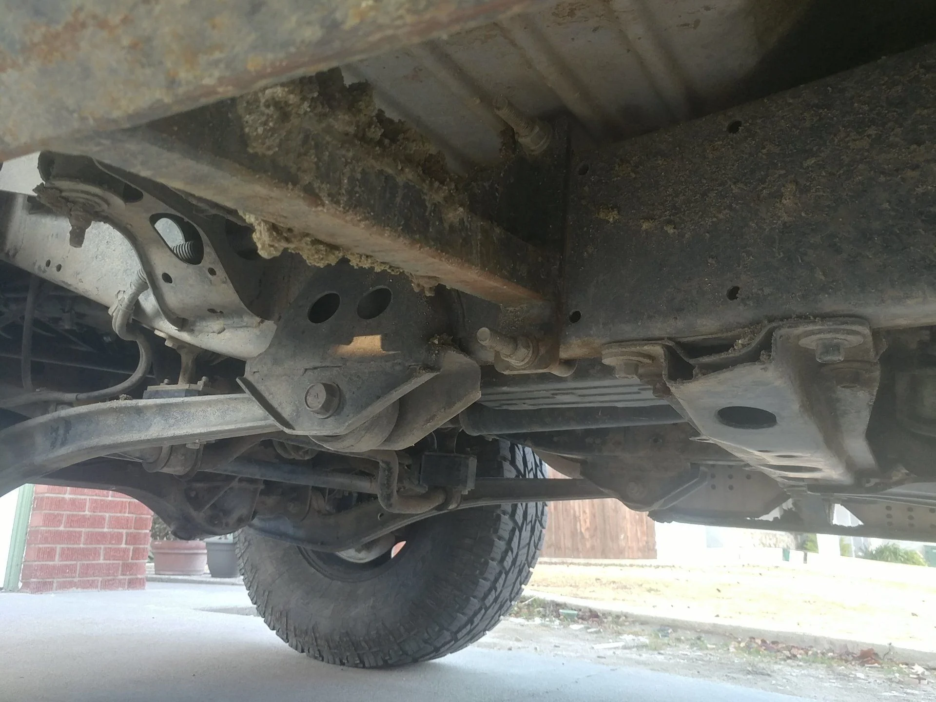

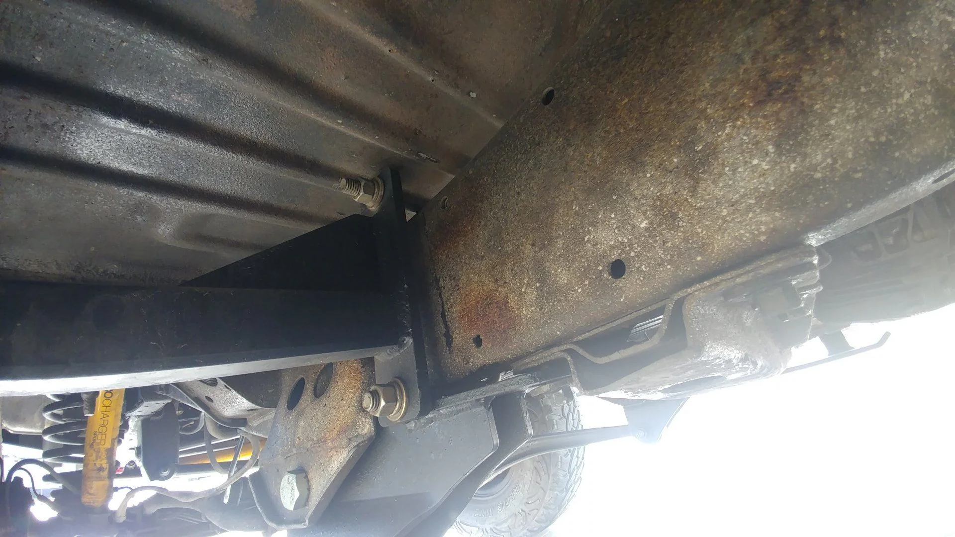

Just took these, lmk if you need something else

Awesome. Exactly what I needed. Thanks! As expected that’s exactly where the stock manual transmission crossmember bolts in. My custom version would have to avoid that.
Does anyone know where their kit for Radius arm drop brackets bolts up? Their photo shows the drop bracket covering the bolt-on location, but not where their sliders mount in that scenario.
