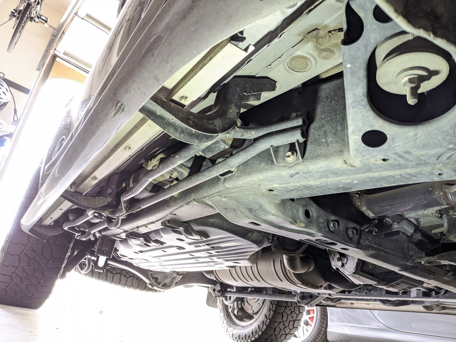

^Can you take a picture of the slider foots for us to see how and where they mount? I can take a picture the AHC equipment in those areas.

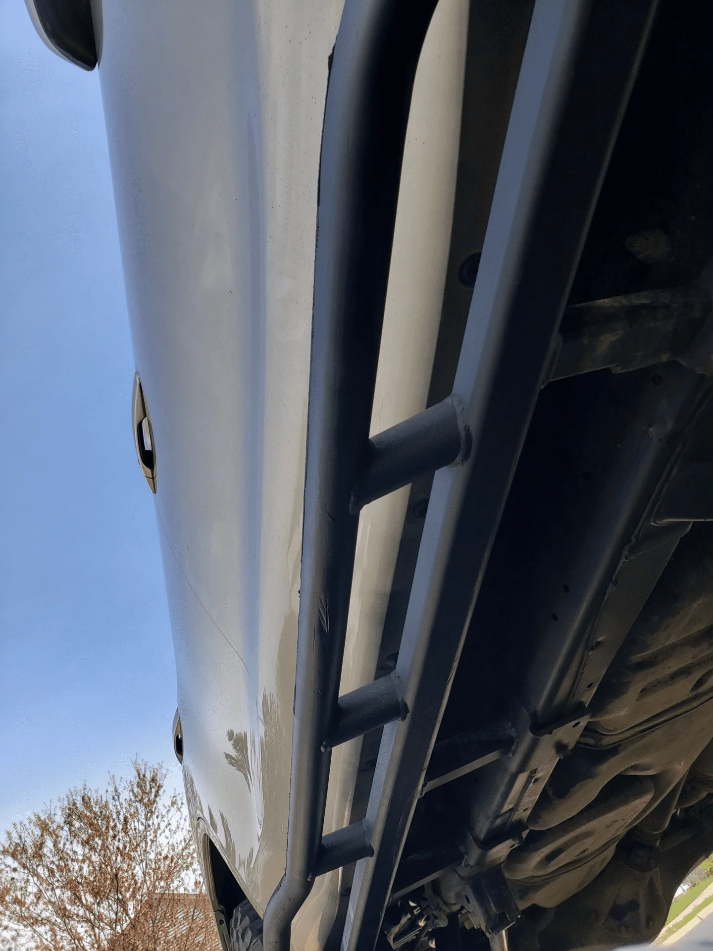

Not the best picture for you. But this is the layout of the White Knuckle arms on passenger side. Pretty much identical on driver. I can see if I have a better picture, won't be able to take any for you until tomorrow

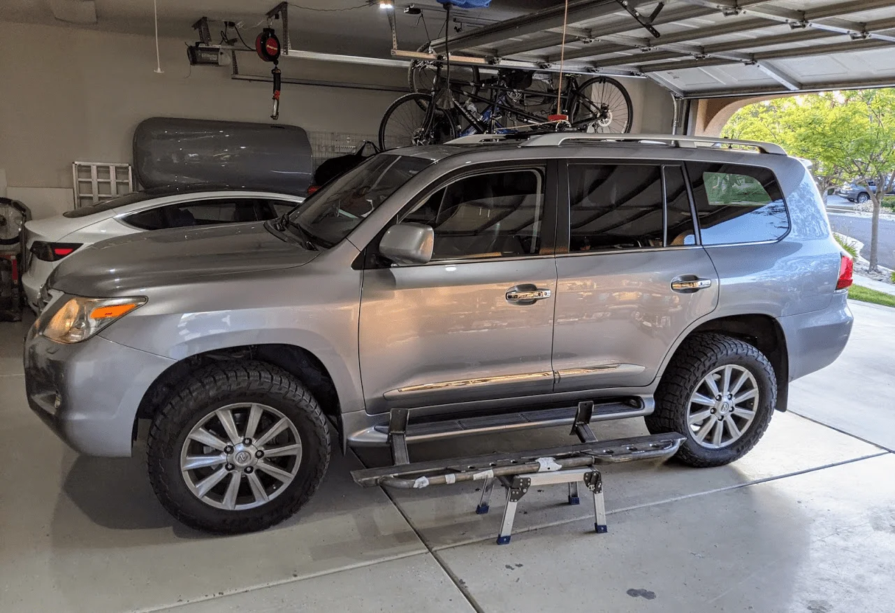

Grinchy already says no. But here is a pic of ARB Summit on passenger side just in case:
a44f32de-0a08-4128-9491-cbe481a5590a-jpeg.2306369
Thx. Not a great picture with the stock AHC protection rails in place. Definitely a lot on along the frame rails in general.

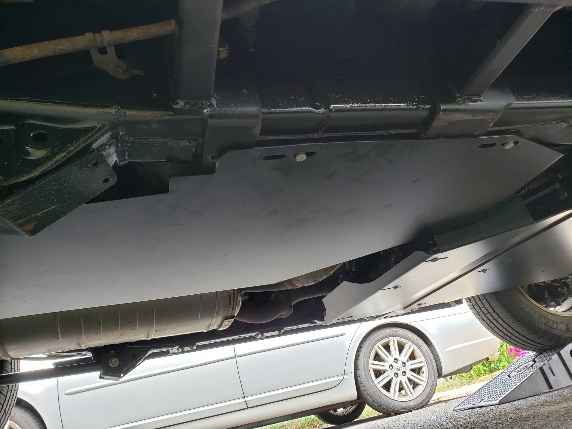

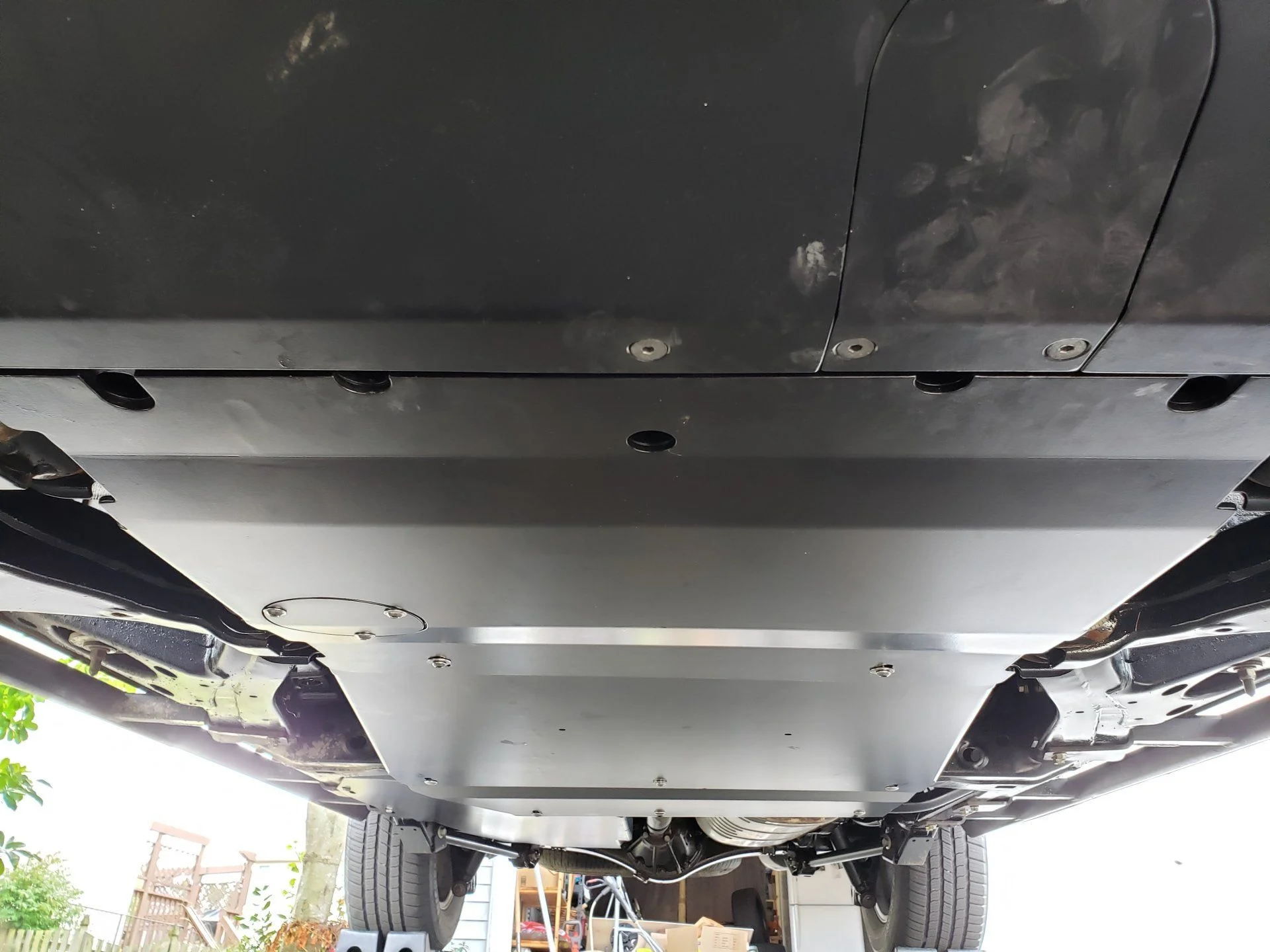

Here's some pictures of them before I put them on, and underside pics I took from my skid install that shows the brackets. Hopefully they're helpful.

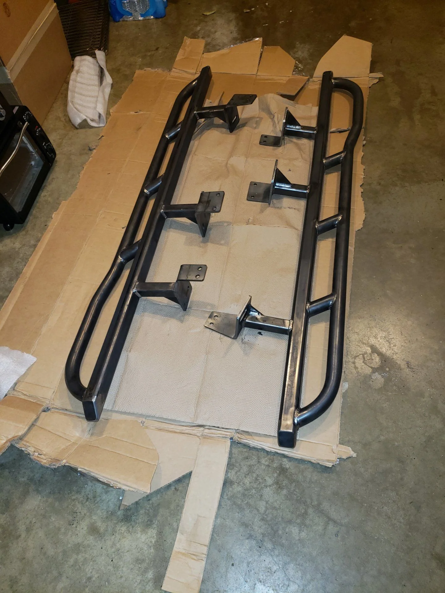

These are 100-series Metaltech/OPOR unfinished sliders for a bit over $600.
Can't say I am not tempted to re-work these 100-series sliders. 80 series, 100, and 200 all have the same wheelbase so it's likely the visible parts of the sliders could be adapted. The feet, especially against the AHC components, is likely far more work than meets the eye.

I've done cardboard tracing cutouts, looked up shear rates for m8 and m10 bolts, priced bracket raw material at the metal store, called every fab for 200s and some just plain fabs for advice and trying to talk them into creating a set for us. I bought a welder . . . I even started a "Let's group buy a slider thread for LXs". Remember the wait was 18 months between July and the year after December for Slee's supply . . . it was a long time to wander in the wilderness worried about rocker panels.
Can it be done - yes! Almost any of the sliders can have the existing bracket cut off or modified (or ordered without a bracket) and a new bracket set welded on. If you want it removable, then you have to trace, angle, and cut and prep all brackets with holes and make sure the feet fit etc. Pretty much only the Budbuilt version couldn't be adapted 'easily' If you weld to frame there is additional work to rust proof the frame after. I don't want to oversell the work, but there is a fair bit. . . if you have a full metal working setup it isn't a big deal, and you already did it, like Prime or MilliWilli.
