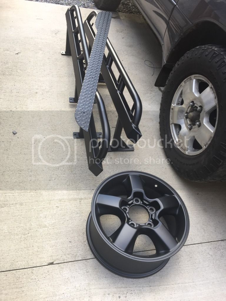

The underside is what I'm looking for, sorry about that.

So if you remove the plate you can see the tabs that are welded in to mount it to.

What the underside look like of the slider with the full top plate?
It is completely touching the rail all the way around the perimeter? And coated also?

The plate is one piece and does touch the tube all of the way around. I painted my plates top and bottom the same way as I coated my sliders. Industrial enamel primer and rattle can bedliner top coat. It's easy to touch up after hitting things and doesn't scuff off with normal daily use.
About the comment of going without the plates, the sets without plates don't have the mounting tabs welded on they are just smooth tube. Imho a set with the tabs and no plates would look very off, the tabs are easily noticeable without the plate there to cover them up.

Just finished painting mine, might put them on tonight. Just wanted to say, I needed to get them on a deadline, since I am having surgery next week. After surgery, I will be off lifting stuff for a while. I explained and asked John if he could expedite, and he was happy to accommodate me. Great guy, super fast work, high quality product with beautiful welding. Looking forward to scraping some paint off of them, will post pictures when they are on.

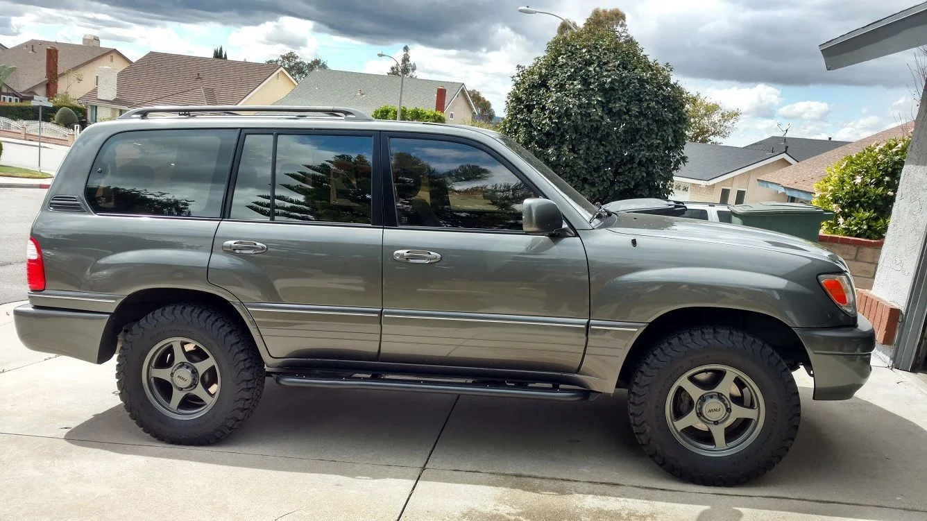

@trdcorolla thanks for the pics! The 10 degree angle looks pretty optimal for being a step and maintaining clearance. Now that you have them installed, would you have ordered it any differently?
