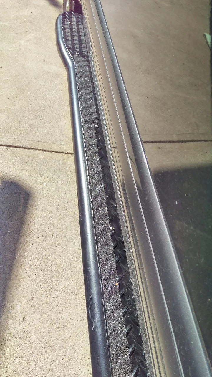

I've got white knuckle sliders with full top metal plate. I plan on removing the top plate once the kids are older. I also have a 4 year old boy and he can get in and out of truck without any help. I did add some 3M grip tape.
Note that mine have their standard angle upwards but you can order then flat too. I kept the angle, mostly for aesthetics. But even with the upwards angle the but still steps on then easily.

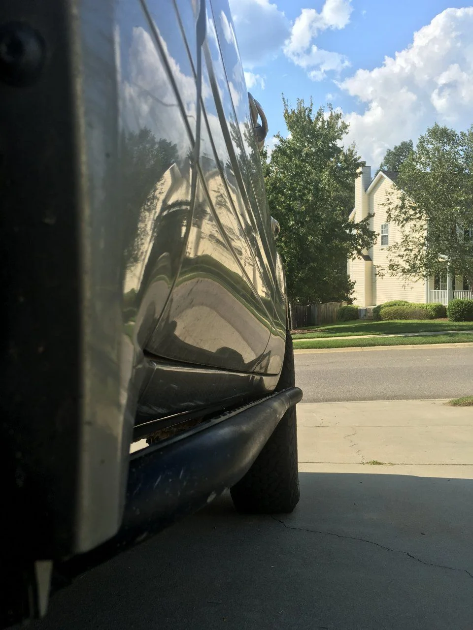

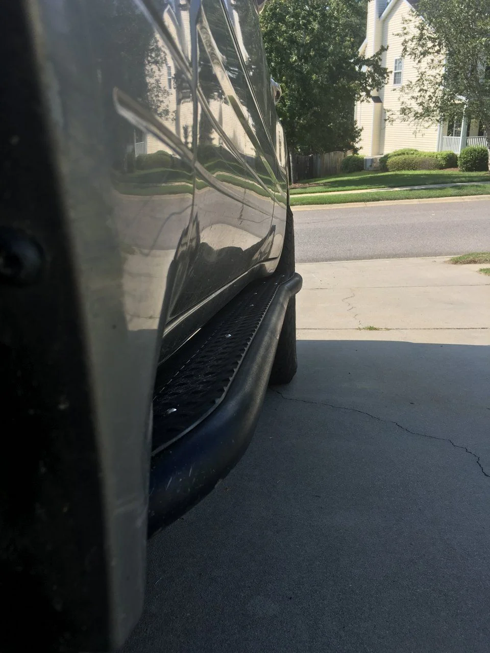

I have the white knuckle sliders with full top plate also. I have 2" lift and a 4 year old son. He can barely climb in the truck on his own. Since I don't off-road anywhere near as much or as hard core as I daily drive, I really wish I had went with the 0* upturn instead of the 15* that they come with standard.
Even with the upturn there's still a lot of slider to step on, it's just a good solid 2" higher on the outer most portion. Here are some pics looking down the side of my truck:

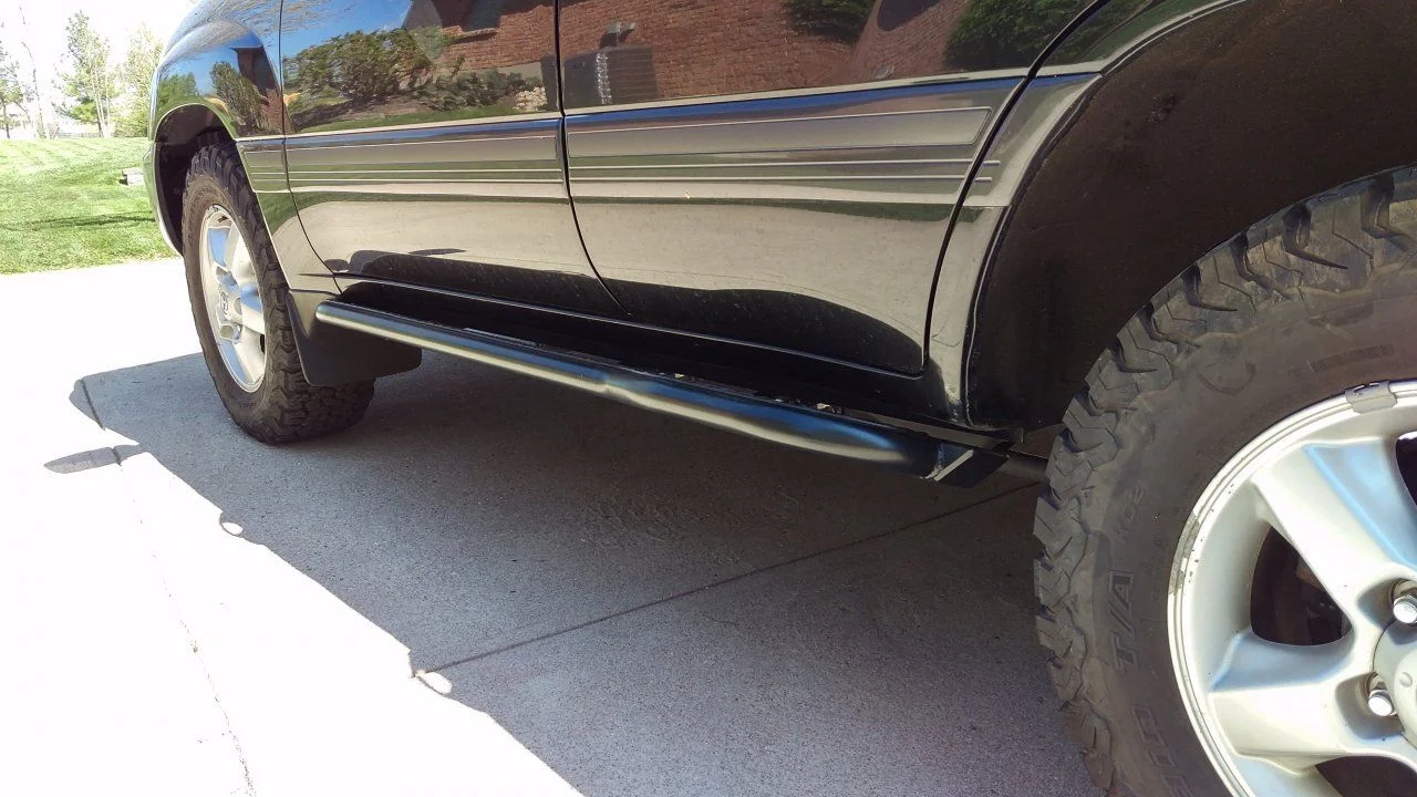

In the old Sur America was really typical for the ''engeniers'' to let a mule trace the path of less resistance on really step mountain roads..
To me this sliders are perfect.
But the ones on this posting are a second close, I like the logic about them, nicely done

What pictures are you looking for? You can see how the top plate is attached in several of the above pictures. See the silver bolt heads? The top plate is just screwed on. You can also see a shot where both slider and front mud flap are installed. Without the front flap the slider would do a decent job of protecting the rocker panels.

You can't see what you need in all the pictures above? There are like 6 or 7 allen head bolts that hold the top plate down. The top plate lays on top of the slider and is bolted on to it.

see above pics of ihadmail's its the same exact thing. the top plates are installed with several small screws to tabs welded underneath, and are 1 piece of metal per side.. the protection for the body from stuff the front tires kick up are the main reason I went with the top plates they do a great job
