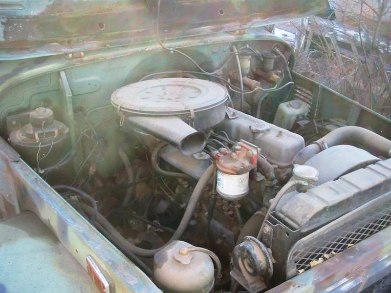

Well I don't have any hoses for the intake...hmmm...
here's my intake setup...I have seen this on another HJ45 with the H diesel so I'm going to assume it's factory? :confused:

Let's see that photo again without the air cleaner in place.
You will probably find that there are two hoses that run from a butterfly ('throttle body') to the pump/governor assembly.
Take that photo, and we can go from there.

The H and 2H are pretty quiet when tuned to stock settings and a manifold gasket leak or a leak at the governor housing could certainly be heard. The two plastic lines that go to the governor can also break down and crack. Take a good careful look in that area; a small mirror may help you see the underside of the manifold if there is a leak there.
I'd expect that your engine would not be running very efficiently if there was a good sized leak to/at the governor.

Here is a pic of then engine with the air cleaner off. I noticed that one had a crack...;p so I pulled it off...when I grabbed the other, (towards the rear of the engine) the bolt was loose, pretty loose, holding it to the injection pump. My guess is that, that was causing more issues than the small crack in the hose. Getting new hose today.
