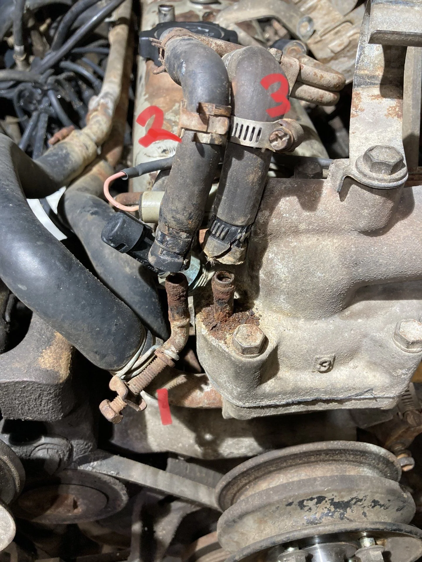

Replacing all hoses on 89 FJ62. Any opinions? #3 seems to have been really tight on the hose but still looks like it has been leaking and causing rust. Thanks for the input. Kinda boring poll. Sry.
My vote is for #1. I redid hoses 6 months ago and used those hoop clamps with success. Sourced from city racer in bulk if I remember.

Constant tension clamps (#2) are the best from my experience. #3 is just garbage, #1 can too easily cut into or crease the hoses if you aren't careful. The only real caveat to #2 is that it's best to not reuse them as they can lose their spring tension over time and heat/cool cycles.

I would get replacements that are the same style as the old ones. They’re available from city racer. I replaced all my hoses and clamps a few years ago and used #3 and I wish I hadnt. I have some small leaks I have to keep my eye on. Do yourself a favor and go with OEM whenever possible.
In the background you can see the OEM clamp at the other end of hose #1. It looks like a pin type and I’m trying to find what is best to replace these as well as I’m pretty certain they are a one shot type clamp.

You can still get those clamps. They’re good clamps. But you gotta destroy them to replace them.
You could also look at stainless ABA clamps. They look like number 3, but the thread grooves don't go all the way through so they are smooth on the inside. Plus they have a couple different widths so they work well on some of the smaller hoses. I'll try to grab a picture of mine installed.

I think that is an Oetiker-style clamp. It has different stops such that it can be used over a range of tube OD. There is a special crimp plierd used to tighten them up.
I don't disagree those might have been installed at the factory, but that style does not show in the parts diagram. For that location it shows clamps are the same on both ends and that the spring clamp is used (your #2).

I used some of the rust proof stainless clamps for heater hoses but those all (x8) leaked and when tightened break or snap open so replaced with normal iron.
The non adjustable nr 2 when RE-used with new radiator hose (more proof to never reuse?) , it popped off three times, just before a 5000 km trip.
I tried not to fully squeeze it open, and maybe the new hose was smaller in diameter?

1 is OE
2 is similar to OE but doesn’t look OE
They’re both used in various spots on the cooling system and available new. I wouldn’t reuse the #2 type.
avoid 3 if you can.

What is wrong with #3?
I know its not OEM, but I have been using them for the last 40 years and have never had a leak I could attribute to the clamp.
they work and I've certainly used my fair share of them but they can be overtightened and tend to damage the hose over time.
